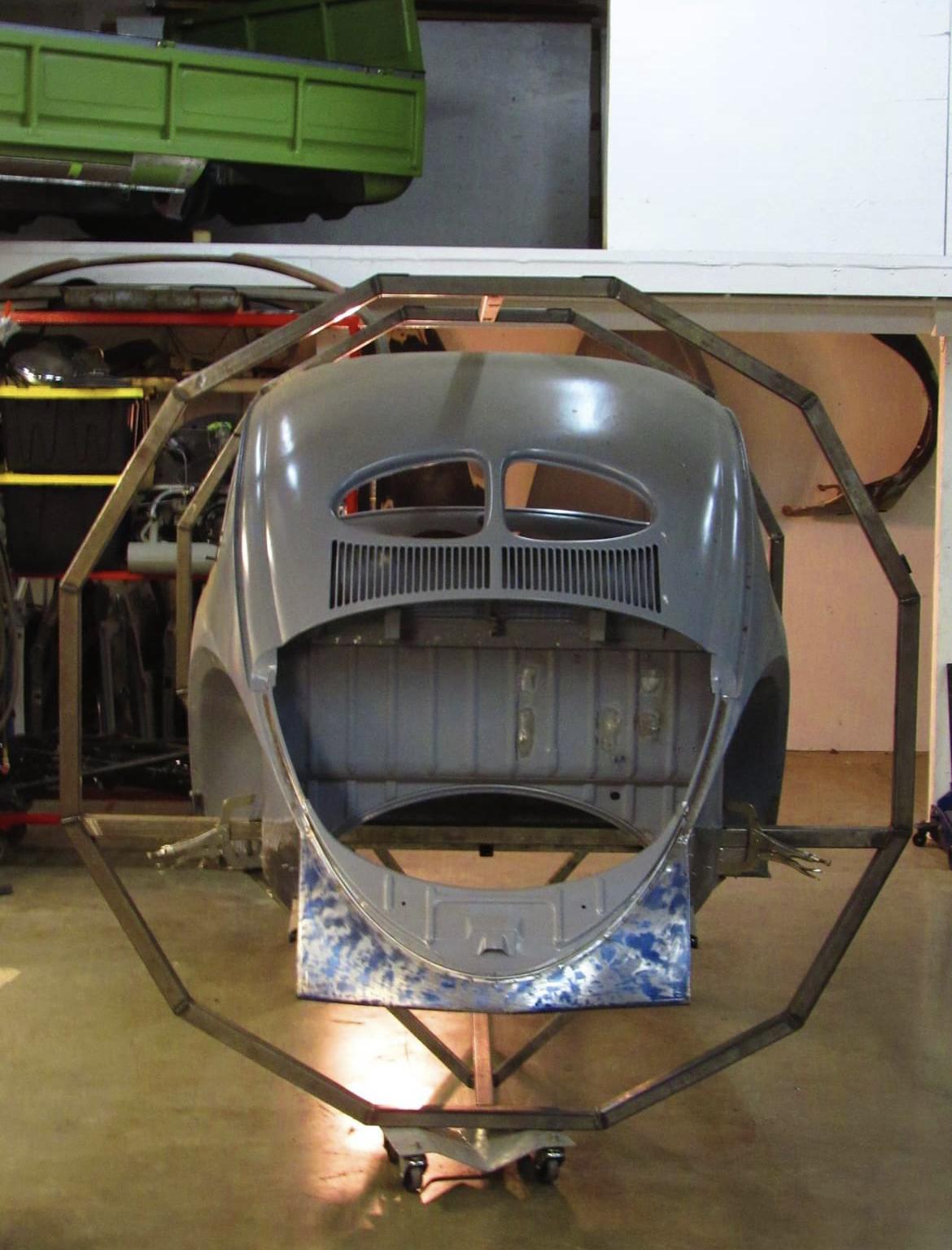

I'm guessing you fabricated the body frame that allows the body to tilt down incrementally. Would you mind sharing the general fabrication measurements. It seems like it works well and has an element of simplicity. Thanks Andy
Hey there. So this is the original design I used and the just made it somewhat smaller
This is a dodecagon , a 12 sided paragon.
Fun to build really.
The one I’m using is one complete hoop the I cut in half.
Here is the link to measurements to get you started
https://www.thesamba.com/vw/forum/viewtopic.php?t=175412
I too was inspired by that thread and the dodecagon design for my Ghia build. If you follow that link from Mr Wren then scroll to page 2 there's the dimensions I worked out for the same idea to fit my Ghia. I also made it smaller than the Bus version. There's a photo of my Ghia in the frame. I would recommend bracing along the centre line so frame rock too much and doesn't stress the mounting points. The brace can be a small section of tubing from the frame to any existing bolt hole on the body.

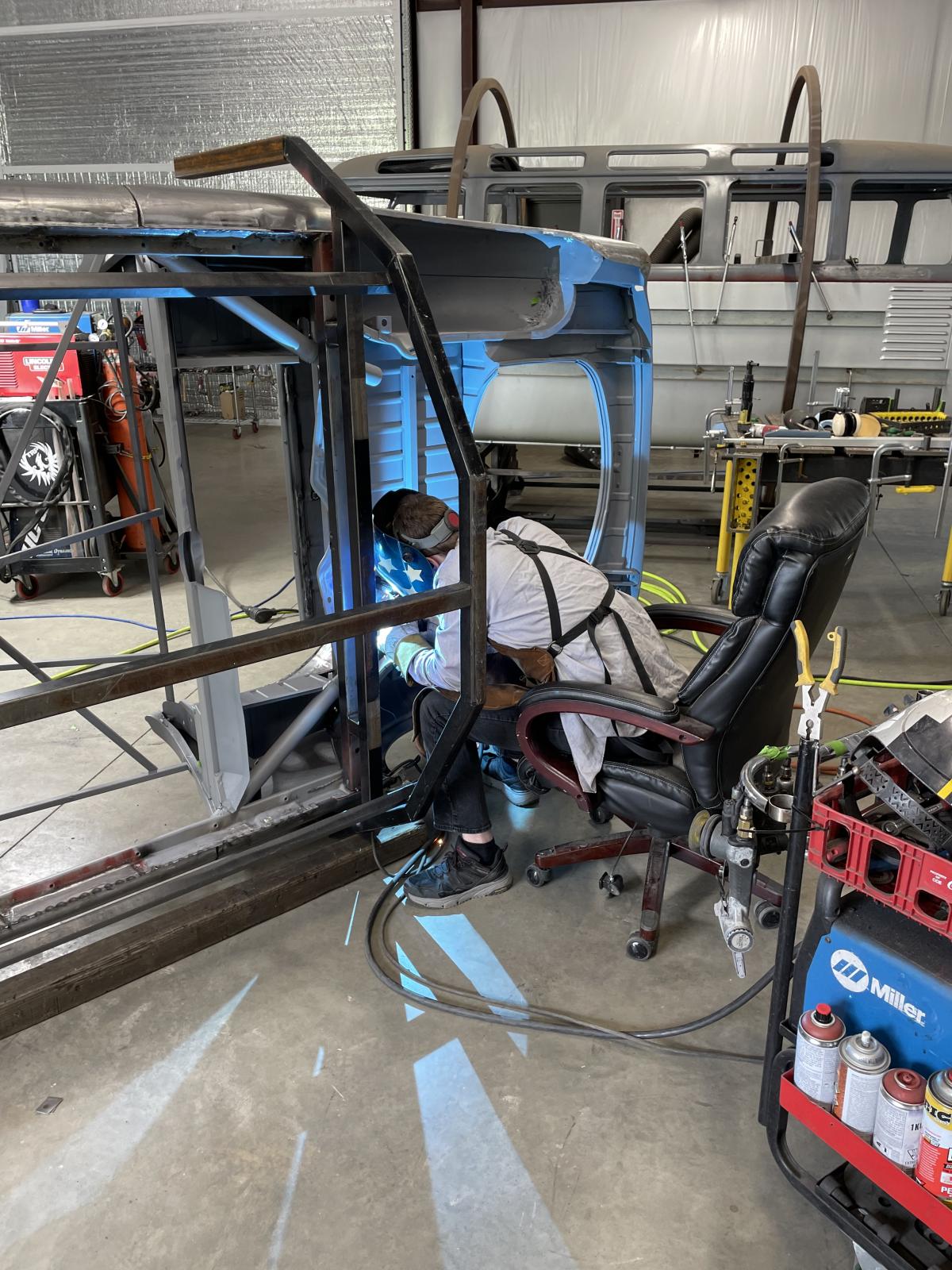

PostPosted: Thu Apr 18, 2024 3:00 pm    Post subject: Re: 59 Karmann Kab Reply with quote

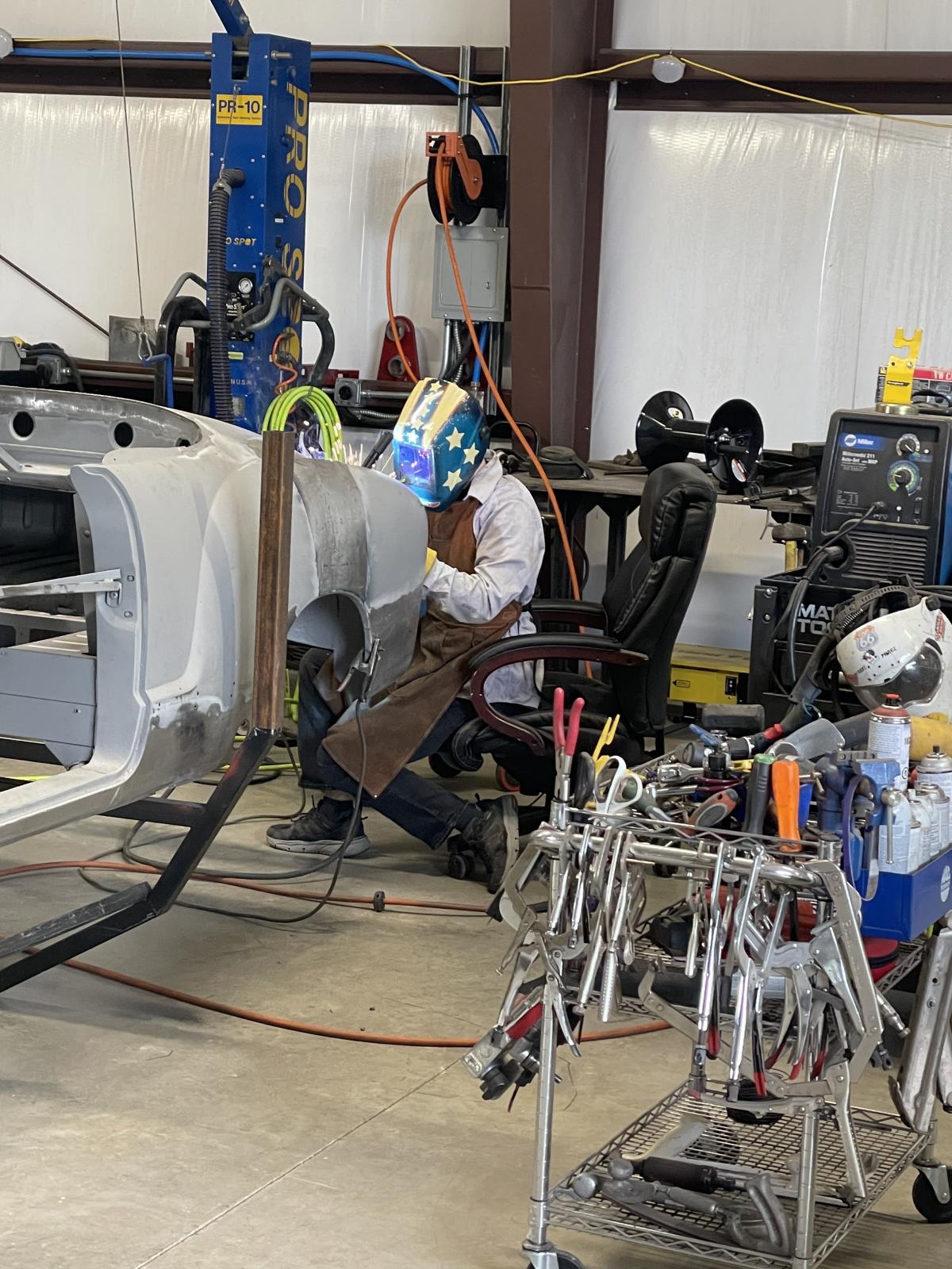

My Son, Chasing down a ton of small tasks.
βš’ Believe In The Power Of Positive Thinking βš’
Purpose Over Pleasure πŸ•Š
β€œHard Werk βš’ God First β€œ

sputnick60
Joined: July 22, 2007
Posts: 4136
Location: In Molinya Orbit
sputnick60 is offline
PostPosted: Thu Apr 18, 2024 11:01 pm    Post subject: Re: 59 Karmann Kab Reply with quote
Nuh ... I don't see no rust Laughing
Nice work, the pair of you!
Nicholas
'66 Karmann Ghia Cabriolet...
'65 Porsche 356C Coupe...

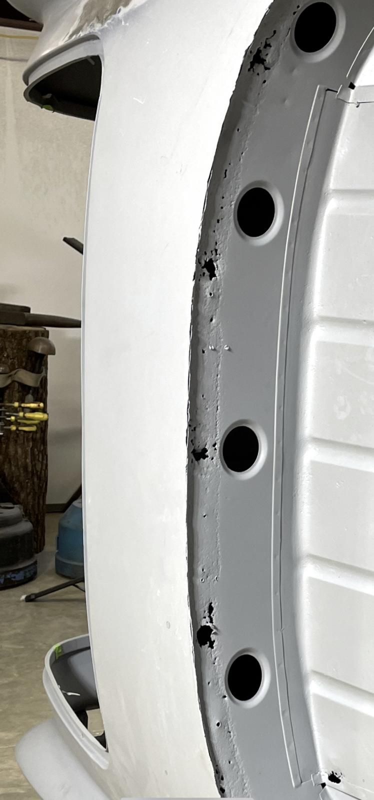

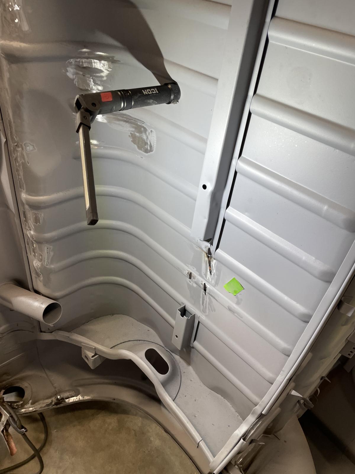

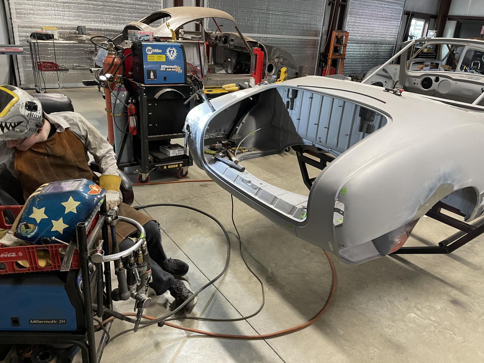

WrennMetallWerks
Joined: December 06, 2007
Posts: 3400
Location: Rescue ca
WrennMetallWerks is offline
PostPosted: Thu Apr 18, 2024 11:52 pm    Post subject: Re: 59 Karmann Kab Reply with quote
⬆️⬆️⬆️ Thanks Brother ⬆️⬆️⬆️

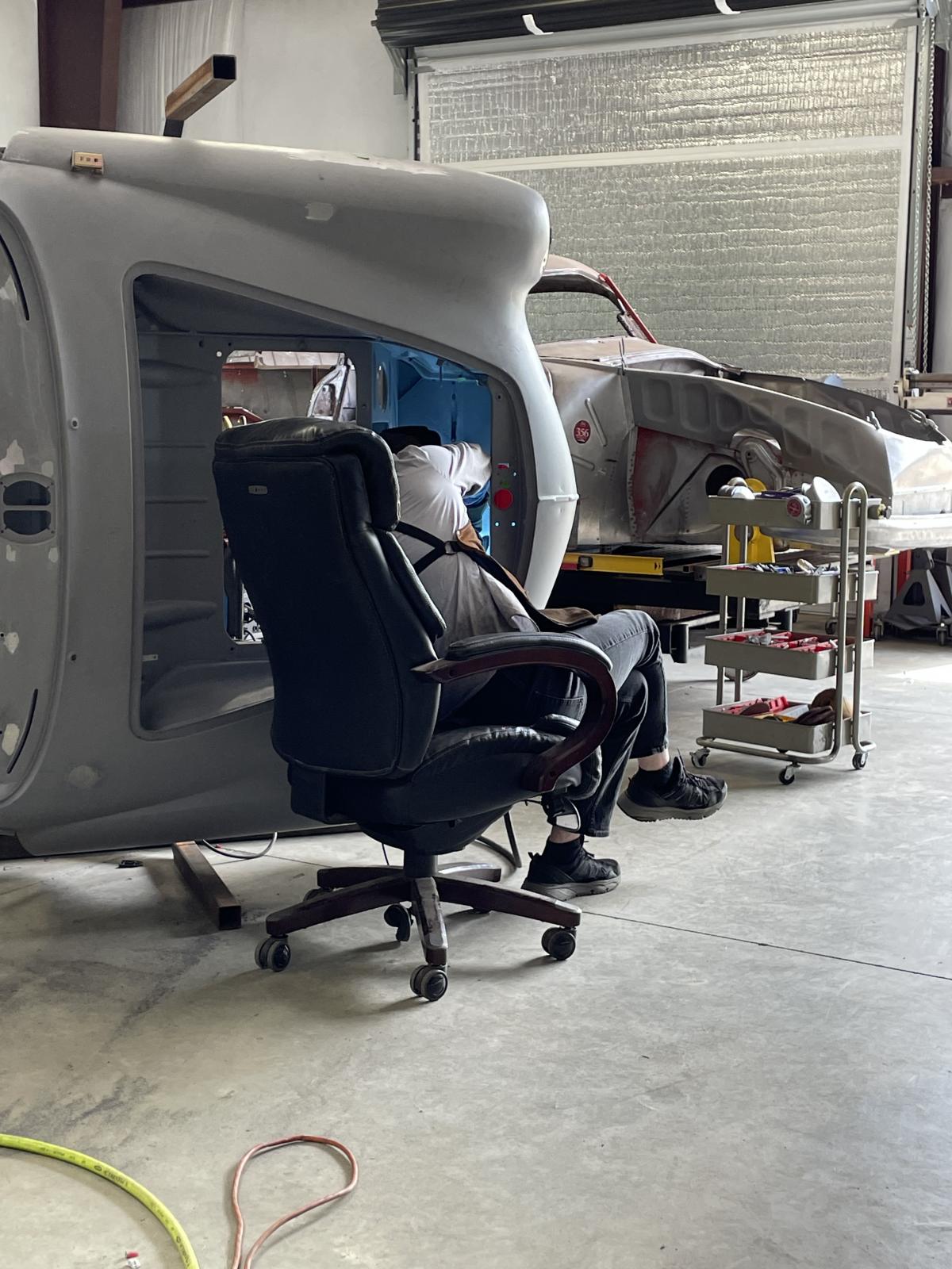

Christian has been painstakingly going over lots of random rust spots. I’m just showing the major ones. 👊
It is a dream come true to werk with my Son. He has great Goals for life so I don’t know how long he will stick around but I’m enjoying every minute of it while I can. ⚒☑️🤍
