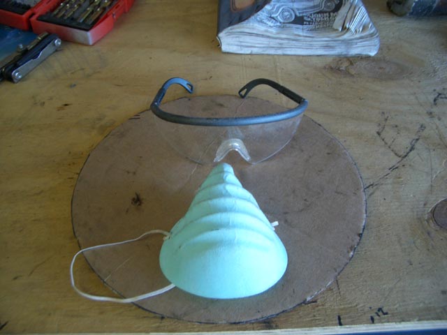

First, get yourself some eye protection and something to prevent you from inhaling the dust you're gona create during the grinding. I used these two.

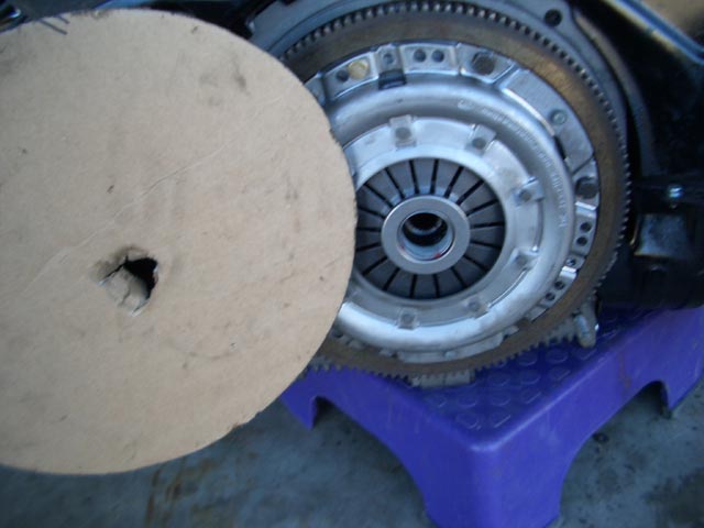

I made a template of the 12 Volt flywheel out of cardboard. This makes it a lot easier than having to keep removing the engine and taking off a little bit more at a time.
This is what i do with the templete to check clearence.

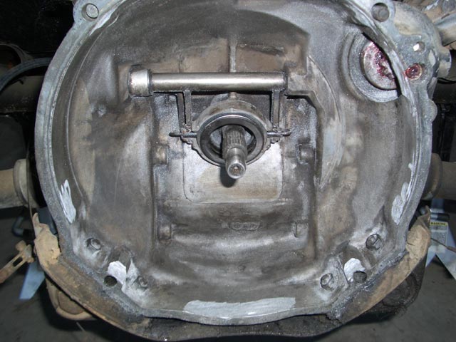

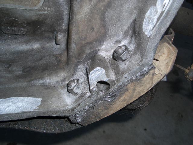

You have to grind the area around the mounting bolts, but be careful not to cut into the bolt tunnel.
There are a few other areas to grind down besides the bolt areas. Here are a few, but check with your particular flywheel or templete.

I did, i took another measurement of the flywheel and engine. I had to go in about 1 1/2 inch at least. The pictures are just to point out some of the places the grinding will be performed at. I wonder if the transmission mount bolts will rub the flywheel. Any idea? I'd hate to chew up a flywheel on those bolts.
