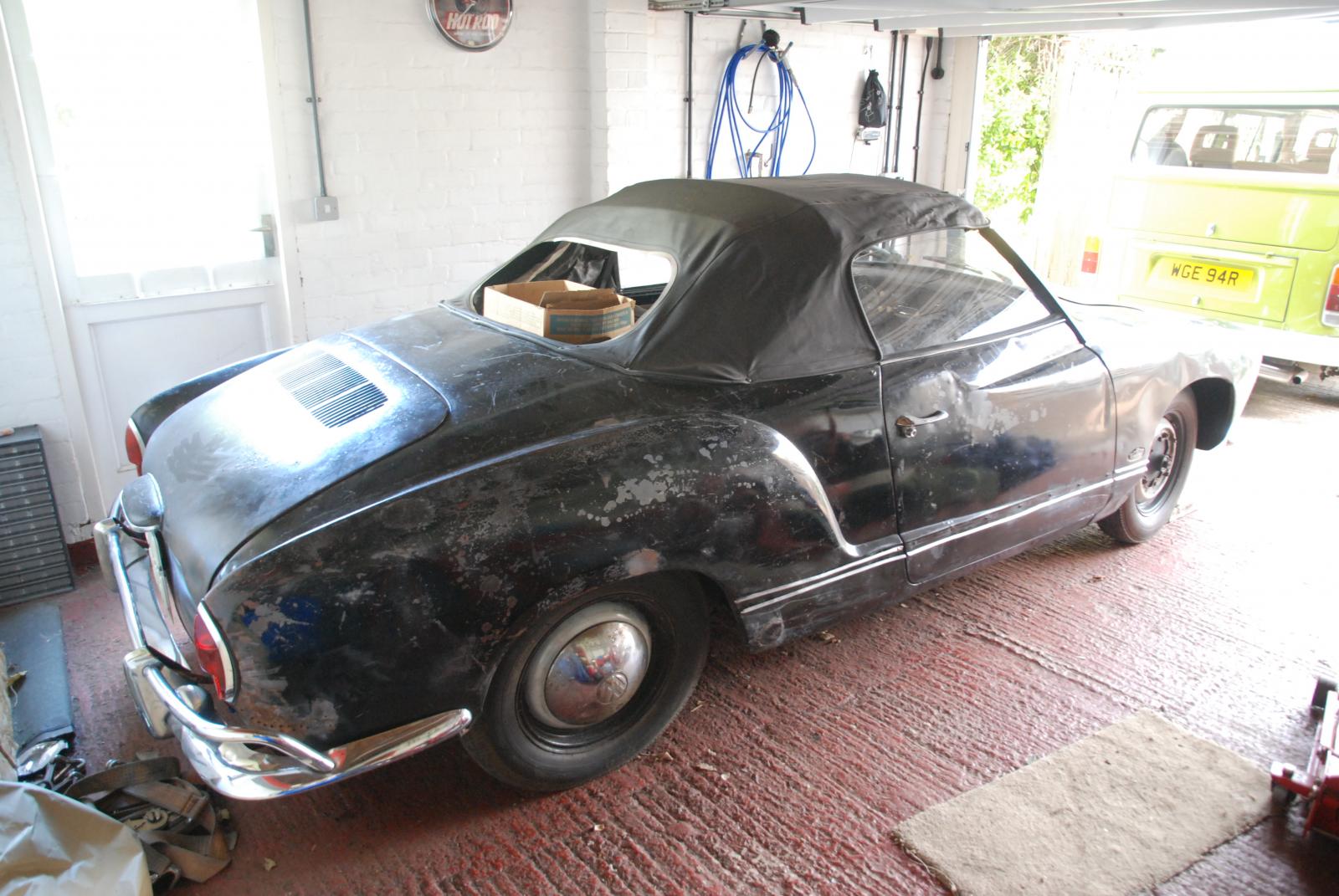

Early convertibles are very thin on the ground in the UK, so when this one turned up I had to take a look. On the plus side it was a black '61 with a red interior and new floorpans. On the negative side was pretty much everything else!
All the trim parts were either missing, replaced with later parts or so damaged as to be unusable. The hood had been replaced with a cheap outer which had a couple of holes in and no rear window. It was running a cheap narrowed beam, had some poor repairs to the heater channels and lower wings, didn't have its original engine or box and had plenty of rust as well as dents on EVERY panel.
A friend who is an amazing metal worker looked it over with me and said it didn't scare him, so I did a deal where I would drive it home but then bring the 1600 engine back, as I didn't want it. The car made it home, but shed various bits of trim along the way. The driver's door also fitted so badly you couldn't close it from inside, even using the shed door handle someone had fitted for the job:

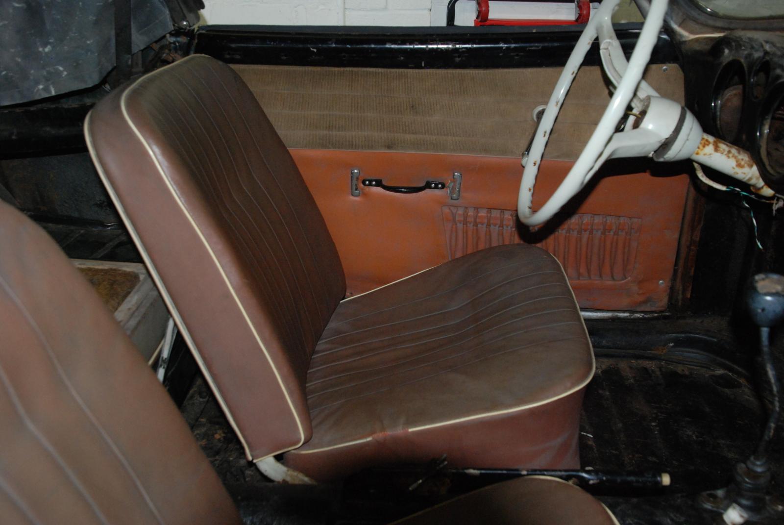

The eagle-eyed among you will have spotted that the door panel is wrong, being from an early lowlight, with a corduroy top section. The rear seat was probably from the same car, as it was a cut down saloon seat, cut entirely on one side so the cut out for the chassis spine wasn't even in the middle!

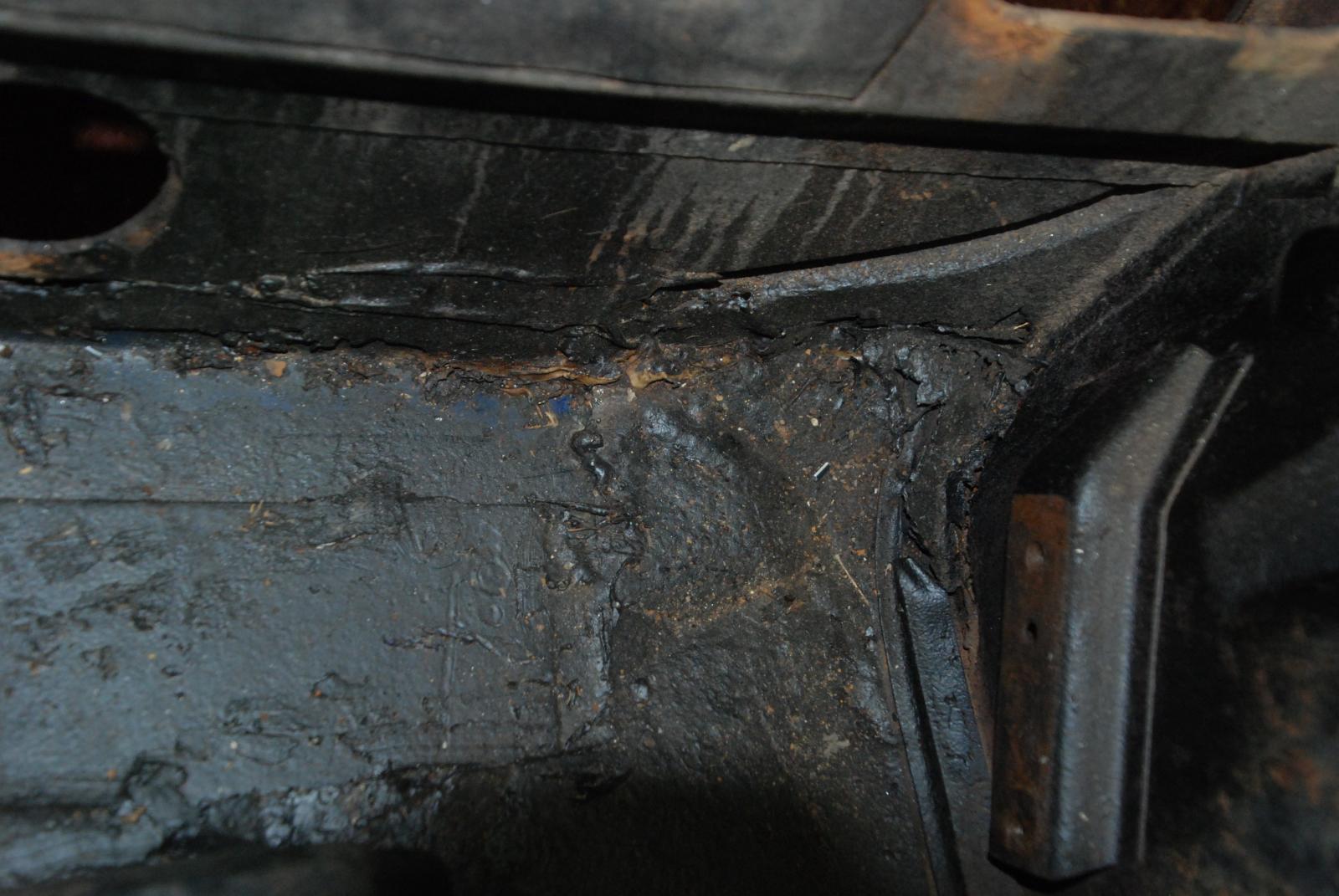

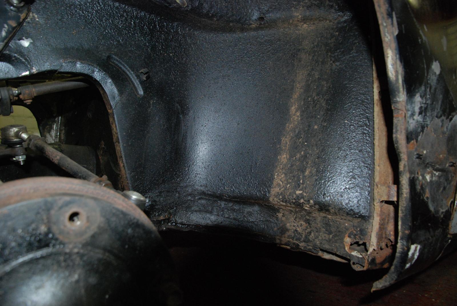

Once home I started probing the body to see how bad it really was:
Holed inner wing
Nose damage
Horrible spare wheel well repair
Grot in the corners

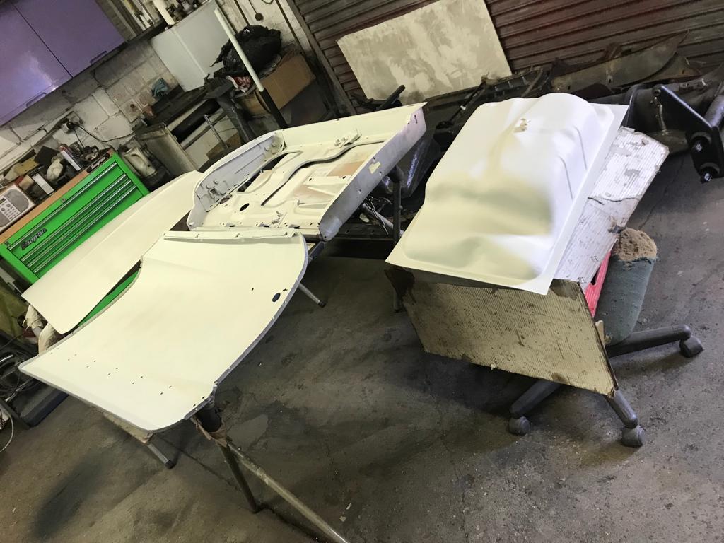

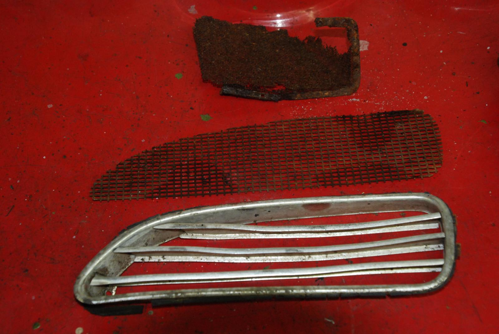

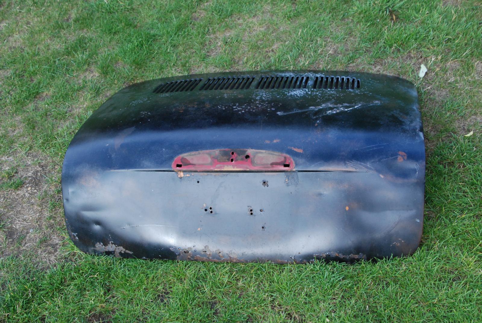

The engine lid was very rusty and dented. I made a bit of a controversial decision here. A supplier in the UK had a NOS late model decklid. Wrong for the car, yes, but you would only know when the engine lid was open and the engine is not going to be stock, so that hardly matters.
Looking at the gaps for airflow around the early metal rain trays and the later plastic ones, I also feel the later ones are likely to flow more air. That would be in line with all the other models, like bay windows where the air vents got bigger. So as I am going to be running a 2110cc engine, better airflow is a positive. The old engine lid got sold on and the NOS one arrived.
Another item that came with the car that I wouldn't need was the petrol tank: a nasty repro one with a cut away section for a fuel flap filler pipe and a horrible little cap.

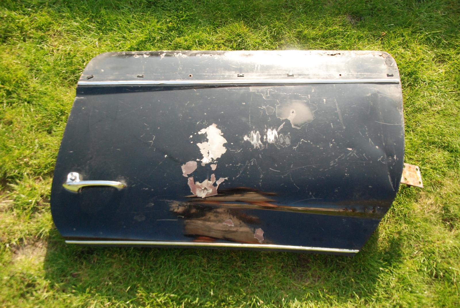

The doors were both rotted out and dented. One was repairable, the other a bit far gone:

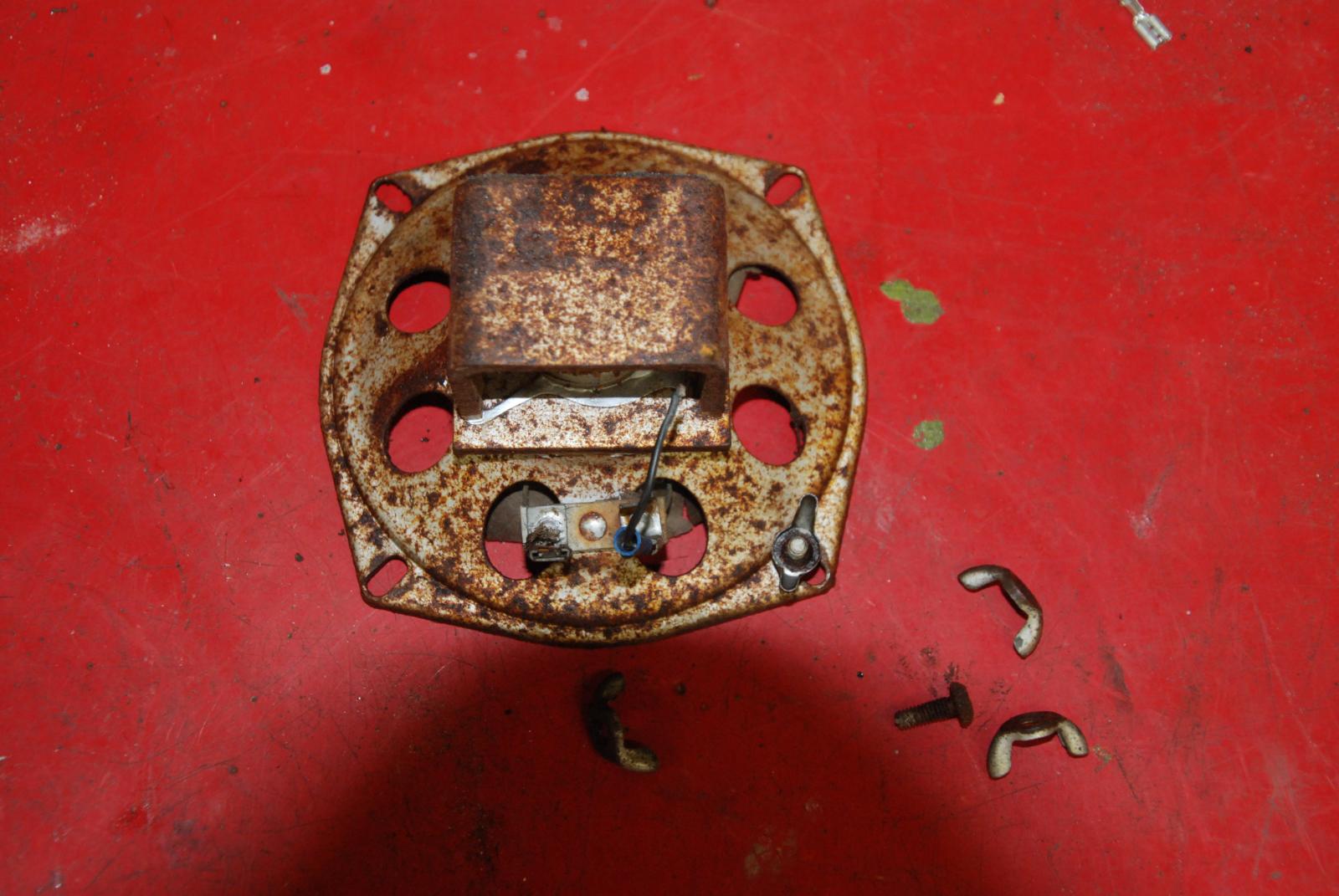

Very little from the dash was useable:
Under dash dome light was toast
Speaker was toast

Speaker grill was cracked:
The dash top was also cracked and crumbling, while all the gauges had rust inside and on the rims.

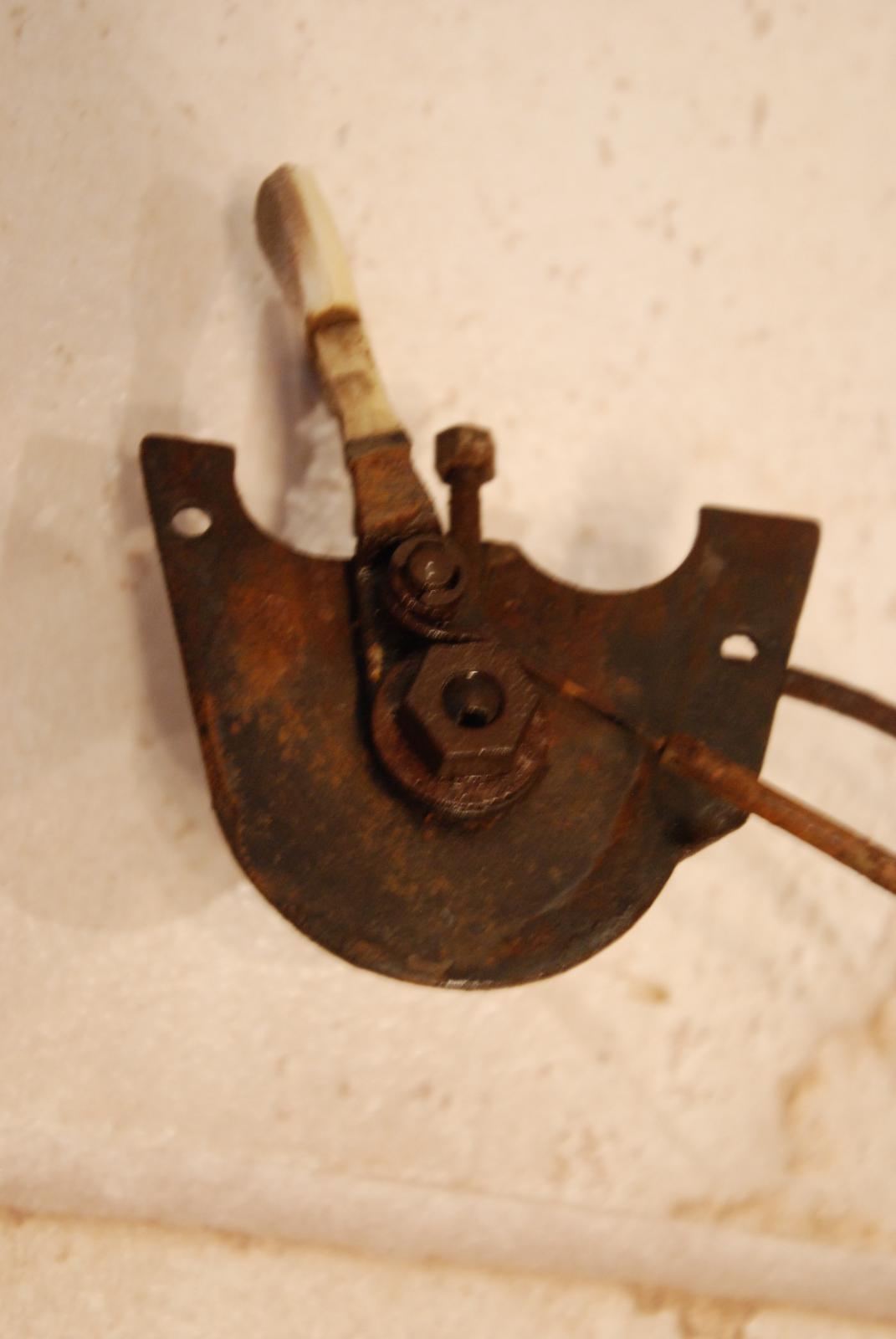

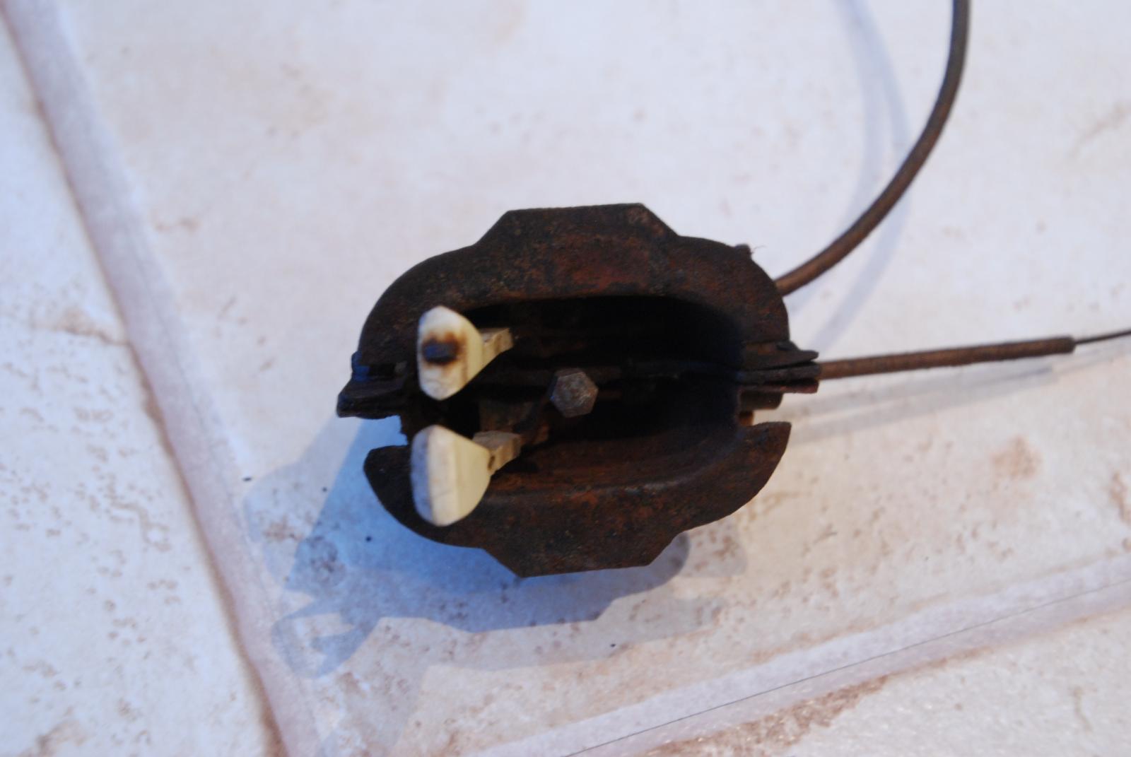

Where original parts were restoreable, I did them as they came off. That way when the car is ready to be re-assembled, everything comes out of the box ready to go back on.

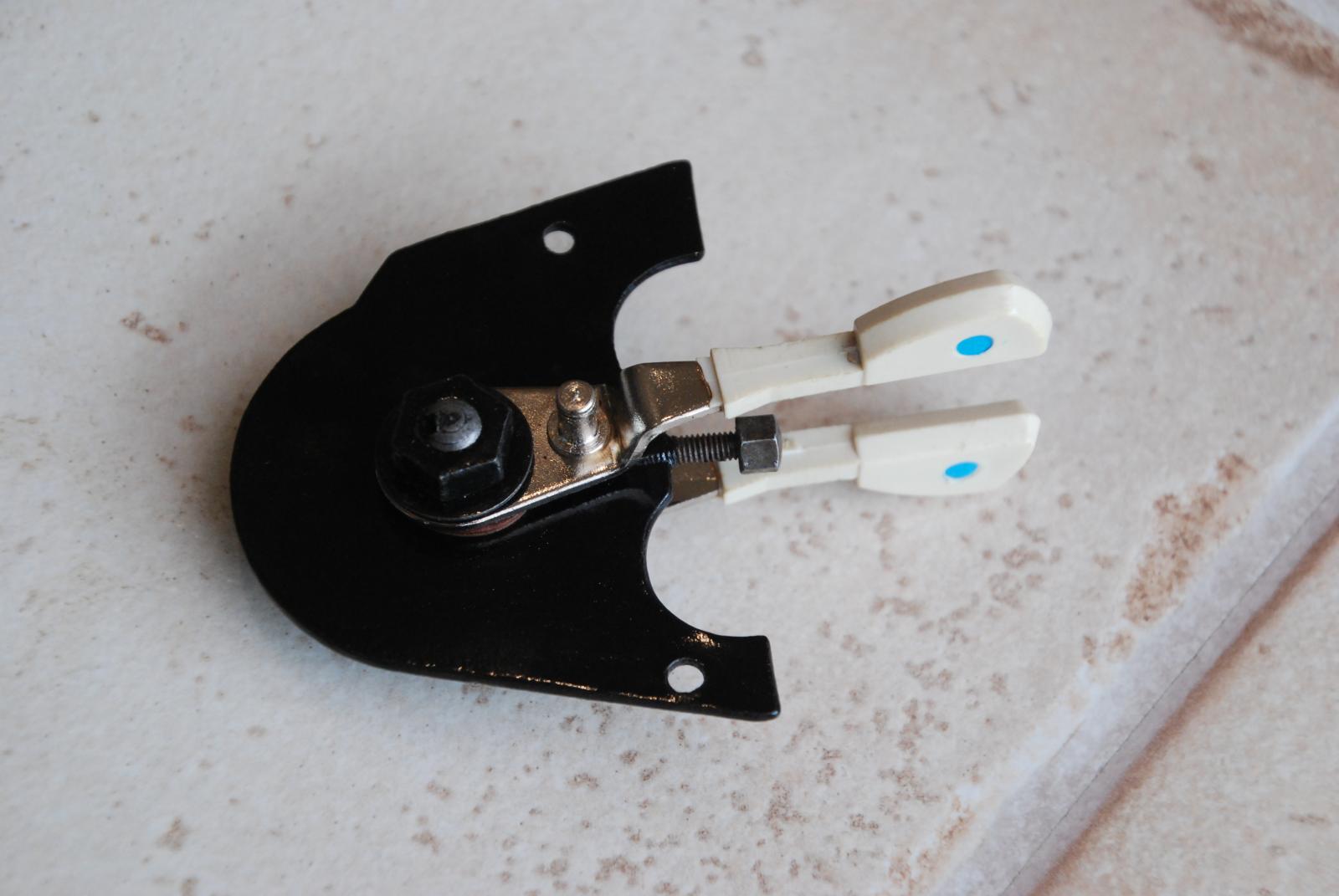

I dismantled the heater controls, cleaned them up and repainted them. New levers were needed, but all the hardware came up fine:
The outer casing halves were blasted and epoxy primed, then put aside to be painted L41 in due course. The guide tubes for the cables were cleaned up and painted bronze, rather than actually copper plating them.

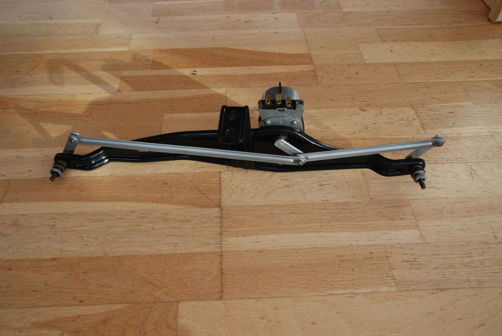

The wiper assembly came apart and was blasted. The main frame was powder coated, the control arms I painted at home. It had already been fitted with a 12v armature which worked well, so I just cleaned it all and polished up the original SWF aluminium cover.
Before:
After:

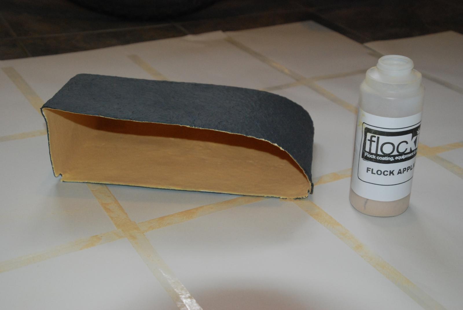

Another part of the dashboard that was saveable was the glovebox. It was crumpled and had small tears, but it's only papier mache!
To get it back to shape, I wet it to soften it, then straightened out the creases with an iron:
It then sat on the radiator with heavy books in it to stop it sagging while it dried:
To solve the tears, I made up some paier mache out of chopped toilet rolls and PVA glue:
Then I painted the outside and inside in acrylic paints in colours I mixed to try to match the originals:
Finally, with help from my younger son (it takes two as the glue dries really quickly, so one to brush the glue, the other manning the puffer) I flocked the inside with the closest colour i could find to what was left of the original:
It's not perfect, but it beats a plastic repro glovebox.

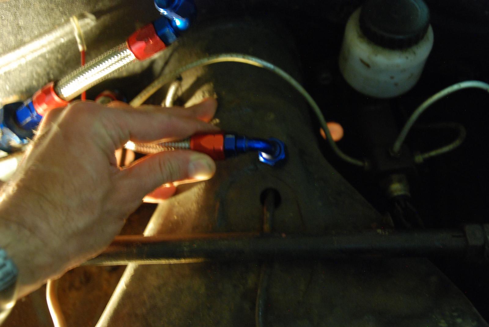

Before bodywork could begin, I wanted to do a full mechanical fit up to ensure everything worked and fitted round each other.

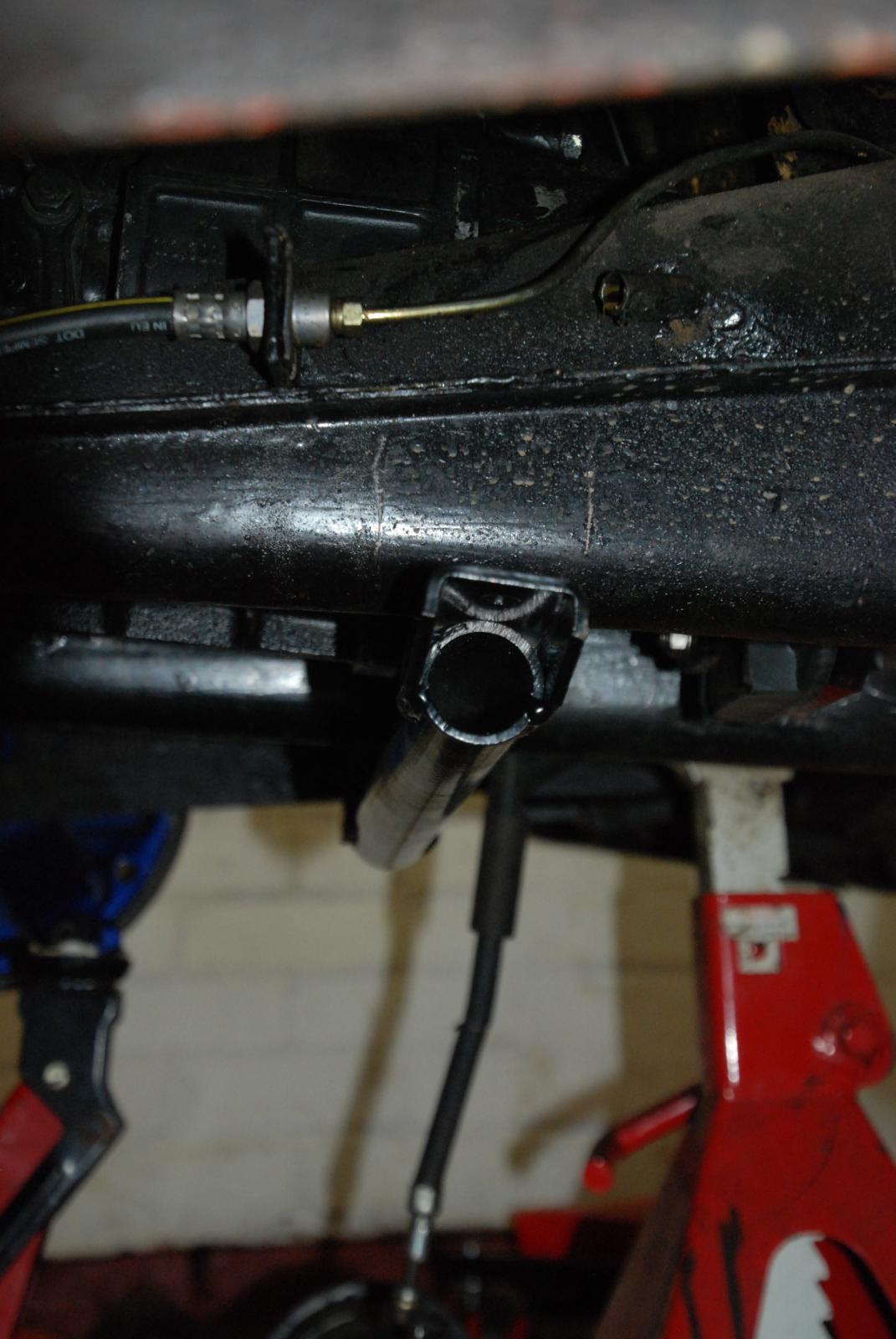

The car had a replacement fuel pipe run through the cabin by the brake line, so I needed to run a new pipe through the tunnel. That would have to wait until the body was off.
As I will be running a high performance engine and had a lot of quality plumbing left over from the race car I decided to use AN fittings throughout, with an electric Facet pump underneath the tank by the framehead, along with a filter:
I won't use such bright hoses in the engine bay, but they make sense underneath because they are easier to see on a black car if I need to disconnect any and the braided hosing offer protection underneath that isn't needed in the engine bay.
As for the tank itself, I bought a reasonable looking original tank, but after blasting it didn't look good enough. This is a bit out of time order now, but someone later found me this oddity - quite a solid tank but with the neck cut off for a buggy project.
So the neck from the bad tank was sliced off and welded to the better tank, which meant I could position it so the VW logo on the cap faces exactly forwards. Oh well, it makes me happy! A 4AN breather outlet was also welded to the neck - I am sure I had a photo of that, but can't find it at the moment. The tank was then blasted and epoxy primed. I sealed the inside with a POR kit for good measure. I did it 15 years ago on my Beetle and it hasn't caused any issues since.
This was later on:

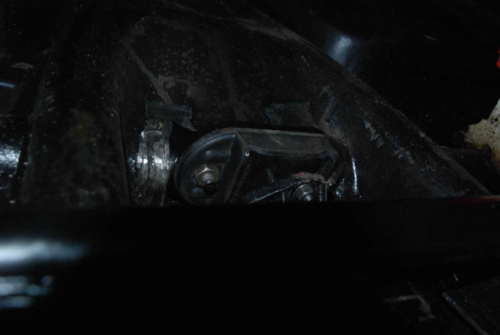

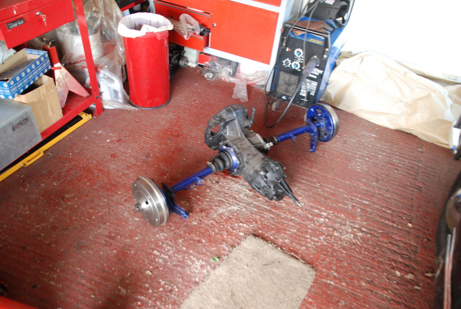

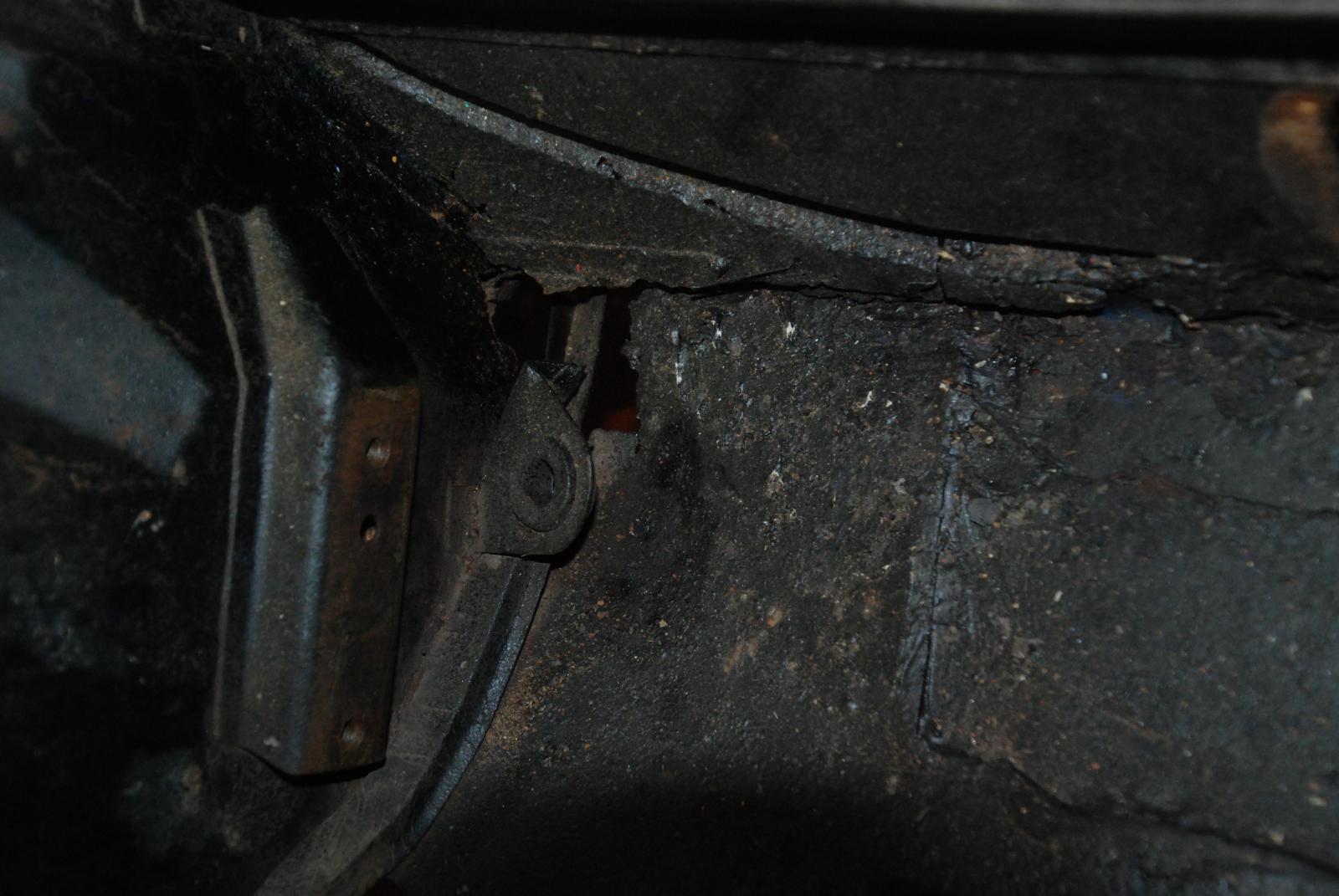

The next step was to get the rear end mechanicals fitted, starting with this:
This was the box from my drag buggy, which had plenty of good parts in it, including SAW short axles, a modified super beetle mainshaft, steel shift forks, a superdiff and heavy duty sideplate. The close ration 3rd and 4th would need to be changes, but then it was always going to need a check over after so much action:
It didn't go in easily though. On my first trial fit it sat too far towards the back of the car. I checked all the geometry and measured everything, but there was on sign of damage or twisting to the chassis. In the end I cut the nose mount off and trimmed it a little before welding it back on, which cured the problem.
I am using Rhino mounts from CB, which I hope will reduce movement without transferring too much engine noise into the car. I wanted to fit a mid mount with rubber mounts, but this fought me too, the one I bought sitting too high so the metal touched the forks.
In the end I cut it across the middle and added a section to get it to sit at the right height before welding it back together again.
