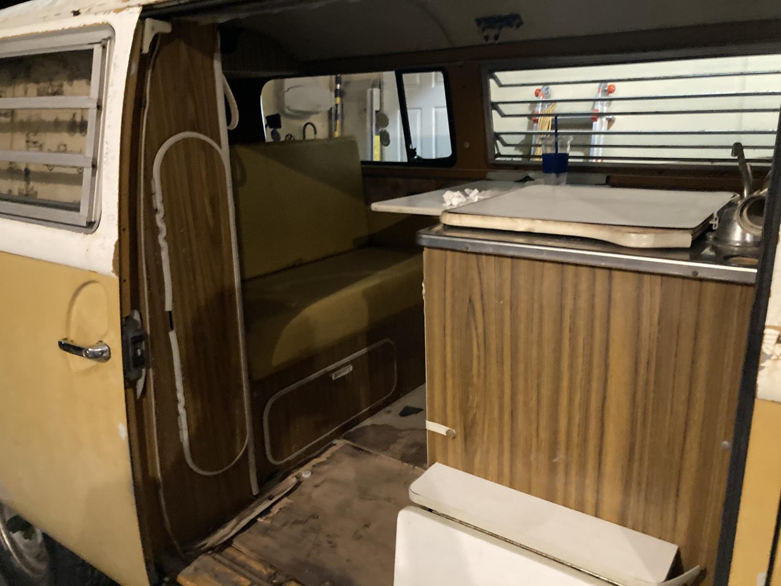

Okay, enough blabbering, picture time!

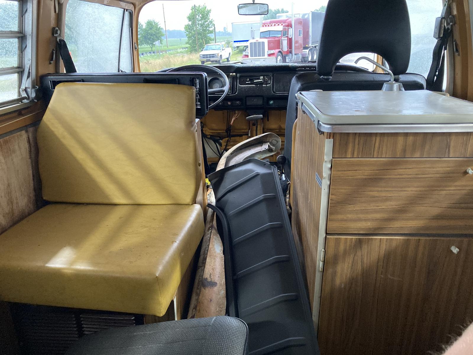

Some of the interior. The Ac unit under the buddy seat, is that dealer installed? I have only seen one picture of one and the manual for it.
Some type of toy gun in the head banger.

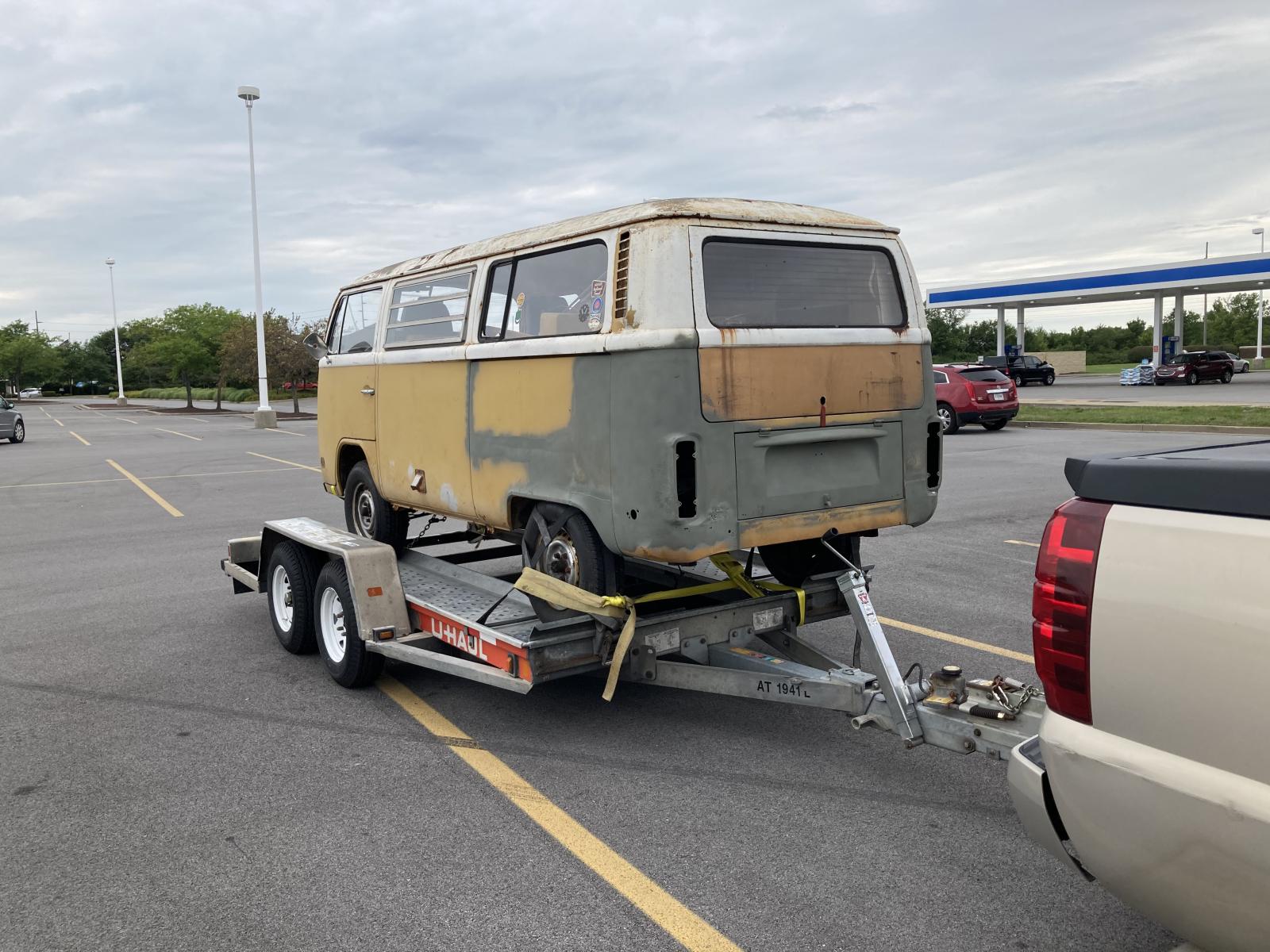

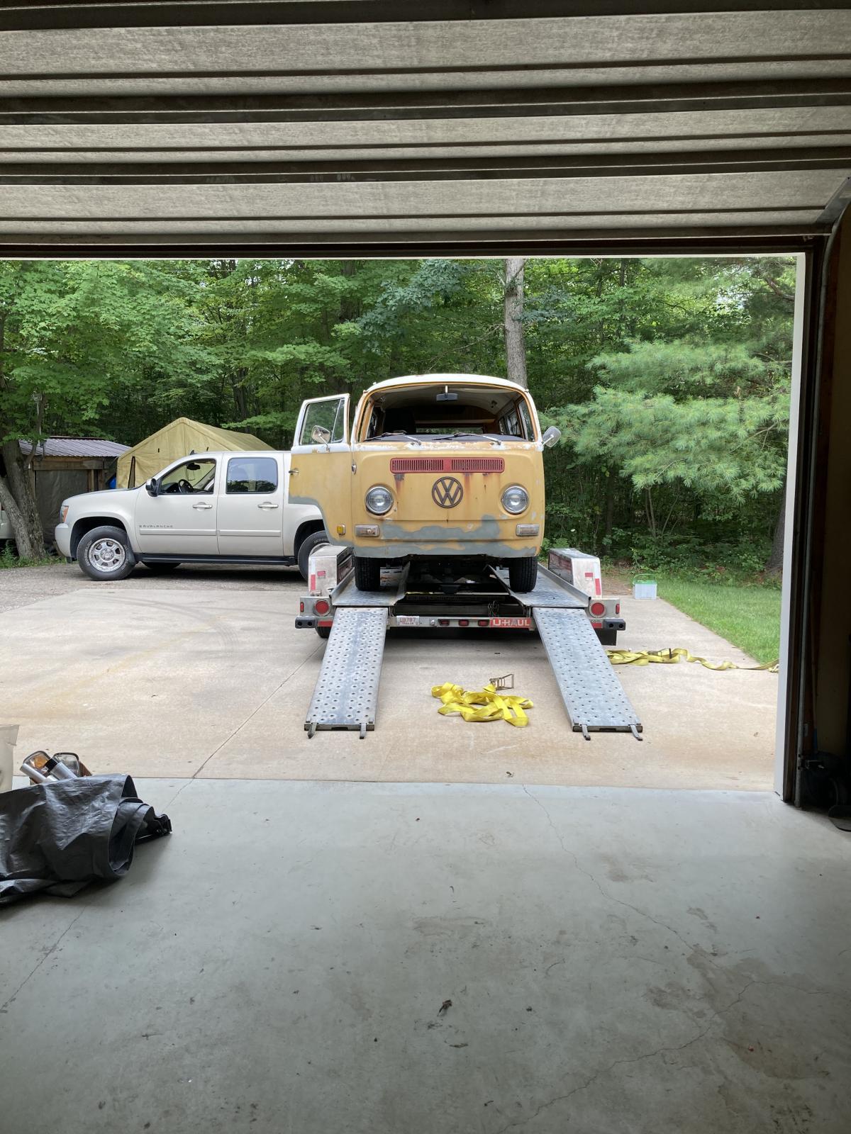

Here are some pictures from the morning, the one really bad pic is the bus and a Carvana car vending machine in the background, the other is the nesquick bunny
I decoded the M-plate. It seems to be a very early 72, started production on it in July. What is “USA, East reserve” for destination?
More pics
It’s been raining all morning, we are roaming the bus backwards since there is no windshield installed. A lot of the car was blasted, where the primer is, and some of it’s formed rust. Some of the engine compartment was bare metal and has rusted since yesterday due to rain. I brought spray paint but forgot to put some on the bare metal Embarassed
It will probably be a few weeks or month before I start working on it, as I have other projects to finish. Once I get home today I will probably clean and inventory everything.

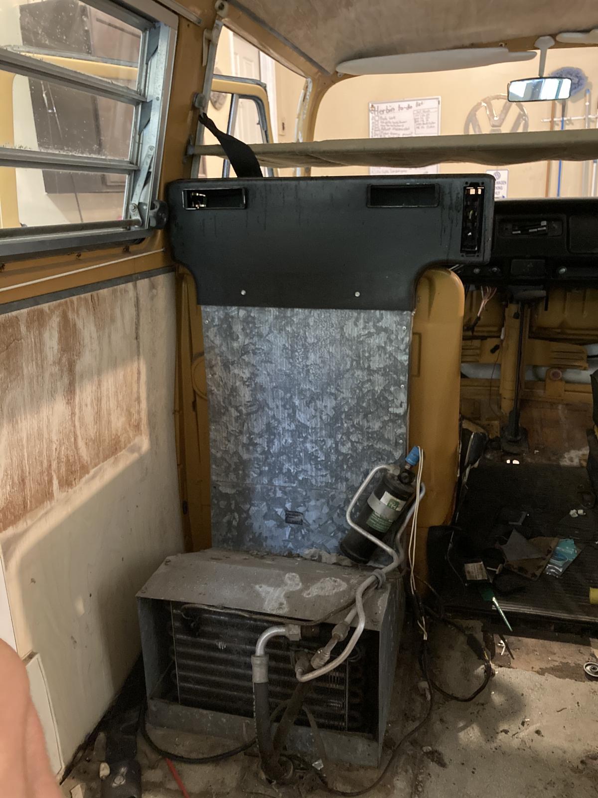

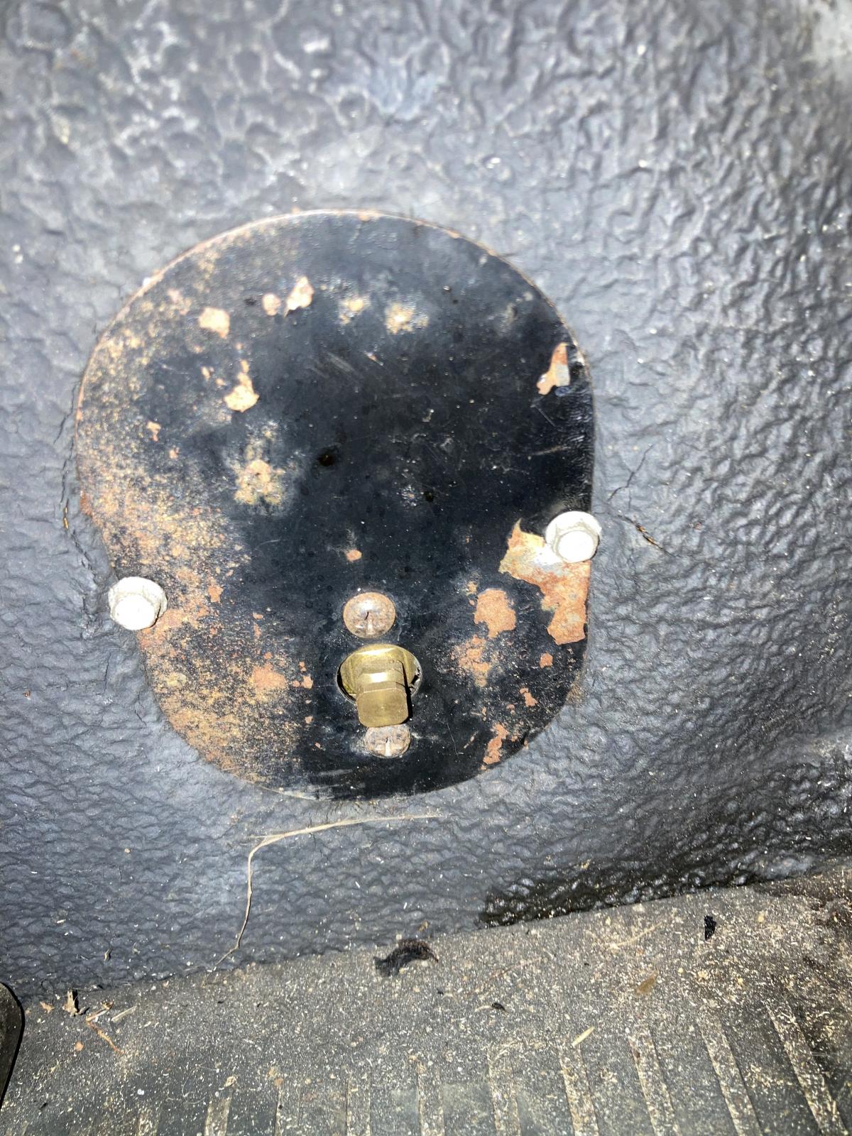

So, the last day or so I cleaned up the interior and it’s all in pretty good shape. The only peeling laminate is on the sink cover fold out. The rest is all perfect still. The vinyl is in pretty good shape too. I took out the jump seat AC unit for now, that will be one of the last projects.
Yesterday I went to adjust the emergency brake and noticed there was a gap between the axle nut and the hub and the nut was hitting the splines. So I realized that’s not good and took it apart, turns out the stub axle is from a 68-70 bus and is too long so I have to go get a new one from the junk yard.
The front floor needs some patching, the front vent let a ton of water in, rusted the front vents through and let water go onto the floor and rust it out. Someone had fiberglass repaired it so I ripped that out.
I think the rear corner are so bad because there was an engine fire at some point and I’m guessing it didn’t get painted inside and cause the metal to rust out bad.
So far, it’s pretty cool this is the 447 bus made in the 72 year, I would have to imagine it’s about the earliest 72 tin top Westy left.
So I think I’ve figured out the history on this bus a bit. So the OG owner bought it new and only drove it in the summer time camping. It seems they like the UP as there was red clay on the bottom of the bus and a bottle opener from a U.P. Then one day it had the engine fire which scorched a bunch of paint so then it got a respray to cover it. At some point it looks like the rear quarter was hit and then they started doing body work but it may not of been painted, then it sat outside for years and was overgrown based on the fact that there are grape vines that had attached to the rear vents and the antenna. Then this VW guy from Wisconsin ended up with and and blasted some of it and blasted off the bondo, I’m guessing he put the fiberglass in the front floors. He had it in a barn. I’m pretty sure he passed and then it sat. So, the guy I bought it from had a friend that flys planes and is into VWs and he was flying and saw this field of VWs. Eventually they go knock on the door and there is and older lady that lives there and she said they were all for sale. Mine was in one of the barns but I guess there were a ton outside. So the last PO bought it and took it back with a couple other busses from there to Indianapolis and he started doing some work on it but ran out of rooms so he put it up for sale and I got it. Now it’s made it’s way back to Michigan again.
Here are some pics of the Jump seat AC, I will get some more of the bus posted.

Interesting, dont think Ive seen a "jumpseat AC unit" before.

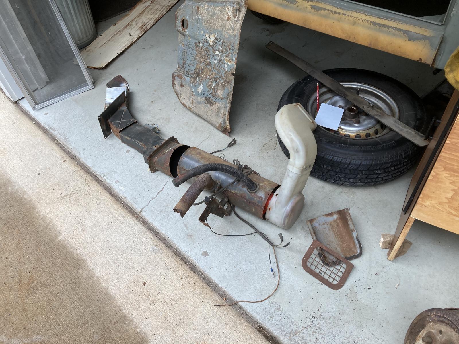

What a day! I went to the junk yard and scored big time, I had gone out to look for the complete engine from the 412, all the way in the the very back corner was the bus it was in. I looked in the back and I saw a little grill cover and I thought, is there actually a gas heater back there, well, I throw open the engine hatch and the sits a complete BN4 gas heater and all the parts! Shocked I about had a heart attack out of excitement Laughing I have been wanted one if I got a bus and didn’t expect to find one, but it’s amazing. I got my stub axel, gas door, skid plate ( though I think it’s later), fresh air vent pieces, sink vent cover, water tank fill pipe and cap, a computer for my Squareback (can you have to many? Very Happy ), a few other parts, and the accelerator pedal, wow, was it hard to find a decent one and bracket, most all of them were rotted out.

Well done!, I don't see the temp control cable for the heater, out of photo?

how were the hornets? nice score! i saw that heater before, but my ride is a summer queen. a little fall too, but no need for a heater.

Sweet score on the BN4 Cool Laughing
I know the feeling. Plans for it? Restore and run it? You know 1972 was the first year they ran this later type. Perfect for your bus.

Well... I saw the cable in there but I didn’t know where it went so I left it d'oh! I know found that it sits under the drivers seat. I also left the outside air intake pipe as it was rusted, next time I go back I may get it. I also need the cover for it and the dash knob.
No hornets today, Tons of fly, when you went in the trailers they were in there buzzing around like something dead was in there. I won’t be driving it in when they have salt on the roads but the extra heat will be nice, thanks for not taking it I guess Laughing
Thanks! I have the gas heater obsession too Laughing I’ve just been messing with South Wind/Stewart Warner gas heater because they are cheap and plentiful here Very Happy I will be restoring it for sure! I’m definitely thinking of running it. No, I didn’t know 72 was the first year for this style. I’ve checked out your gas heater threads. This is the dealer installed style heater which made it a ton easier to get out. The heater doesn’t look too horrible, the salt didn’t completely destroy it. So it has the passenger bus air duct, I’m thinking, would anyone be interested in a trade for a westy one? Laughing Gas heaters are just fun little projects to get going, it will probably be far down the line before I get to this gem.

Finding a complete BN4 heater with all the accessories ranks among my best junk yard scores ever, especially when I found the switch with the timer that goes on the dash. It was an absolute game changer for making my bus comfortable and extending my driving season much longer than before. Once I understood how they worked, I found it easy to maintain and service. There are newer heaters available but the BN4 installed as the factory did is probably the cleanest and most efficient use of space even today.

I have one of those jump seat a/c units also. I took I out of a battered 72 Westy that I bought in Gurnee, Il, in 1985. The A/c unit only fits the Westys with that jump seat, but I am pretty sure only for the ones with the higher backed jump seat(72-73 only?). I liked it because it solves the problem of under dash access with a/c. But I think it is an inefficient use of space under the, and I think the ducting could be optimized. I have yet to complete the install of a/c in my 73, but there is a sticky here about doing so that is a must read(I think it is by Bala, and called something like" Installing DPD air conditioner in bay window bus".
All a/c s for that period were aftermarket, and there was some sort of tie in with VWOA and at least one a/c manufacturer, the afore mentioned DPD. In later years, and before factory air in about 1986 they had some sort of assembly line in fort worth where VWOA would ship the vans to have a/c added, so it was a semi factory air. Your van was much to early for that, and so it was probably dealer converted using the VWOA kit including that jump seat evaporator unit.

For sure, I would say it’s probably my best junkyard score, or tied with finding a roof rack for my Squareback. This may be a stupid question, but do you need the separate timer to the heater? Isn’t there a timer built into the switch? I would have to imagine that it helps, yeah, stock heat is good but I would have to imagine with the bus you start to lose a lot of heat the makes it to the from vents over all the distance. Gas heaters are nice from the amount of heat and they’re just fun to fix and a cool accessory.
It’s definitely nice having a junkyard like the one I go to that’s fairly close, a little over an hour away, the prices are a bit higher than just normal parts, but yesterday was only $130 which is still amazing. The reason it’s so expansive is that he’s a VW enthusiast so he buys them up, there are probably 15-20 busses, probably 5+ of them were 71 busses most panel busses converted to Sportsmobiles.

Interesting, let me know when you get yours done, I have mine out for now but would like to get it working, but it’s missing the evaporator, and a bunch of under side brackets for it were hacked apart. I might have to look for the sticky, I’m sure there are quite a few similarities.
There are a lot of VWOA accessories out there, it seemed they usually made a pretty basic car and let the dealers mess with accessories. I have the owners manual, it’s practically new, but there is no stamps writing or anything in it.

I realize that I don’t have many photos of the actual bus, so here you go
I put in the bug net and childs cot from the junkyard
The interior
