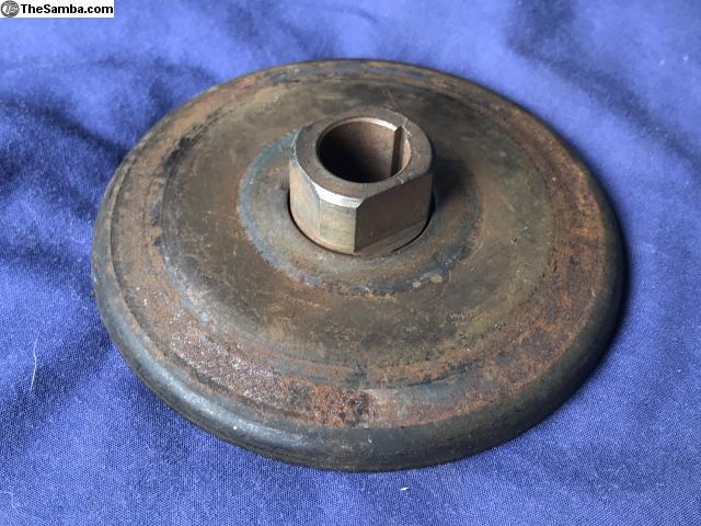

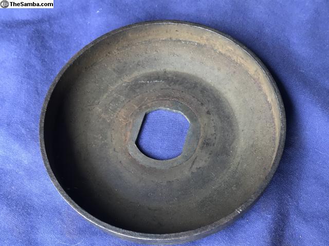

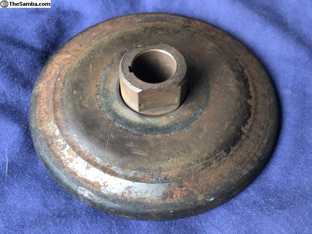

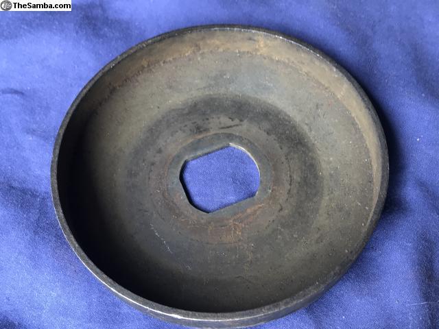

that pulley is garbage and should not be used any further. while the outside lip is pretty beat up, the more important thing is that the center opening is completely damaged. this wear is caused by the pulley not being tightened properly and the two halves of the pulley rubbing back and forth / flopping against each other over time. i'd also bet that there is a significant groove on the male hub section on the other half of the pulley. there is also fretting / friction wear where the special cap seats, and that's another thing that tells me that the pulley hasn't been tightened properly.
it is crucial to have the proper amount of shims on the pulley. if you don't have enough, this can cause the damage you have, because while you think you are tightening the pulley nut all the way, there will not be enough pressure holding the two halves together (again, causing the damage you have).
another thing to check is the special cap that the pulley nut tightens against. sometimes those will hit the generator shaft and you will get a 'false' sense that the pulley nut is tight when it isn't. again, this can be eliminated by having the correct number of pulley shims, and shims in good condition.
other things to check are the condition of the keyway slot in the generator shaft (key whould be a tight fit in it, no wiggle), the keyway slot in the male part of the pulley hub (no rocking of the pulley when installed on the key / shaft) , and the condition of the half-moon key itself (they can get worn if there is excessive pulley movement).
post some pics of the other part of the pulley and the special cap.
here are some pics of how the center part of the pulley and hub should look. notice the crisp lines, and the lack of marks on the male part of the inner pulley half hub section.
