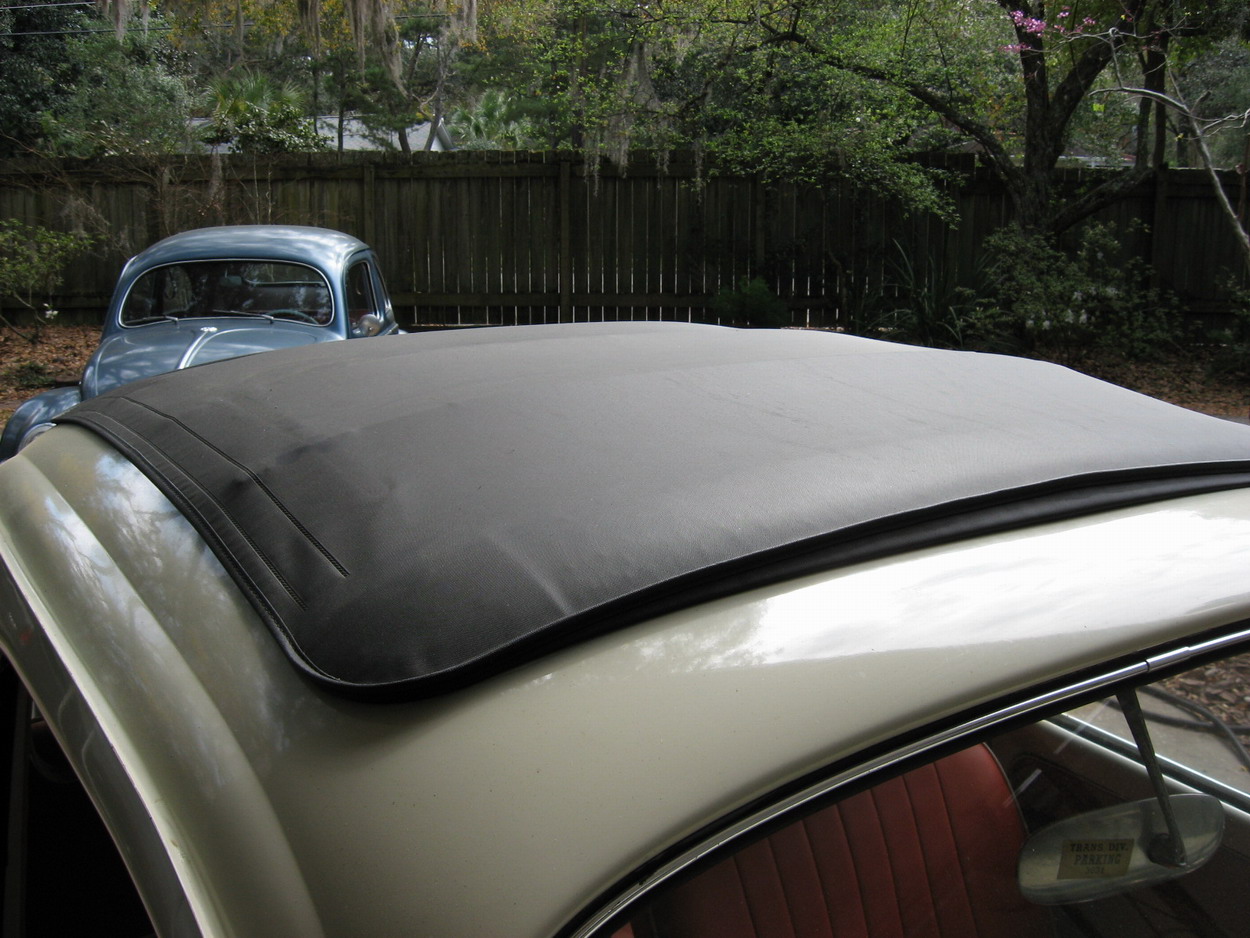

On the same topic, I have a new top for my '63 but the seam at the front is creeping up and away from the front edge. Any reason? Cheap top or improper install? It was installed just before I got it and the more I use it the further away from the front edge the seam gets! So who makes the best top?
Originally, VW used rivets to secure the cover material to the front header bow. These days, most people use a poor contact cement to glue it down. Probably a comination of incorrect glue and the cover is too tight.

67 Florida Deluxe is offline
PostPosted: Thu Feb 15, 2007 12:04 pm    Post subject: Reply with quote
my59 wrote:
In my gallery I've posted the manual for a 59. I used rivets to secure the replacment one I got from BFY. The manual has info re adjusting the tension so the front dosent lift.
I looked at your gallery and those pages from the manual look great! I assume they are applicable to '63. As you can see, I have two issues; the first bow doesnt look to be installed properly and the front edge is creeping back. (I may have a third issue - I dont know if this is a quality top Confused ) I'm going to print the pages from the manual and go see if I can improve this situation.
