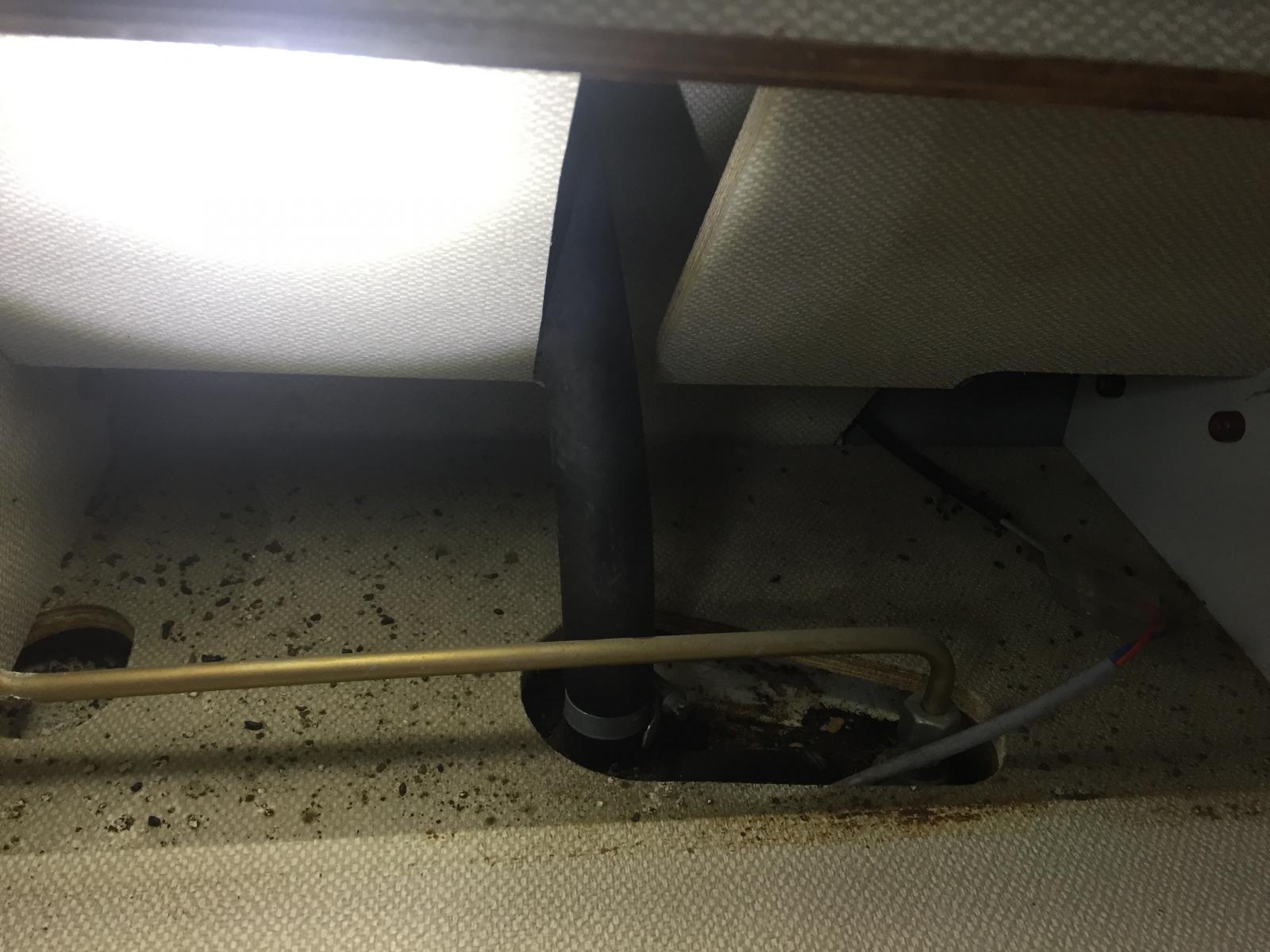

Hi! I recently bought a Vanagon diesel from '91. Today cleaning the cupboards i noticed that at some point in time mice had entered the van and even chewed a wire. Does anyone know that this the wire is for?

That wire is for the 12v sink right?

The sink pump is working, I was thinking preheat for the LPG or maybe something for the wastetank? It goes down that hole in the floor (or so it seems).
The US version of the vans most of us are familiar with didn't have either of those things as options. Can you find the other end of the wire?

I will have to go under the wagon and check tomorrow.

100% it's the LPG preheat operated from the combined kitchen cupboard control unit!

The car came from Norway, spending every winther in storage. So I am suspecting that this happened while in storage.
