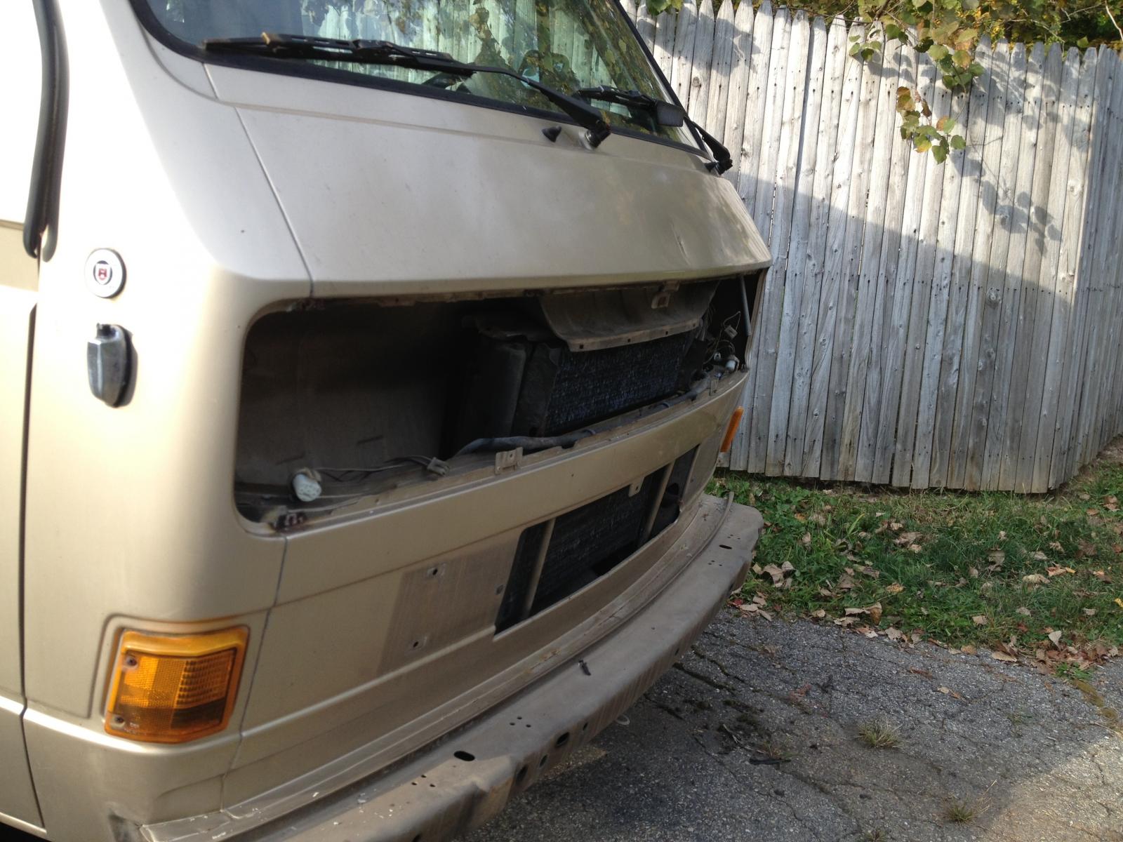

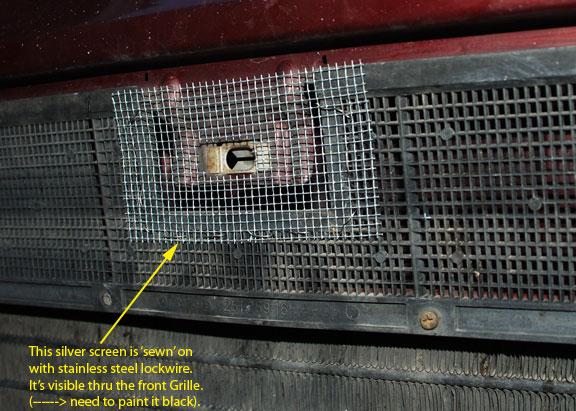

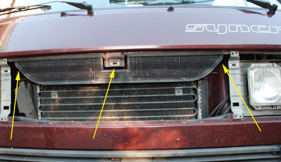

Having mouseproofed my vanagon almost 5 years ago, I think the best advice is to defer the legends until later and for now study the photos of physically plugging holes with "metal screen" and "pot scrubbies".
1) & 2) below, are wide open on every vanagon, they are the basis for the urban legend. Once mice learn those paths, new campground mice can smell those who have gone that way before - thus locate the holes quickly.
At minimum, do 1&2 then you can pursue animal legendry in your leisure. If you do a good job plugging the holes you will get good results with your other methods too (except trapping which will be less fruitful).

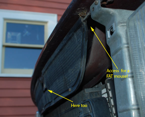

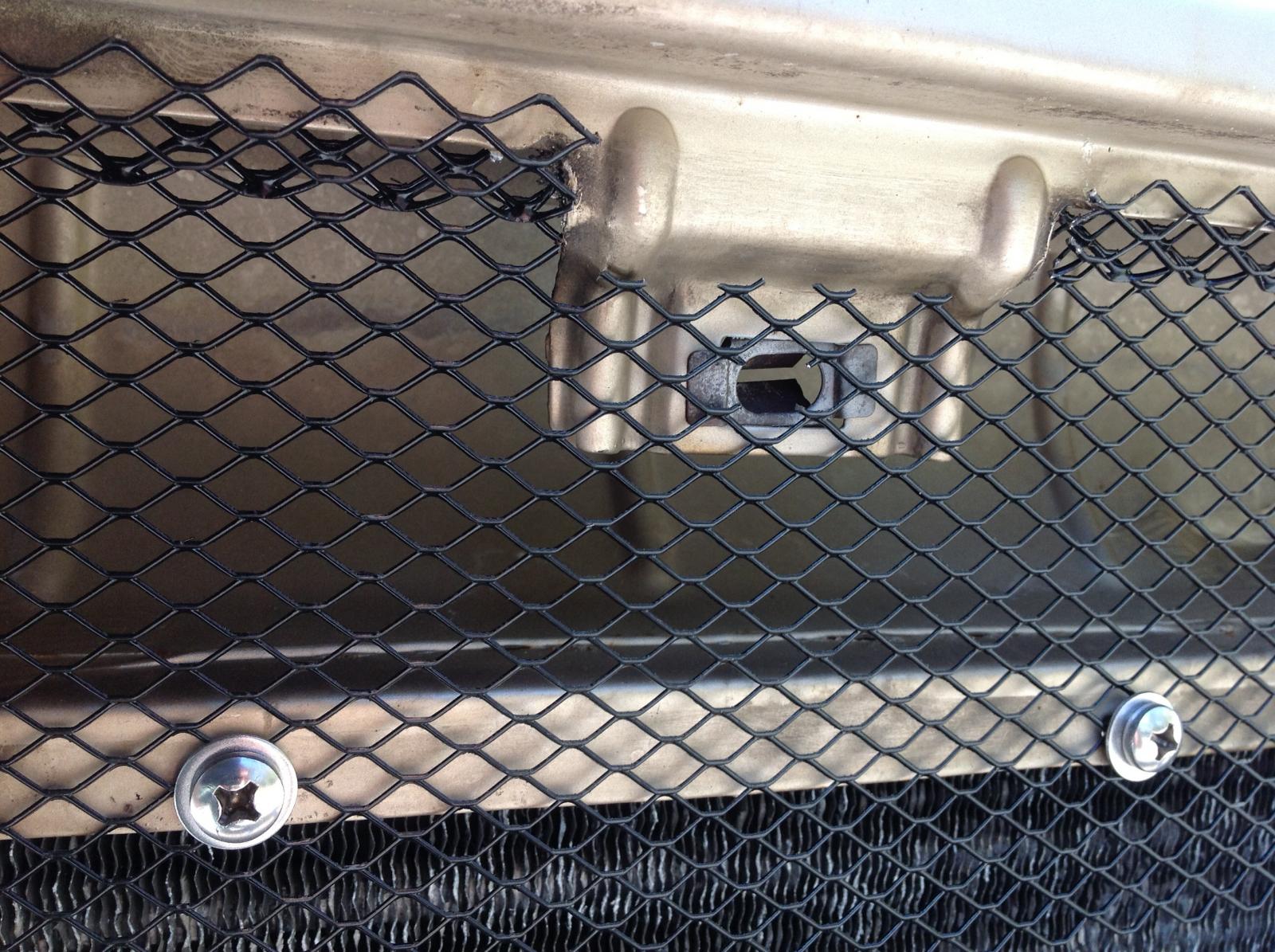

1) screen the fresh air vent behind the radiator grille.

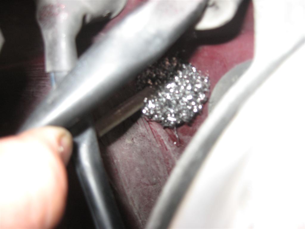

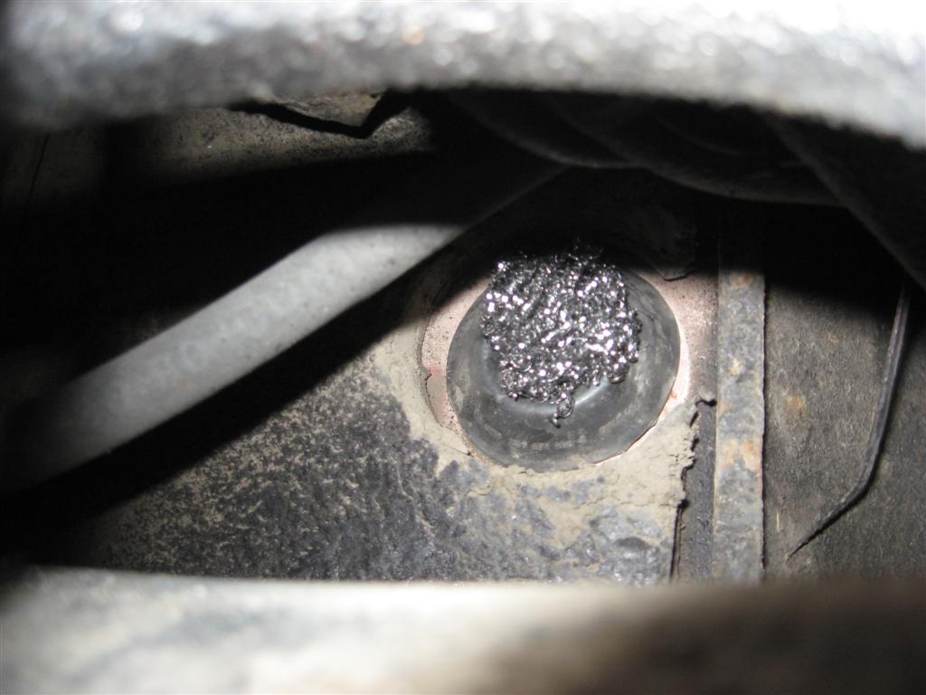

2) plug passenger and driver side battery box vents with stainless steel scrubbies.
3) check the large rubber seal at the engine ECU wiring loom and if seal is gone, repair it with silicone. And a large grommet for the headlights too.
4) I guess on some vans you need to look for rust holes too. A nightime helper inside with a bright light inside then crawl around outside looking for light.

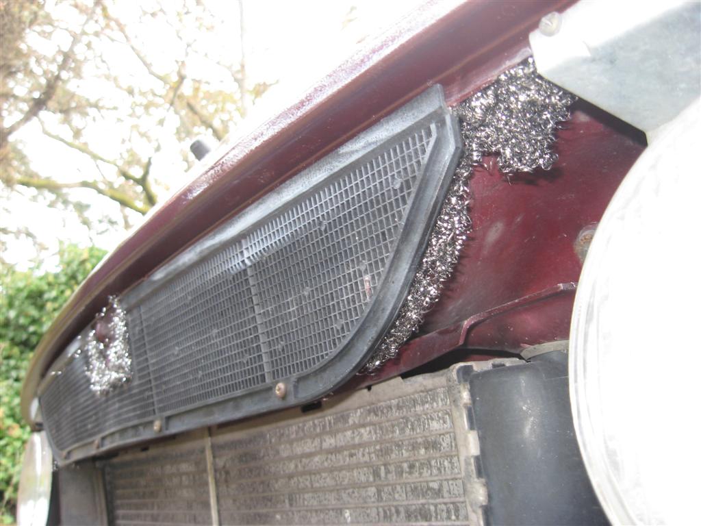

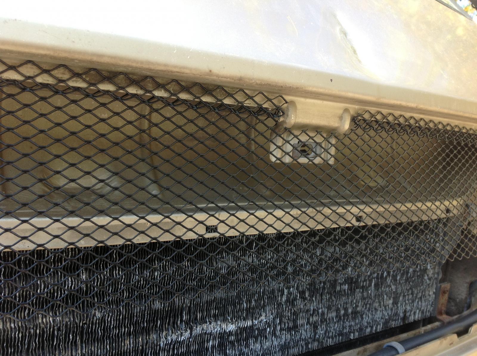

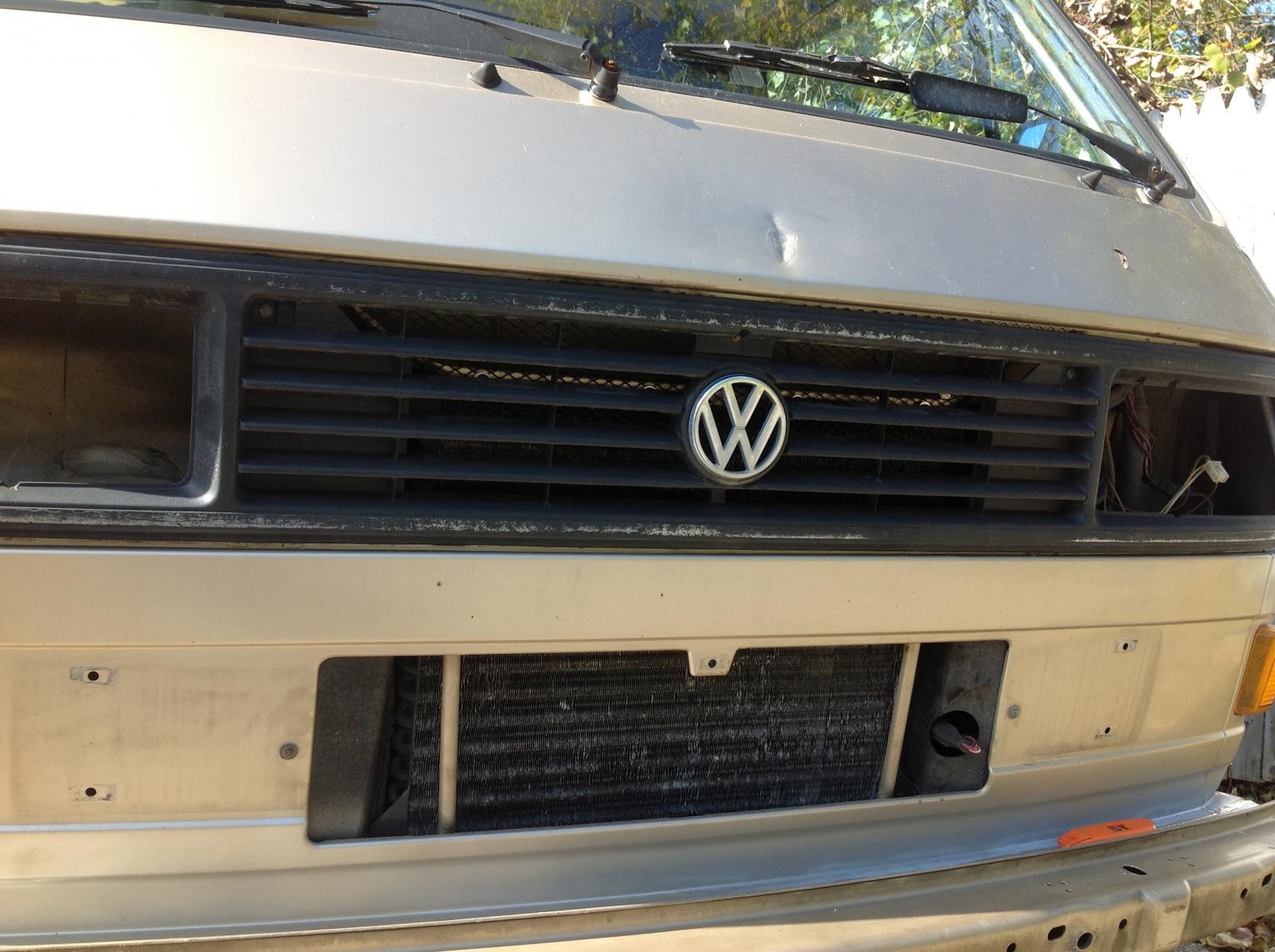

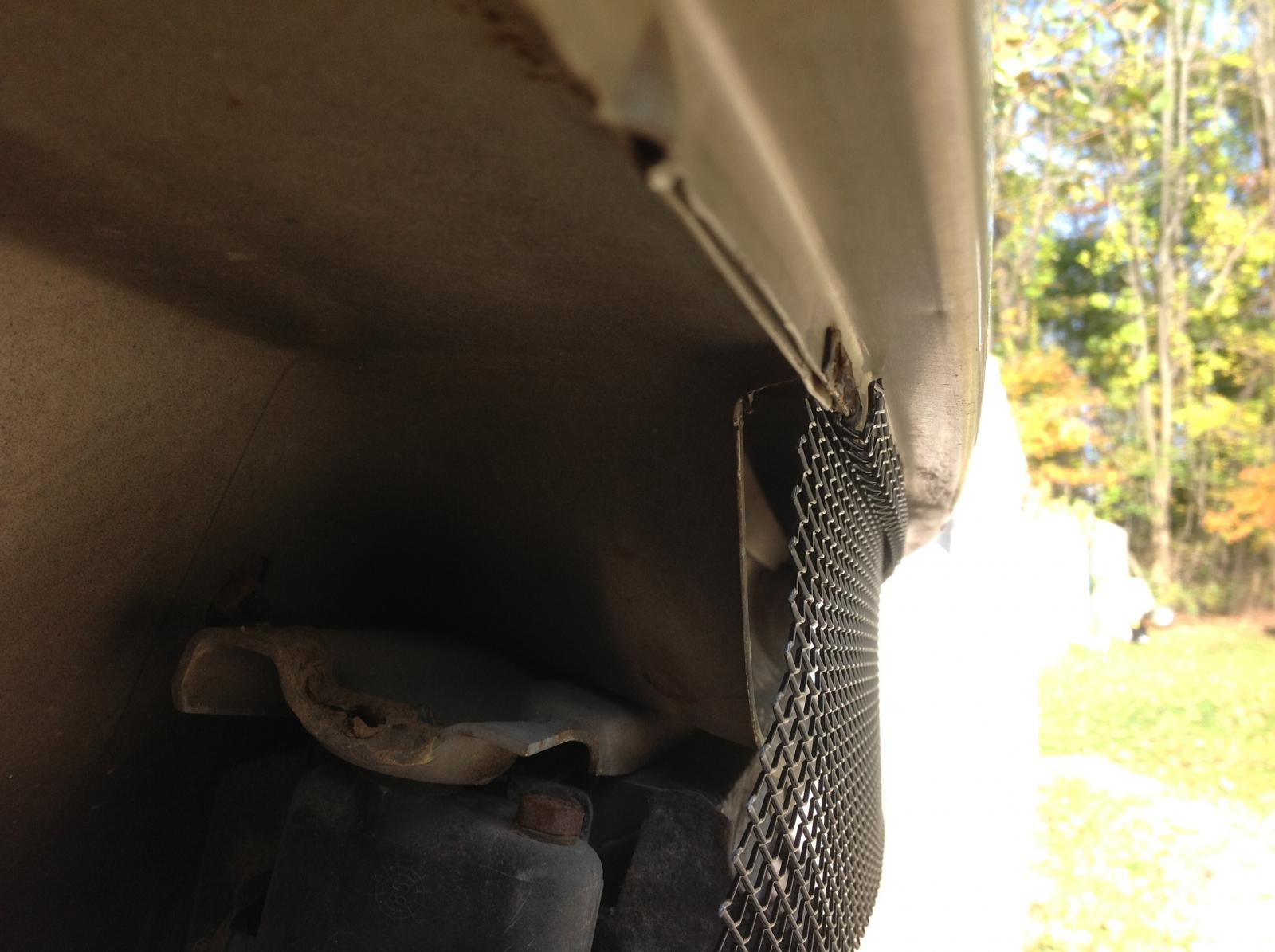

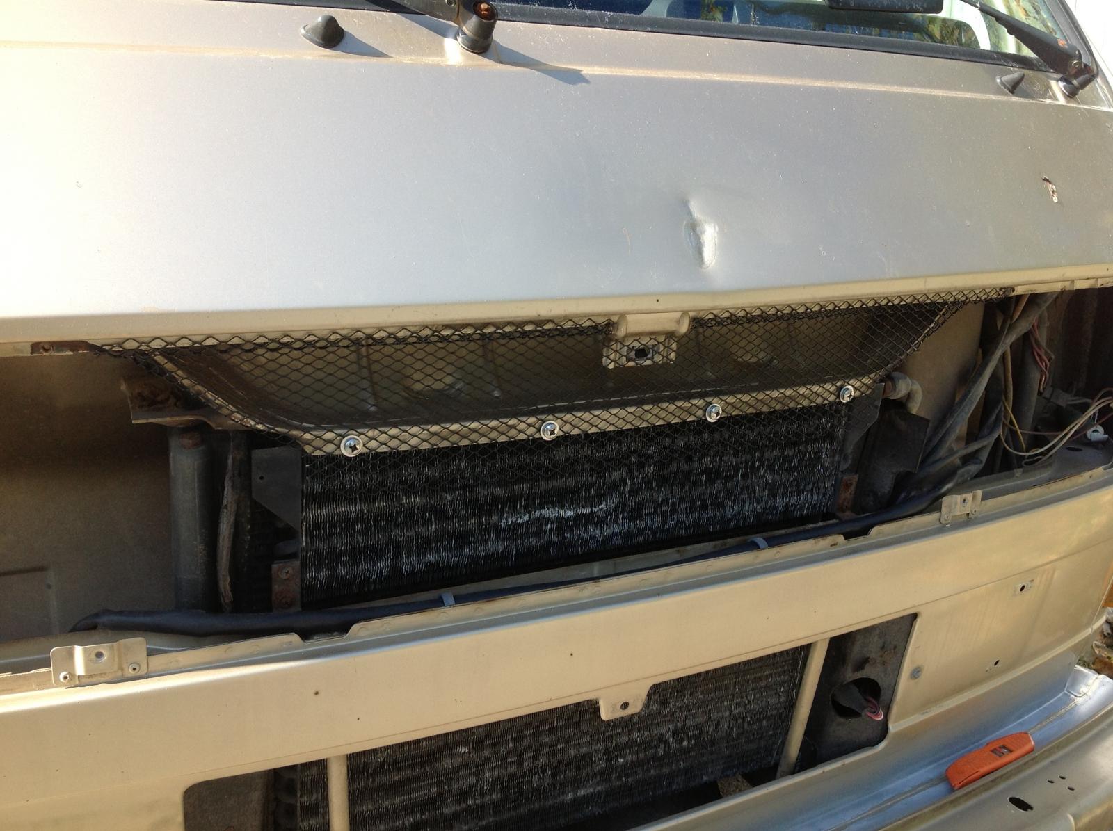

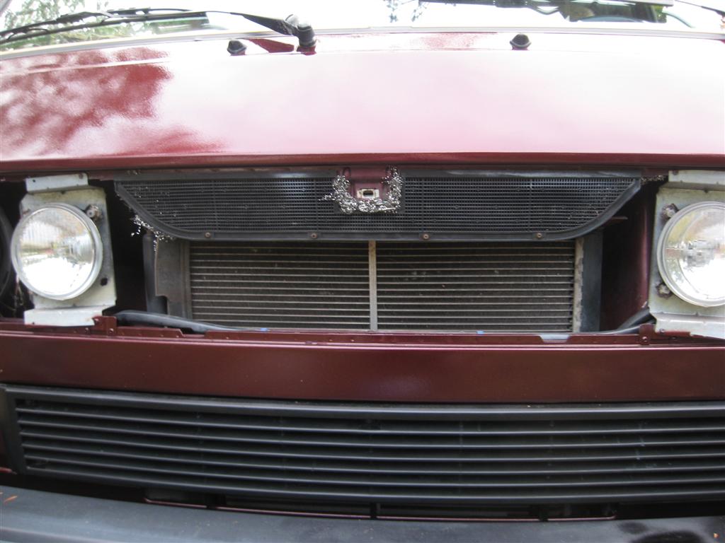

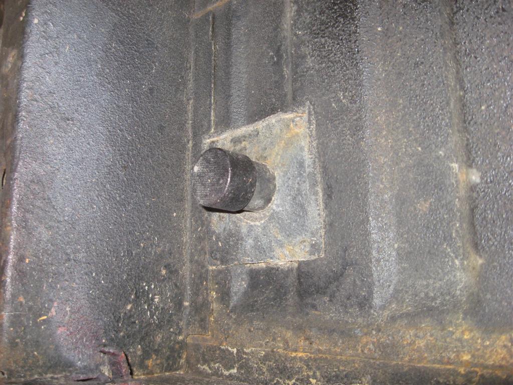

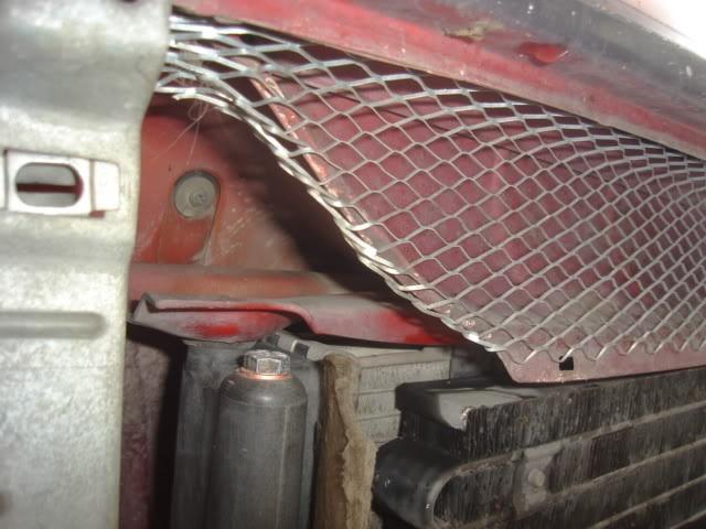

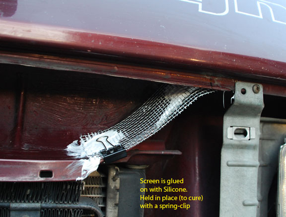

Here's a photo of how 10cent blocked the fresh-air vent behind the front grille:
....KTMs, GasGas, SPOT mtb

For those of you who searching for ANSWERS, I've located some actual information from "danfromsyr".
-thru the front fresh air grill behind your upper grill, the plastic bug mesh is way open in the corners.

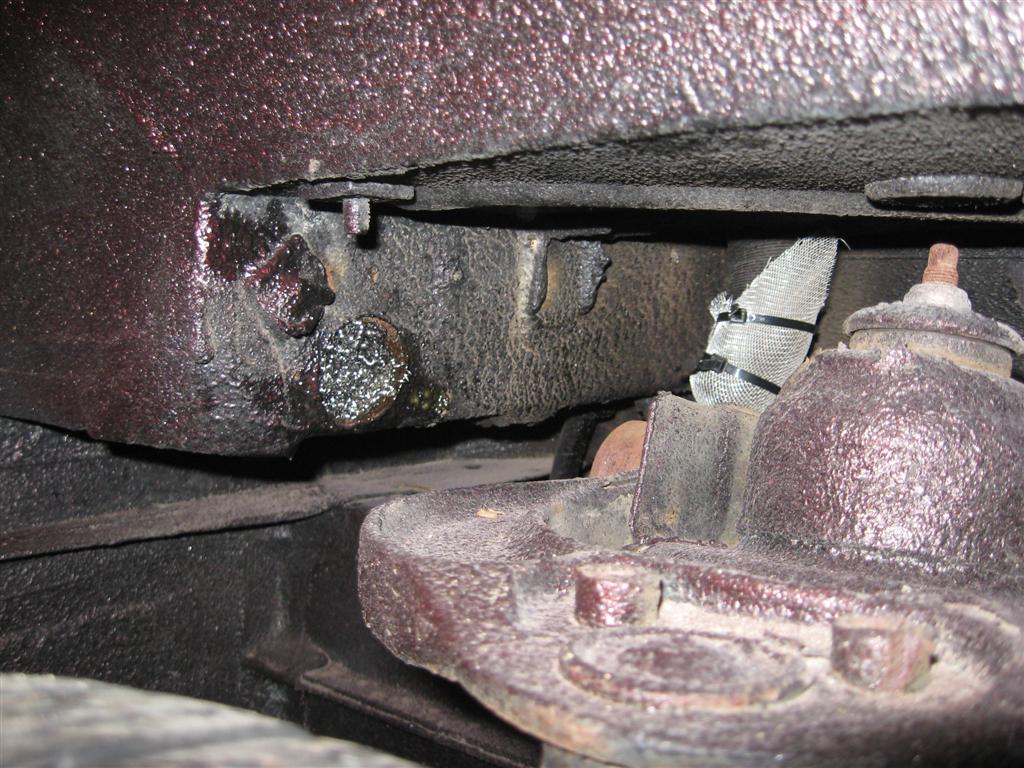

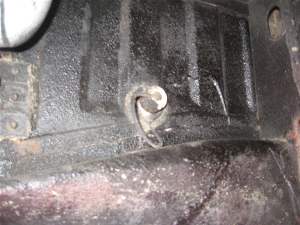

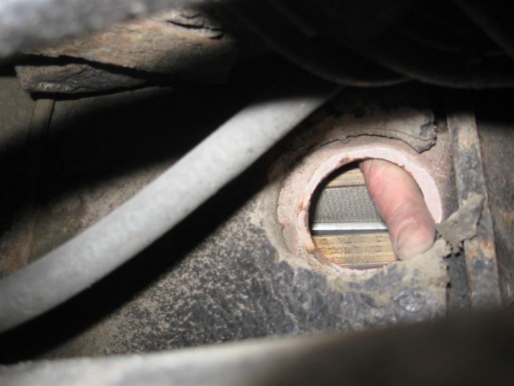

ok i'm on a mission to find and close mouseholes on my westy (with thanks to sodo for inspiration).
Rigged up this screen and zapstrap job to close off the battery vent hose. see before and after pics - honest opinions (even harsh ones) welcome:)
I also noticed the other hole in the wall of the wheel well, leading into ?the battery compartment. Does anybody know what this hole is and whether/how I can close it off? (Thinking of just pushing some screening into the hole and holding it in place with a bit of silicone but want info and opinions 1st).
91 syncro westy w/ 08 suby ej25

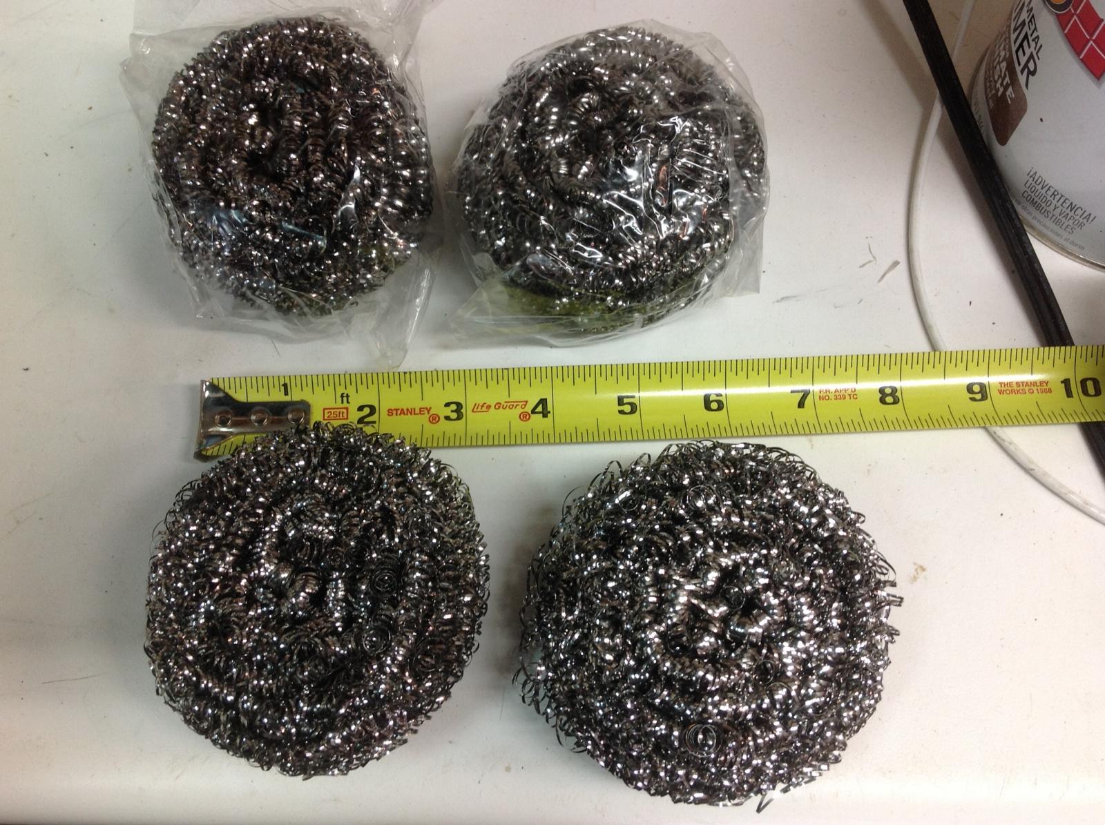

Metal screen covering a hole is a 100% effective barrier. A coarse stainless-steel pot-scrubbie stuffed into a hole will allow ventilation and block the passage 100%. There are many, many ways for the versatile hobbyist to solve this problem. The Westy can be as mouseproof as all the other cars in the campground. (Thread bloat is far more difficult problem to solve than mice!)

PostPosted: Mon Oct 11, 2010 10:12 pm    Post subject: Getting somewhere? Reply with quote

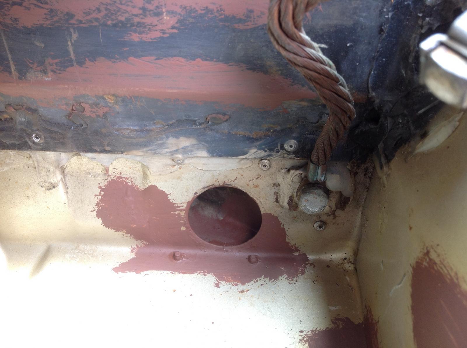

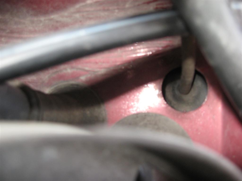

Well I just couldn't take it anymore... Sodo, this one's for you!
(Thanks out to Alistair for all the support and fingers)
Battery vent hole and mystery hole (also battery vent?) - filled!
Three holes / cracks in cabin air intake (goes to heater box) - filled!

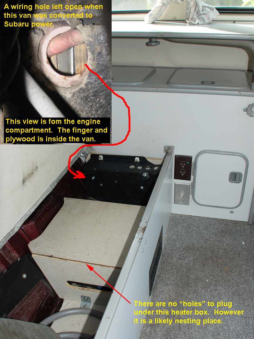

Hole behind driver's side headlight, into area behind dash where grommet has popped loose - filled!
Former digifant wiring hole (behind bench seat / water tank - wires removed when subaru installed)- filled!
No hole in sink drain.
No hole in propane lines inlet.
No hole in water tank drain (cap in place, sealed on edges).
Now to buy some peppermint oil, cotton balls and baby bottles. Laughing
Looking forward to restful, mousefree sleeps!

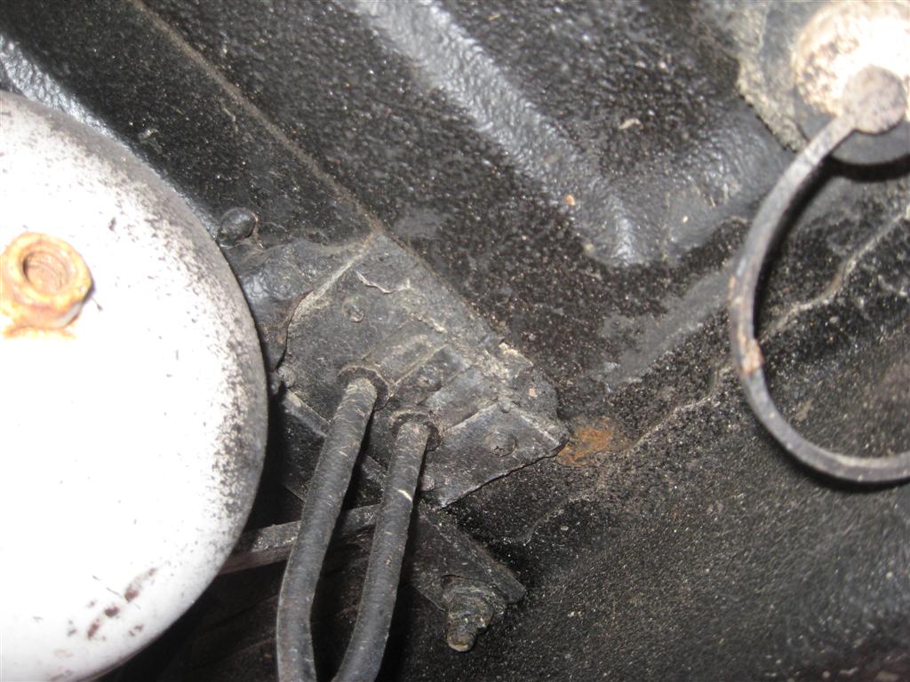

PostPosted: Tue Oct 12, 2010 10:22 am    Post subject: Reply with quote
....and poop-free. And with luck this thread can be poop-free from here on out. I think I finally found my most offensive mousehole. If any mice get in after this, I'm going to try peppermint oil (to relax too!).
Here's an image with further clarification of Simonslp's photo. In my van, the Subaru wiring passes thru this hole, but there (was) plenty of open space around the wire bundle for a FAT mouse to get in. This seems to be a "converted" problem, but every Vanagon owner should probably inspect this 'hole' to be sure the grommet is in place and intact. It's also very visible from the outside, ahead of the left rear tire.

PostPosted: Tue Oct 12, 2010 11:35 am    Post subject: Re: Getting somewhere? Reply with quote
[pic]
With battery cover in place, isn't the battery box "sealed" from the cabin? Or are the mice victims getting nests in the battery box? Ok, granted, most covers are a bit mangled and loosely hanging by a single ill-fitting screw...
-James

PostPosted: Tue Oct 12, 2010 12:00 pm    Post subject: Reply with quote
I hear ya... and my battery compartment cover fits pretty snugly with a whole TWO ill-fitting screws. On the other hand I figure it can't hurt to cover all glaring holes.
AND a little bird reminded me that it would be a bummer to discover chewed wires, or a corrosive, smelly mouse nest in your battery box.

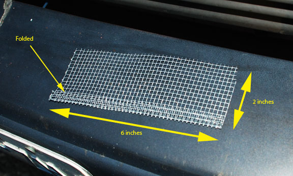

OK here are my pictures of plugging the Fresh air vent access with 3/16 galvanized screen (also called "hardware cloth").
Here's where they can get into the vent system, behind the front grille.
Screen is folded over to make a hard edge. This edge touches the backside of the
black plastic vent screen.
Can't drill holes in the fresh air duct (to screw the screen on). You just cant. Try it and you'll see why.
You could use black silicone. But all of this white silicone is hidden behind the black plastic screen, not visible.

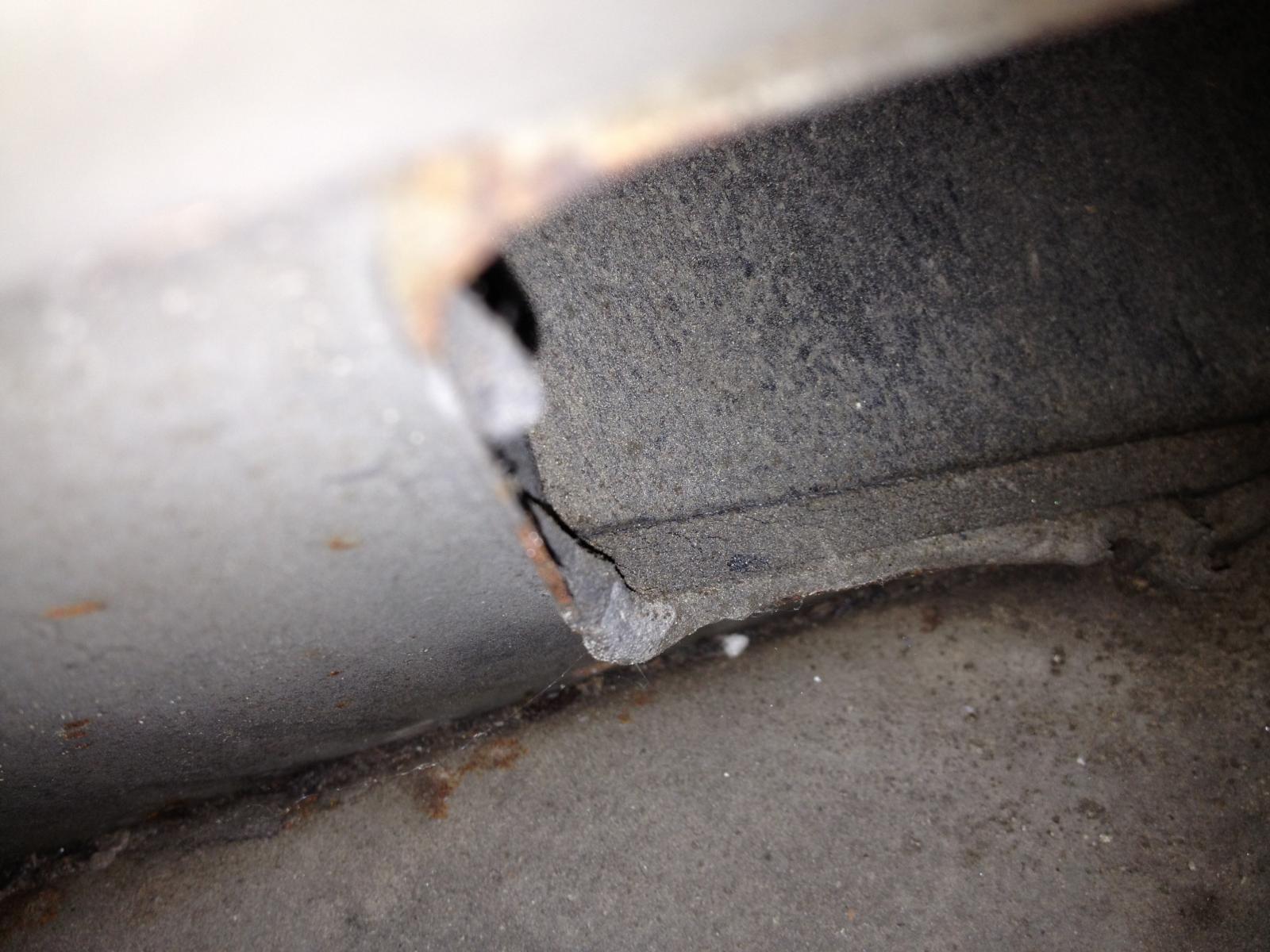

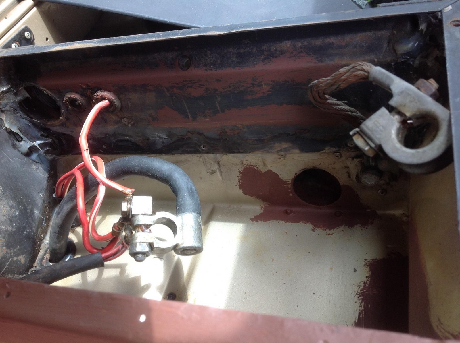

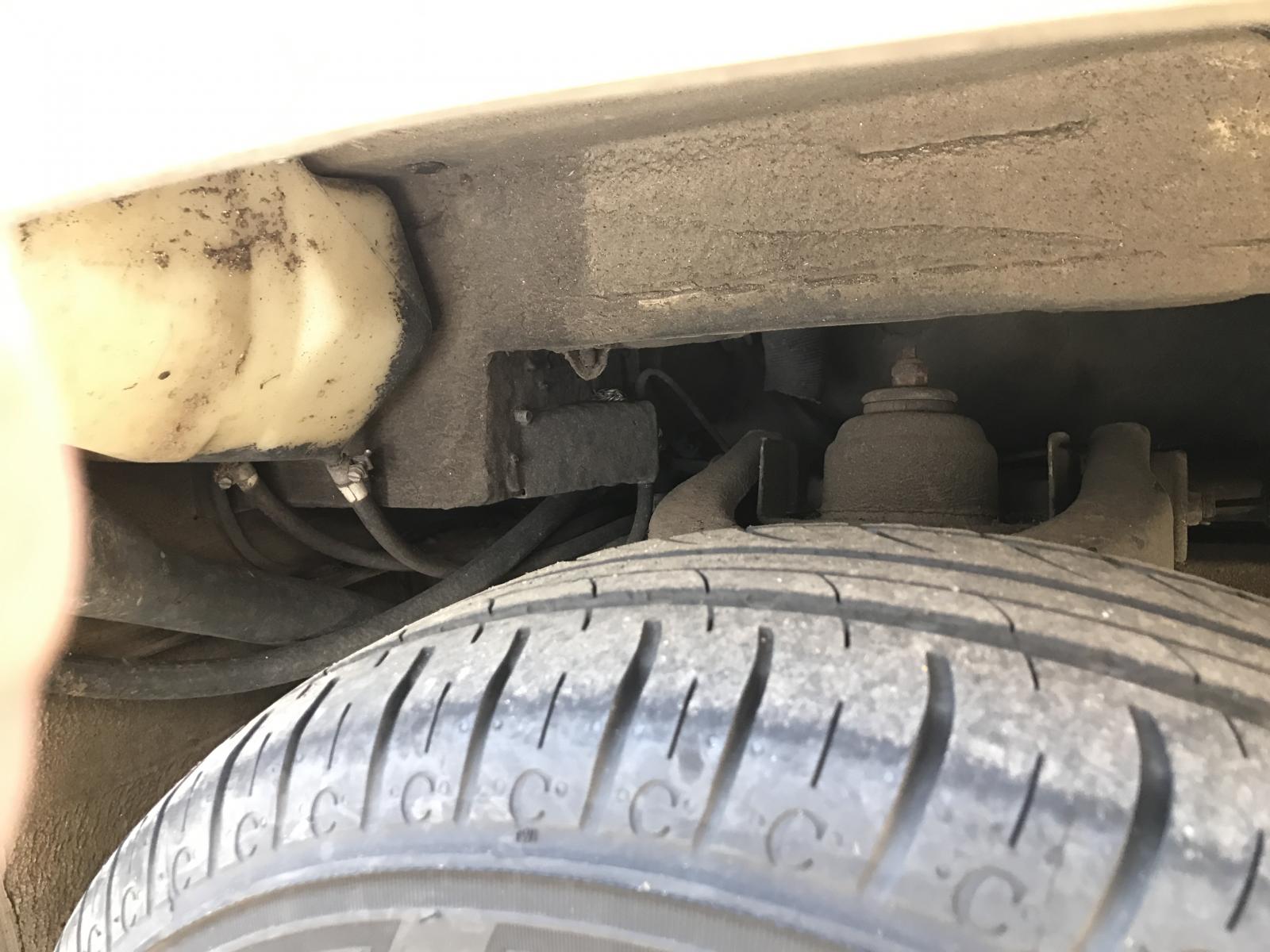

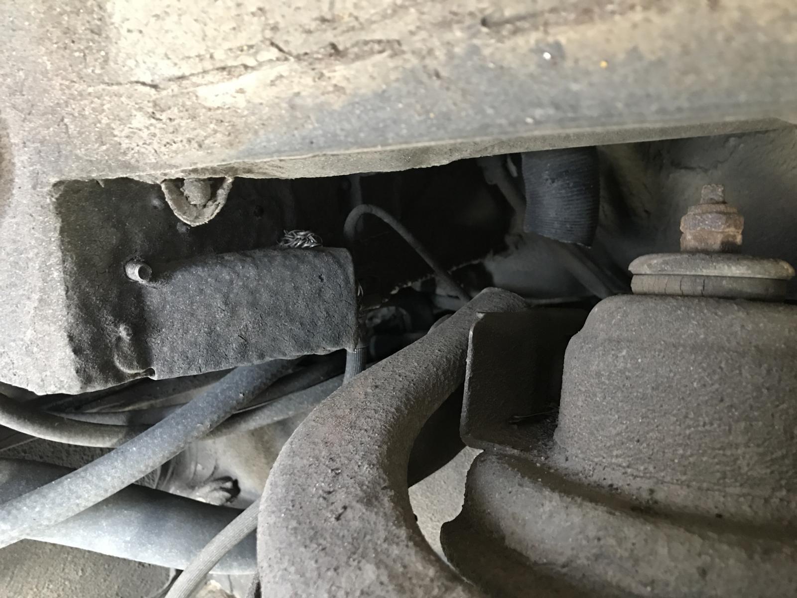

Fixing the battery boxes it is clear that they are vented for gases to the undercarriage.
It is also clear that mice use them for nesting if mouse crap and nut shells are any indication.
On my 1986 Multivan "Weekender" I have a mirror image of the Right Battery Box also on the left behind the Drivers seat. Same Vents, same dividing sheet metal piece. Not every Van has the fully formed Left Battery box, but some do.
The ONLY access is via these vents lower right..... Upper Left......
Close up of lower vent.....
Thinking of ways to hinder access steel wool cane to mind but...... It's prone to rust........
Wait!
Stainless Steel Kitchen scrubbers!!!
(It takes about 1/3rd of a scrubby to do one hoke adequately)
Stuff one in the passage, gas can pass...... Mice Cannot!
No more mice in my battery boxes!
Passenger wheel well.....
Closer....
My finger is touching the steel wool I inserted.....
So, the front grill is off, checking out the mice infiltration. As mentioned, I know they've been in the Fresh air system, I saw their nesting when I had the dash vent pipe off.
Here is a photo of the intake scoop with the screen removed......
A closer view of the scoop, the air is forced up and over the top of the dam...... Notice the ingenious water deflection lip. The rear of the scoop is folded back forward upon itself leaving a collection place for water to drain off while traveling at speed! .............

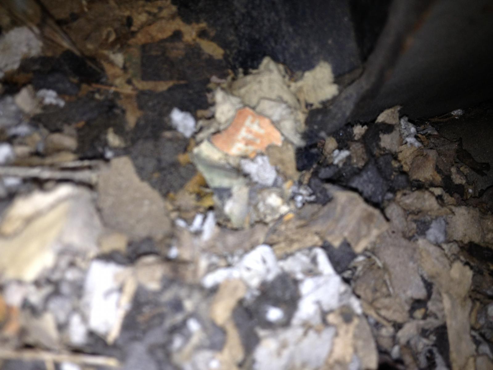

I held my camera phone up in the slot and blindly took photos to see what joys await me!........
The Drivers Side......... I do NOT like the rust I see at the base of that seam!!!.... Evil or Very Mad
The Passengers Side............ Sad ..............
Heavy sigh........ Off comes the dash and a much better mouse screen MUST be made!!

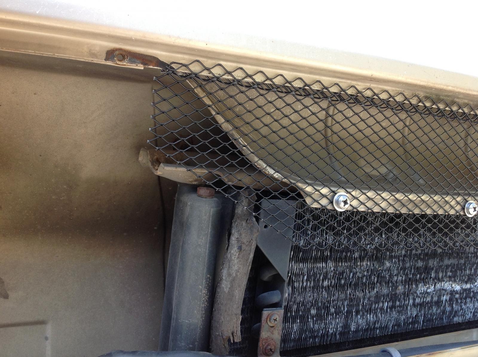

Well, I'm working on rust erratication, bug prevention and mouse prevention as I await my engine and transmission parts/seals to arrive.
A major concern is mouse intrusion into the heater system. I already have a nest of unknown age which will require dash removal and cleaning this Winter.
I want to adequately screen the opening to prevent new Settlers!

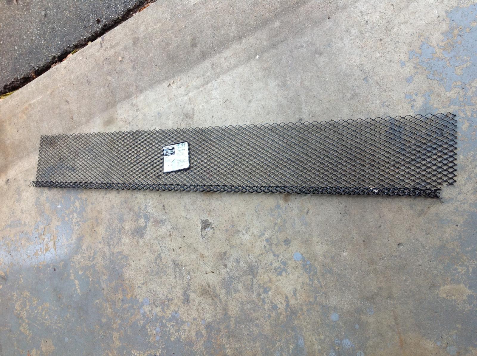

I plan to do as 10cent did........
I was in Home Depot looking for hardware cloth and stumbled upon this in the gutter aisle.
Adequate length, adequate width? Already painted Black!
Hmmmm $3.04 out the door pricing! Sold!
Now to install it, probably tomorrow........
Edge view showing the bend to hook onto the gutter, I may need to straighten that.......
MOUSE PROOFING THE FRESH AIR INTAKE
this is so simple that it should be mandatory!
I cut the leaf guard to 31" long.
I laid it on the bench and using a scrap of wood compressed the factory "lip" tighter so it would firmly grasp around the sheet metal lip at the top of the grill opening...........
I next had to carefully notch in the center for the center grill support bar.....
The opening needs to be only 3" wide and just remove the folded lip plus a Smidgen more...........
I then used SHORT (3/4"....1") 1/4-20 stainless screws, washers and locknuts and utilizing the factory screen fastening openings, fastened the lower screen to the scoop....... I also clipped out an opening for the Grill mounting screw.....
I next had to fold the screen up the slanted sides. Be sure to NOT leave any opening along this for a mouse to enter....they do not need much space!......
I cut an angle........
I then modified the angle so I could easily fold the edge under. I didn't bother folding the lower front edge...... Crimp it tight using pliers.........
Here it is all folded and neat........
And with the grille installed. I'll paint the hardware and leading edge of the air scoop black.......
Now my question is...... The factory screen was MUCH finer...... Why?
Did it disperse rain drops better?
Did it block small insect entry better?
What issues will I have with the larger openings? ...........
tencent! You've done this! Any problems?
I'm going to guess that NOT having Mice in the heater is well worth whatever trade off is being made with the bigger holes!

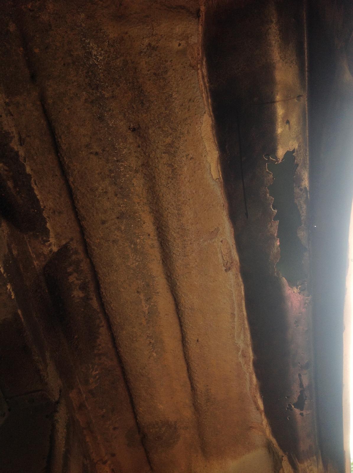

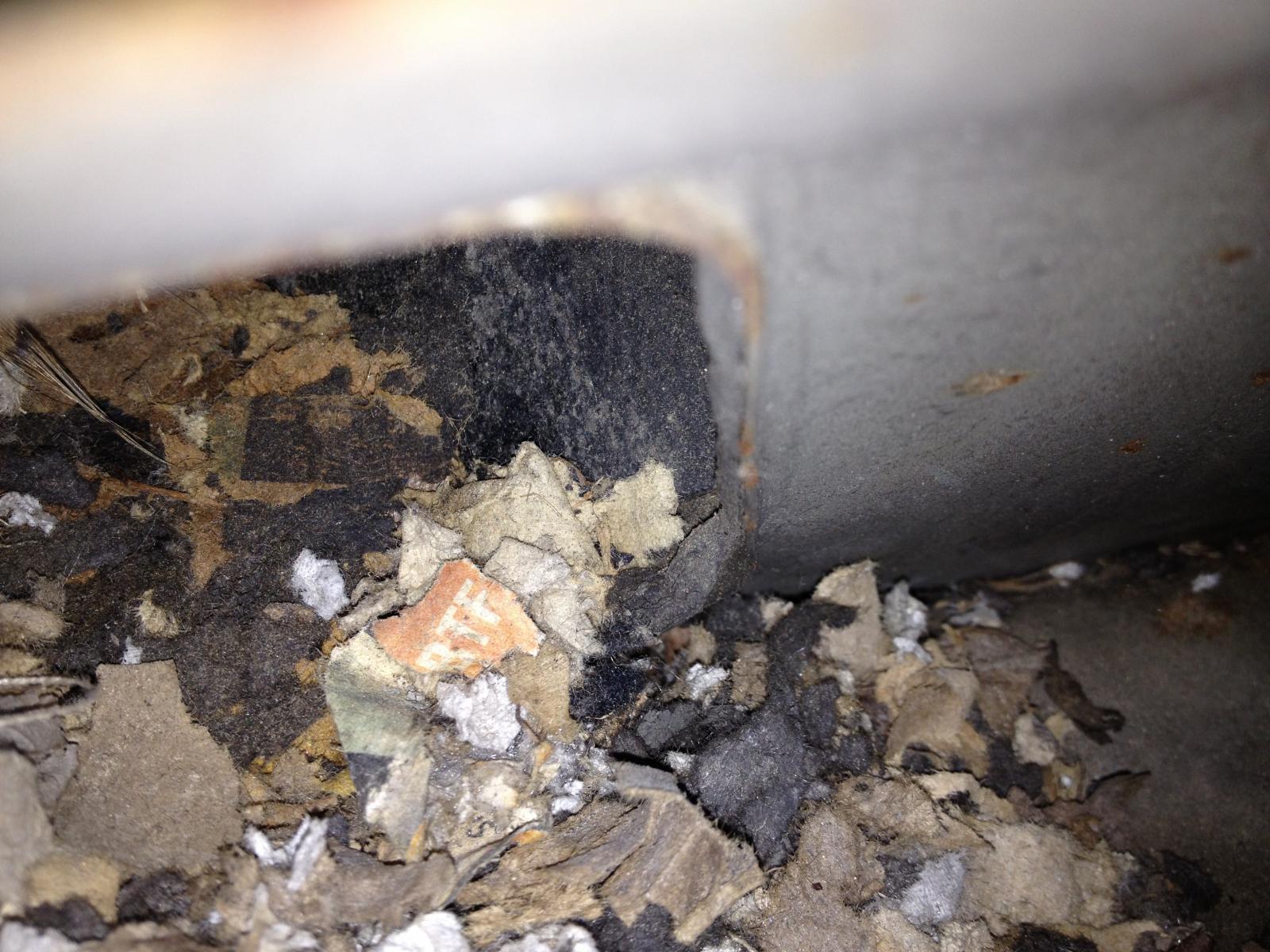

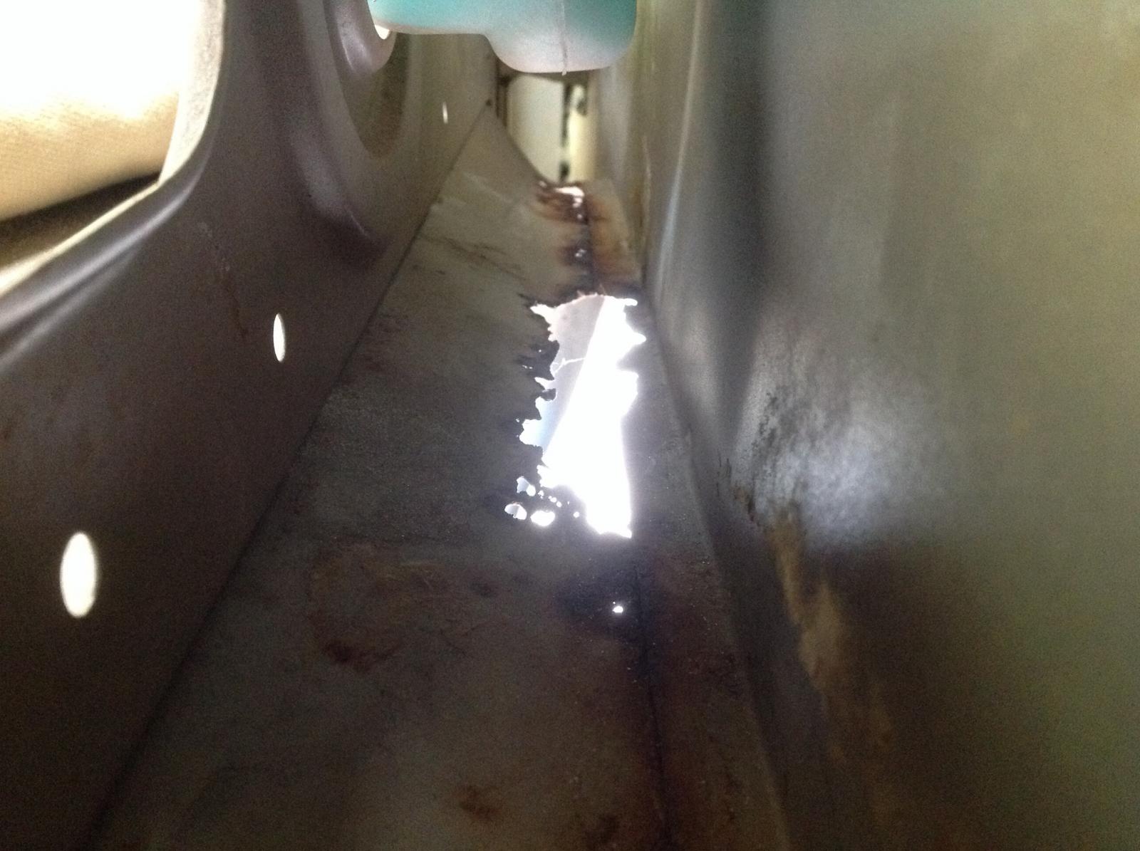

Keep in mind that no matter how many Factory holes you may find and seal up that allow mice to enter........
You must closely examine you Van for rust holes!
My Rear washer bottle leaked whenever the motor ran..... Apparently for YEARS!!!!!
View looking up in to my RR wheel well.......
And looking from above after the interior panel is removed.......
I did have mice from this huge hole!
Dave
Ghia
Vanagon
Beetle
