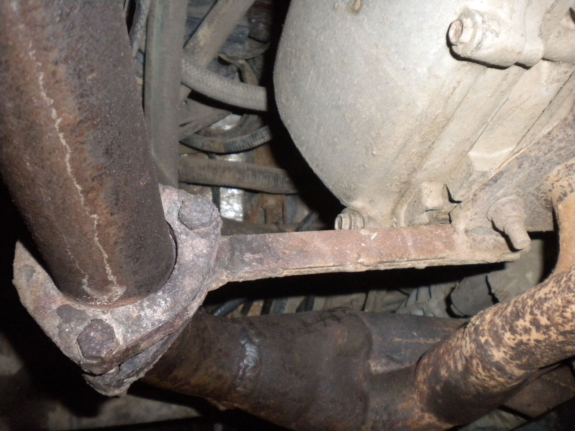

I have this stainless exhaust, 2 years old, and it's really rusty. I would not be able to tell the difference between this and "steel".
http://www.smallcar.com/index.php?dispatch=products.view&product_id=29829
http://www.smallcar.com/index.php?dispatch=products.view&product_id=29799
Should 304 rust like this? I could post a photo but it might give some folks the willies... Shocked Shocked

PostPosted: Fri Nov 26, 2010 8:00 pm    Post subject: Reply with quote
It was gleaming, looked like chrome, just like this:
This photo below is 22 months old. I'm surprised to the extent that it rusted. Wondering if the aluminized coating process would be better than this type of stainless (304).
Notice even the Stainless bolts rusted bigtime.
The question: Is this "normal" for stainless --->exhaust<--- systems?

The small car exhaust sure does look nice new but I've seen quite a few failures. The outer surfaces do rust, especially in salty conditions but the main thing is that sometimes the muffler baffles come loose, causing a loud and rattling exhaust. Stock steel mufflers last about as long.
The headers are made of the same stuff and they look beautiful at first but I've seen many crack and rust. I'm curious as to how many people have had good or bad experiences with those headers after a year or so of regular use?

I had to have several cracks welded up recently. Mine were packed up with mud but they didn't look too bad when they were cleaned up for the welding.
They are the only syncro subaru conversion header available so...

In salty conditions it would still rust. Have you tried cleaning it with naval jelly?
