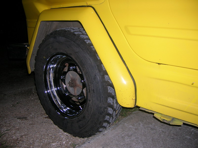

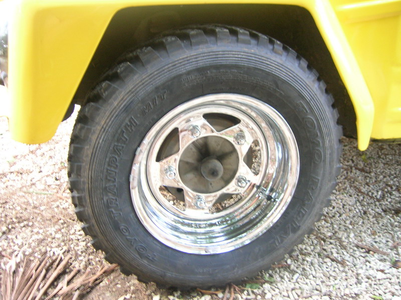

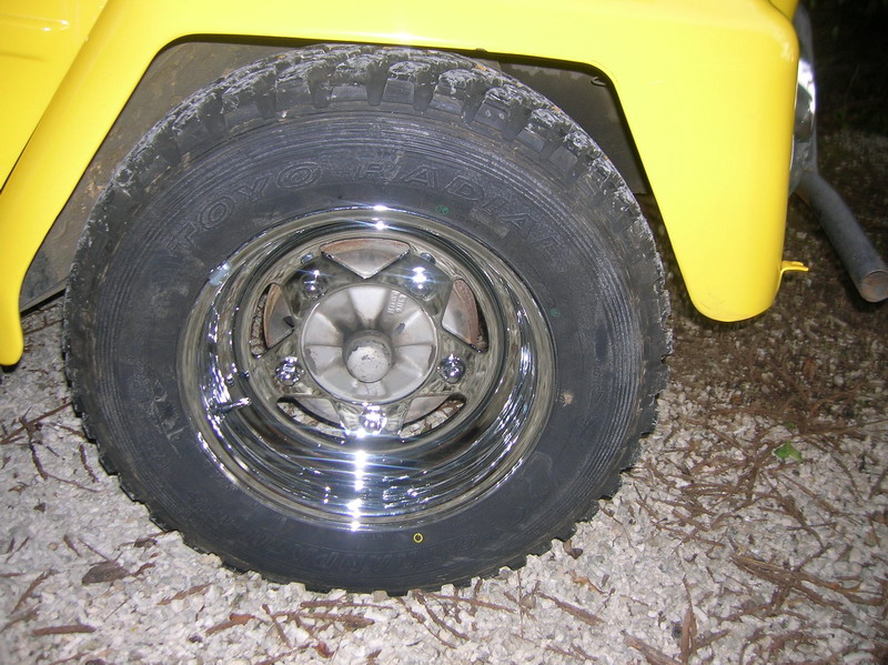

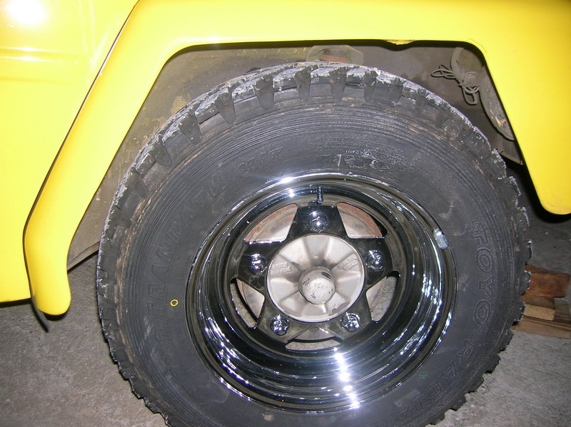

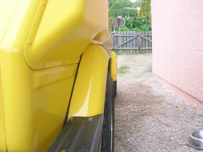

Some new stuff for that sticky ! I finally purchased new tires and had them install on my 6X15 baja chrome spoke wheels I had for a while. I chose Toyo tires in 195/80R15, in an agressive thread. I love them Very Happy BUT they rub up front. Evil or Very Mad Evil or Very Mad Evil or Very Mad
S_it ! I hate this. I was sure they would be fine. I thought 195r15 was reasonable. It rubs on the outside, especially the right side. It rubs when cornering, when "rockcrawling" a sidewalk...I don't even imagine doing some light off road. Jacked up at the tire shop, it looked fine. I was their last customer of the day. They closed the shop just after I left, so I couldn't go back and change the tires. I'll go tomorrow...Here's some night shots I took back home :
Rear is fine
Front rubs : see the inner fender lip is already bent... Evil or Very Mad Evil or Very Mad
Overall look is great Evil or Very Mad
I considered many options on the way back home :
- wide fiberglass fenders (on all 4 corners)
- stiffer gas shock absorbers (GR2 or coilovers) to replace the stockish oil (cofap) ones
- smaller tires up front (like 185r15) with a less agressive thread... Crying or Very sad
any other ideas...?
I think I'll go change the tires tomorrow 'cause I can't drive like this and wait for new fenders or shocks to be delivered...and Thing is my DD...
I'll keep this updated.

Well, update :
I went back to the tire shop and changed the front tires. I went for Michelin Agilis 185/80R15C. Not the same beautiful agressive thread, but no more rubbing issues. I guess I should be happy, but I already miss these beautiful Toyo tires. I will post pics of the new combo soon.

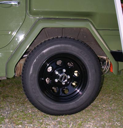

I had the same problem with my Toyos. It wasn't the brand of course, but the size. After going to a smaller size Toyo which fit, but was still tight, I installed new shocks. I had no idea that the existing shocks were original and completely shot. After installing new KYB Gas-A-Just shocks I gained at least 1 to 2 more inches of clearance. It made all the difference in the world. A lot of folks seem to dislike the Gas-A-Just shock because it is too stiff and makes for a harsh ride, but I haven't had any issues. Maybe because I have nothing to compare it to?
Black Cragars (Jeep pattern) with 205/75/15s...
What's the size of those cragars ? I guess 15x7 minimum, 'cause I can't imagine smaller wheels for a Jeep. What was the size tires you tried that were too big. I like your Toyos, but I wanted something more agressive. And they were too agressive Crying or Very sad with my front fender Shocked .
I'm still thinking about options to go back for the 195R15 Toyos. I'm still not decided. Maybe I'll try :

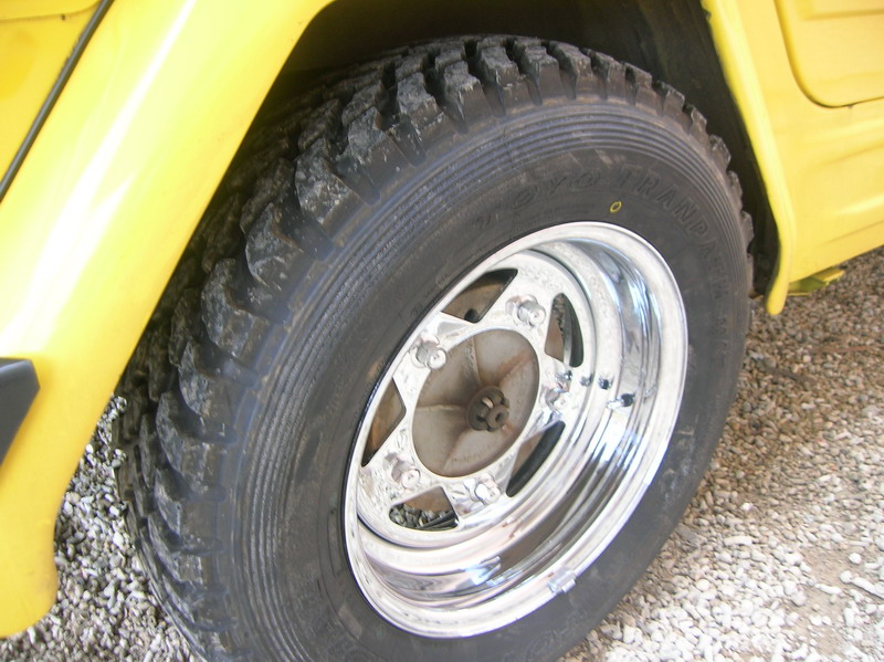

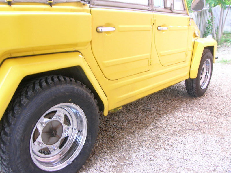

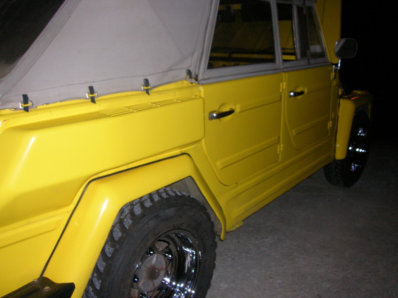

OK, here's some dayshots of the new tires :
before changing the front tires
Looks very close to the front fender, too close.
Looks better, but the car was not on a straight floor. Like this, it would have fit.
Back from the shop with the new tires : Michelin Agilis 185R15C. This time, no more rubbing issues. Cool
Overall look is not too bad...
One day, I'll go back to this... Razz
This angle shows the difference in width between rear and front tires.
I kinda get used to the new look and sort of like it. I'm happy that I finally have my new wheels on the Thing. They were sitting since 1 1/2 year and I couldn't wait anymore...
Hope all this will help other Thing fellows in their future choice for wheels/tires. That's what this sticky is for... Wink

Yes, the Cragars are 15x7. All of the other info regarding my clearance issues (tire sizes, etc.) are in this thread (from the "Will It Fit" section of the sticky) called "Tire clearance help... again " I thought I originally had Toyos, but I guess they were Yokohamas. Now there was a nice aggressive tread. Man I loved that tire/wheel combo! Check out the pics - and see how they obviously didn't fit...
http://www.thesamba.com/vw/forum/viewtopic.php?t=232993
I would think wider fenders would be the absolute last resort. Personally, I just don't like the look of them. But the cost of the parts, shipping, matching paint, etc., not to mention the effort. What a hassle. While I wanted bigger tires I found that an aggressive tread in a slightly smaller tire combined with new shocks was all that was needed.
