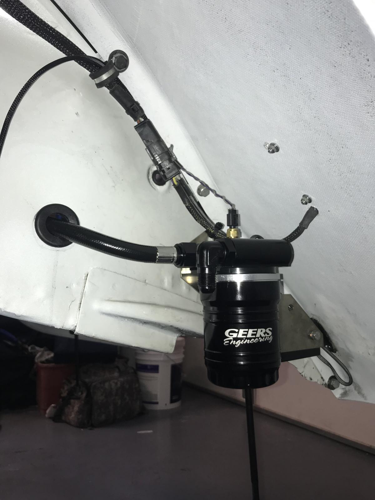

This is where I put it. What do you think?

That is a remote filter... where is the cooler? Or am I missing something? Why the extra loop in the lines?
