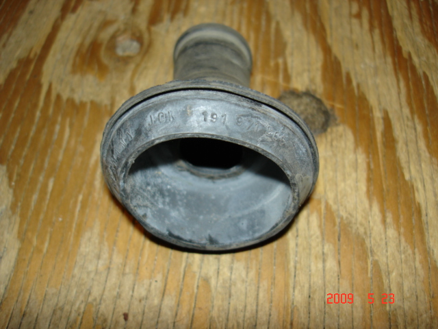

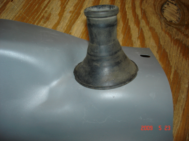

Good idea, those are shift rod bellows, one on each end of the rear shift rod. Here's a brand new one in my box o' parts for the '79 Westy.

1975 Kombi
Joined: August 12, 2007
Posts: 2459
Location: Acton, Ontario, Canada
1975 Kombi is offline
PostPosted: Sat May 23, 2009 6:27 pm    Post subject: Reply with quote
Here's a MK2 wiring harness grommet through the firewall.
Brett
