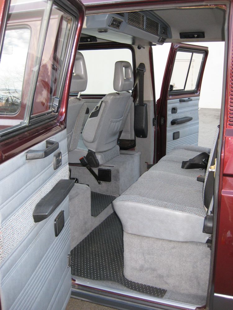

PostPosted: Thu Jul 09, 2009 10:00 pm    Post subject: Reply with quote
i had one istalled in my tristar. i painted it gray, but it was originally beige. it works really well, a little loud - but well worth it! i have to keep it on the lowest setting because it can make the interior really cold!
here are some pictures:
good luck with whichever you choose!

PostPosted: Sat Jul 11, 2009 3:41 am    Post subject: Reply with quote
EwokPoacher , Thank you for the pics. Awesome. I can't see the hoses anywhere, clean install. How is the plumbing routed. I will definately persue that option over the Behr. This was what I needed.

PostPosted: Sat Jul 11, 2009 10:10 am    Post subject: Reply with quote
the hoses are routed thru the b-pillars on both sides. really tight fit but well worth the effort for a clean look. the only problem is that these overhead a/c units are very hard to come by.
