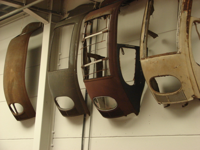

PostPosted: Fri Aug 14, 2009 7:18 pm    Post subject: Reply with quote
A pic taken at BBT. We see the difference in size.
