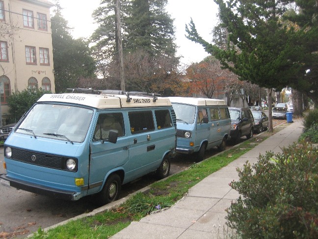

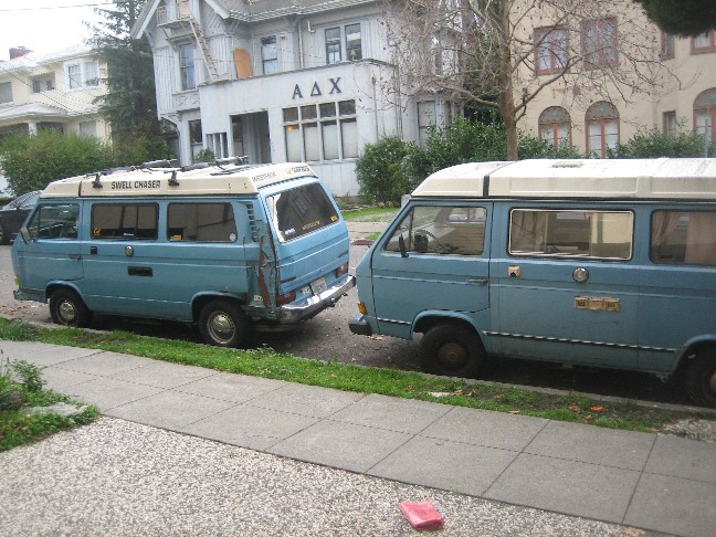

Old van tinted windows; newer van not tinted
