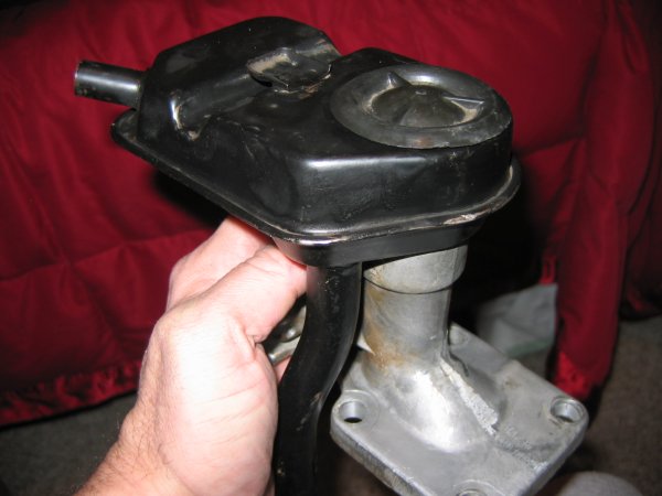

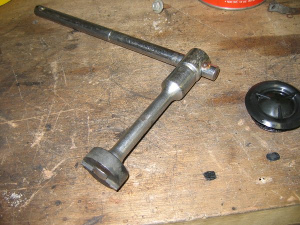

I am blasting and painting all the tin going onto my engine before assembly.
How do I take this apart? I really don't want to break or damage that round plastic cap looking thing.

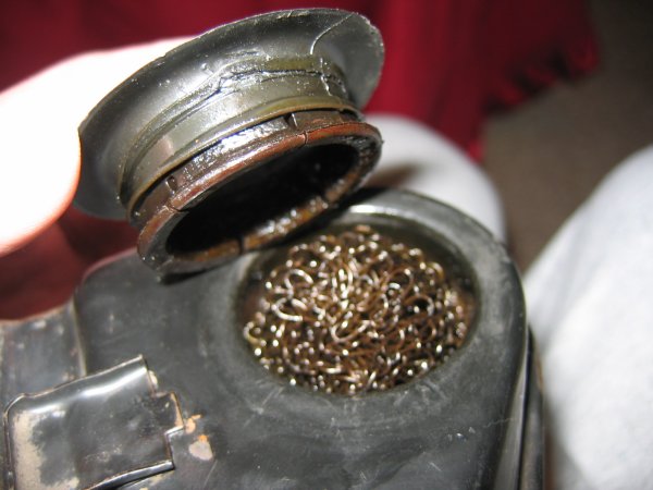

Pull the plastic cap off then remove the screen/mesh then send me your address I will loan you the tool that you will need to unscrew the top from the stand. PM me

Does the cap come straight off or does it need to turn? I tried prying lightly with a screw-driver, but I didn't want to break the cap.

A 1 inch internal pipe wrench.

i just use a piece of 12g sheet metal sheared to the right width about 4"long. tighten a cresent to it and go to town.

Here it is

I have a 1" pipe easy out that I use to get them apart.
Putting them back together is another thing.

Ok, a little prying with a small screwdriver and the cap came up.

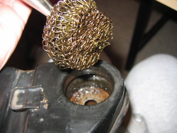

You still have a center sleeve to take out.

And the tool to remove that was sent today. Should be there Monday I hope.

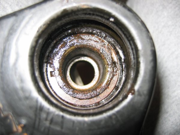

That sleeve is in there pretty good. Needle-nose pliers aren't moving it.

Internal pipe wrench is all I use.

OK, is there some trick to getting that sleeve out? I can get on it with needle-nose pliers, but it ain't a-movin'.

Same type of snap ring pliers that you take the snap ring off the crankshaft.
Duckbills are what some people call them.
