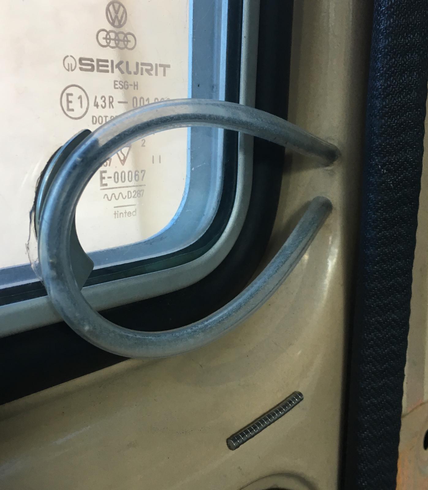

You should do what I did:
A short length of 1/16th aircraft cable from the hardware store, run through a piece of vinyl tube, makes a nice two finger loop for pulling the door closed gently.
I glued onto the window a strong flat magnet salvaged from a laptop sized hard disk to keep the cable from popping out and getting folded backwards as you close the door:
The backside is crimped with the aluminum ferrules also from the hardware store:
Its important to maintain some tension on the cable as you smash the last ferrule in order to keep the loop rigid. After some use the cable may rotate into a bad position, at which time you can reposition them properly then glue the ferrules into place so as to keep the cable pressing against the magnet.
This is great because you not only pull the door closed easily but also inward to the latch. No slamming required!
See this page for more:
https://www.thesamba.com/vw/forum/viewtopic.php?p=7670385
