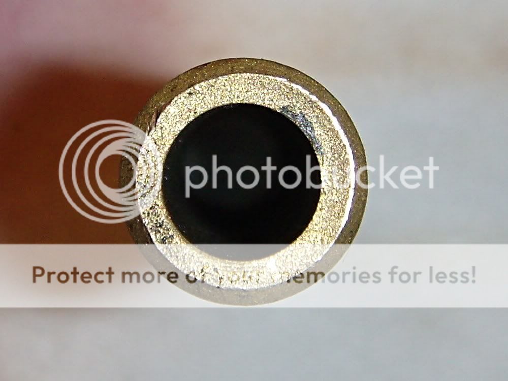

Valve Guide
A bit hard to tell from the photo but the ID and OD are not concentric.

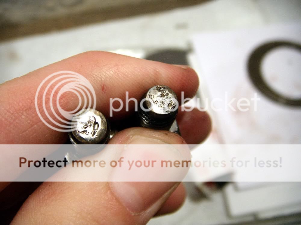

Lash Adjusters.
Seriously, check these things out. There's no way this occurred in 12k miles.
