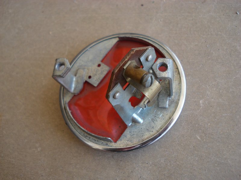

These taillights

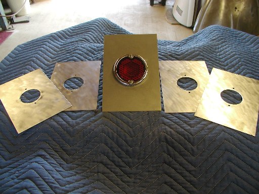

You can also look at the holes for your taillights, if they are not hacked up.
A plain hole would be the European flat taillights.
The later "dollar" taillights have either screw holes or slots for the top and bottom chrome trim screws to pass through the metal corners.
Examples:
Replacement holes with screw holes, used on the Buses with the "dollar" taillights first:
Later Buses with dollar taillights had slots:
