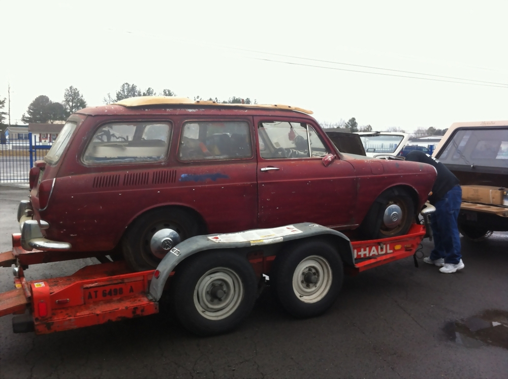

This is my "build" thread. I can't really do the resto my car needs at this point, but I want to drive her none the less. So, I am going to clean her up and patch what I can to save her life and make her a good useable car again.
in the begining... there are pics.
at her new home. she is all original 1969 except for the respray of red and the hood. hood poped up on me and tore at the hinges bending the hinges.

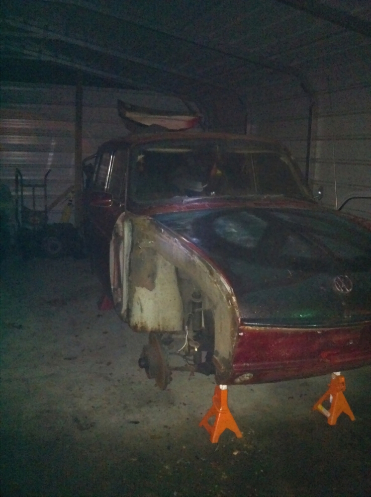

and after a short thrashing last night she looks like this... I will get a better pic.
I will have better pics as I progress. this is basically going to be a refresh. the small rust I have I am welding up, but the pass floor pan is in poor shape and needs protection and reinforcing so fiberglass it is. Later I plan to do a proper body off restoral with pan replacement, but this will give her a few more years.
I got lucky and the fuel did not gel after 7 years of sitting. the tranny does not feel so lucky though. I will pull it and the driver front fender tonight.
