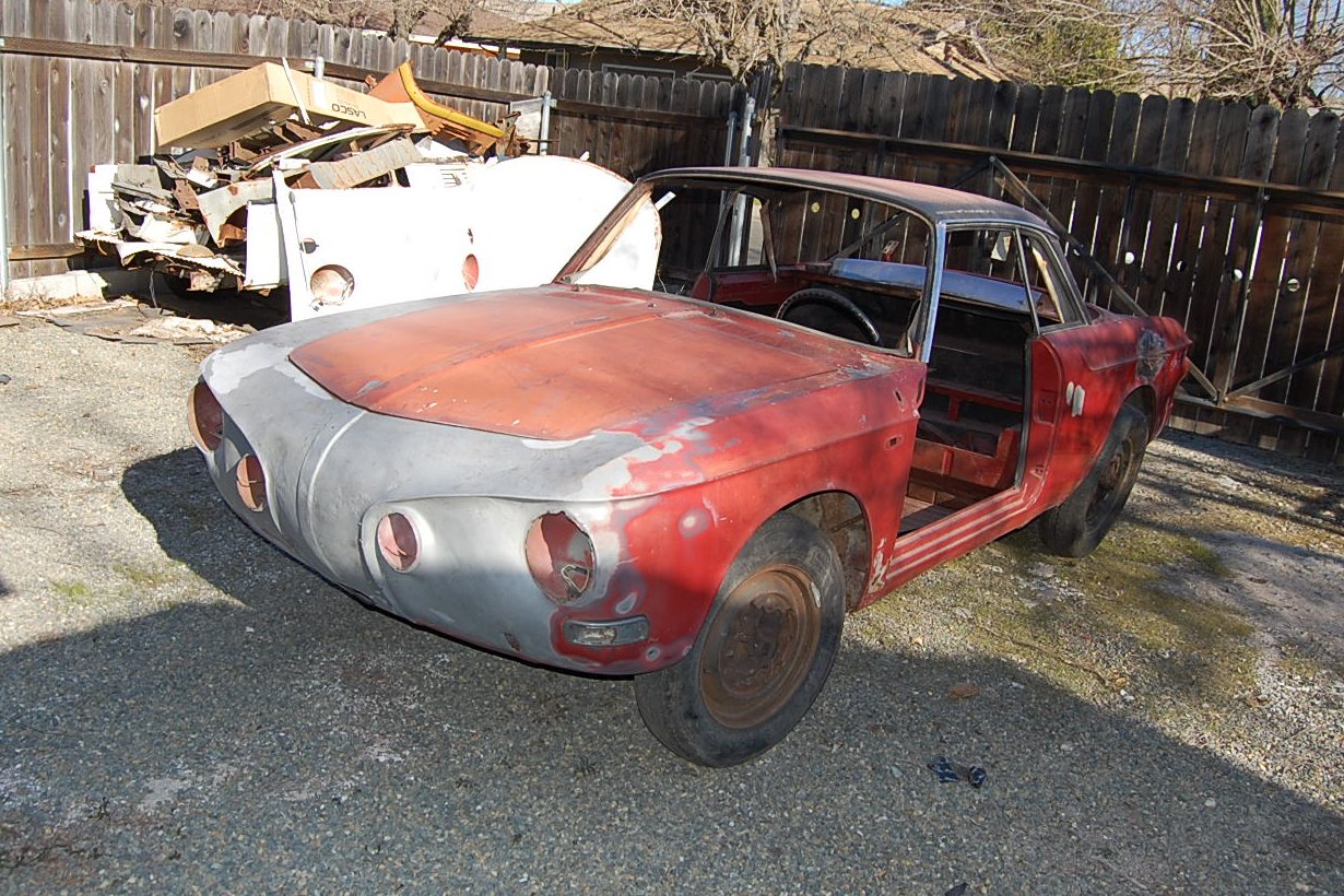

This car was originally pulled out of a junkyard in Fairfield in 1998 by Larry Edson & Richard Troy. Larry had collected a zillion parts for it over the years, a lot of them NOS, but finally decided it was time to let it go.
Here's a picture with Richard Troy following the forklift out of the yard.

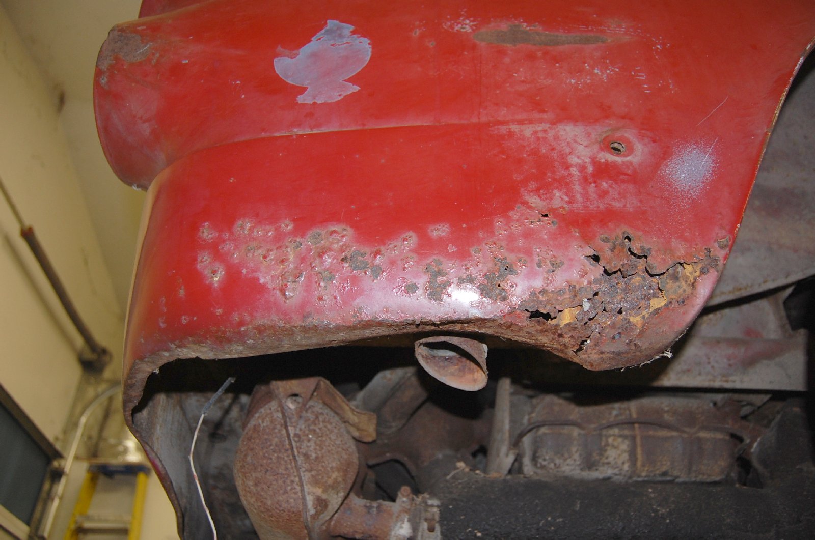

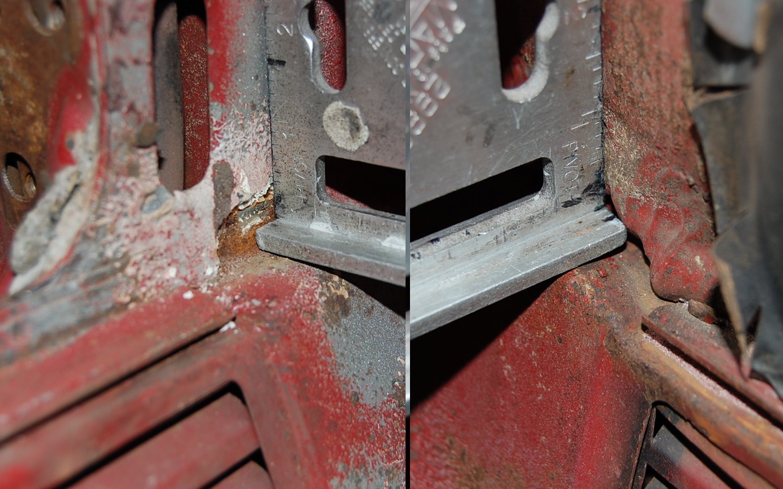

Initial evaluation:

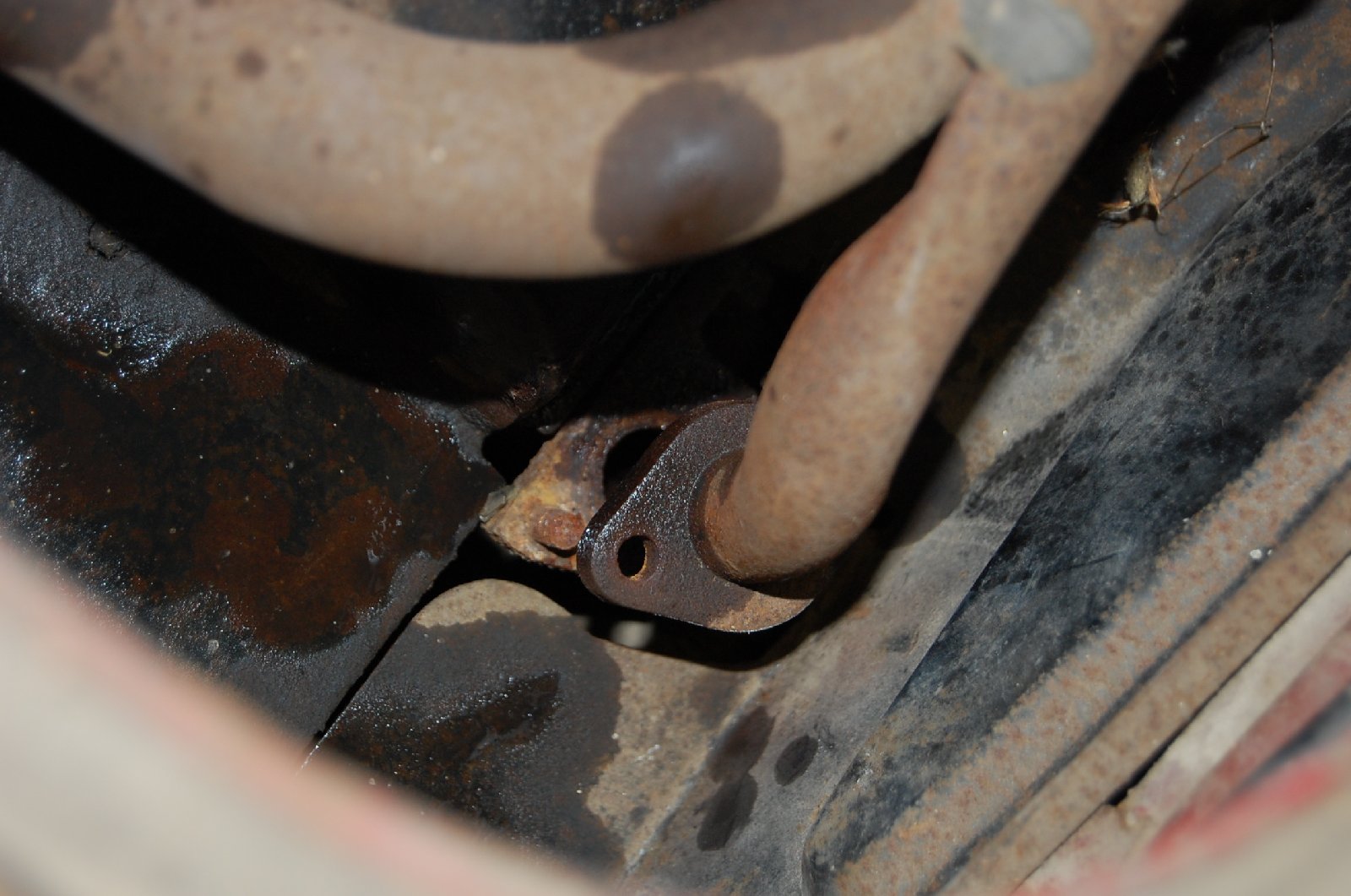

The little thermostat dealy has been nicked
Started digging out some of the bondo
Taking a good hard look at some of the damage

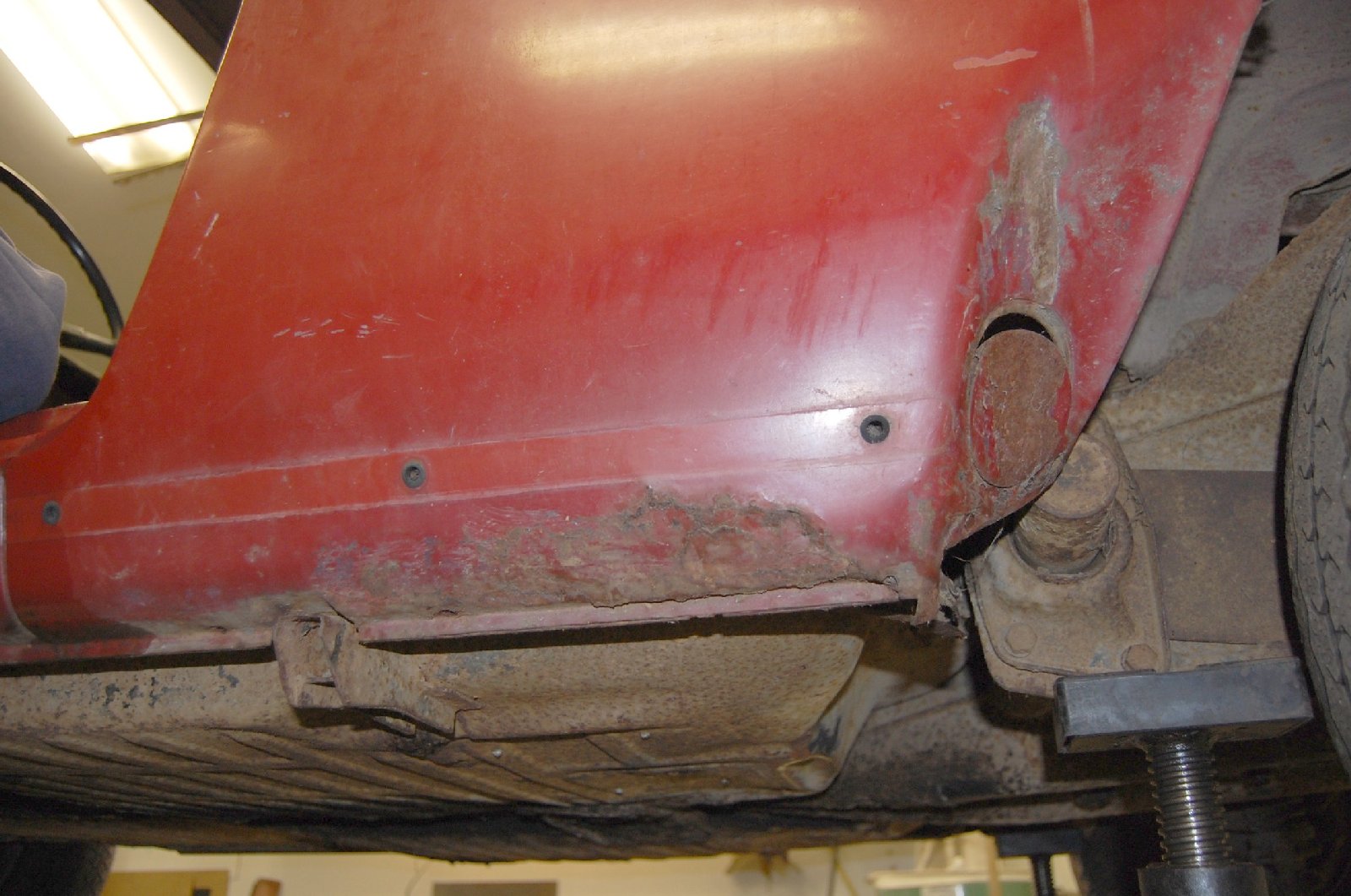

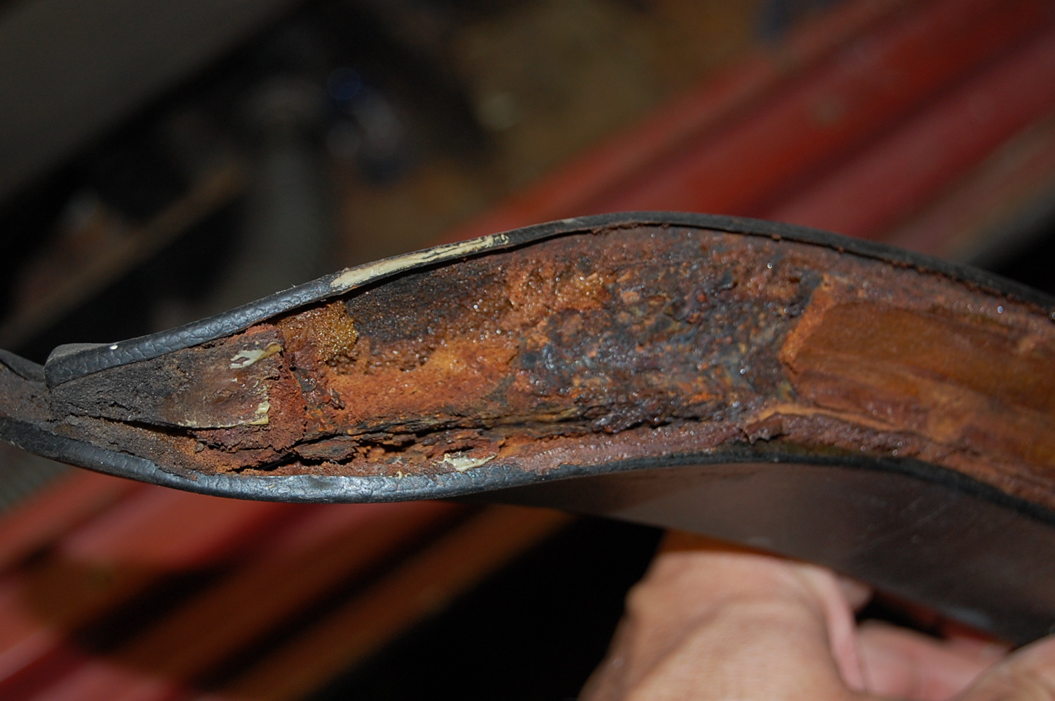

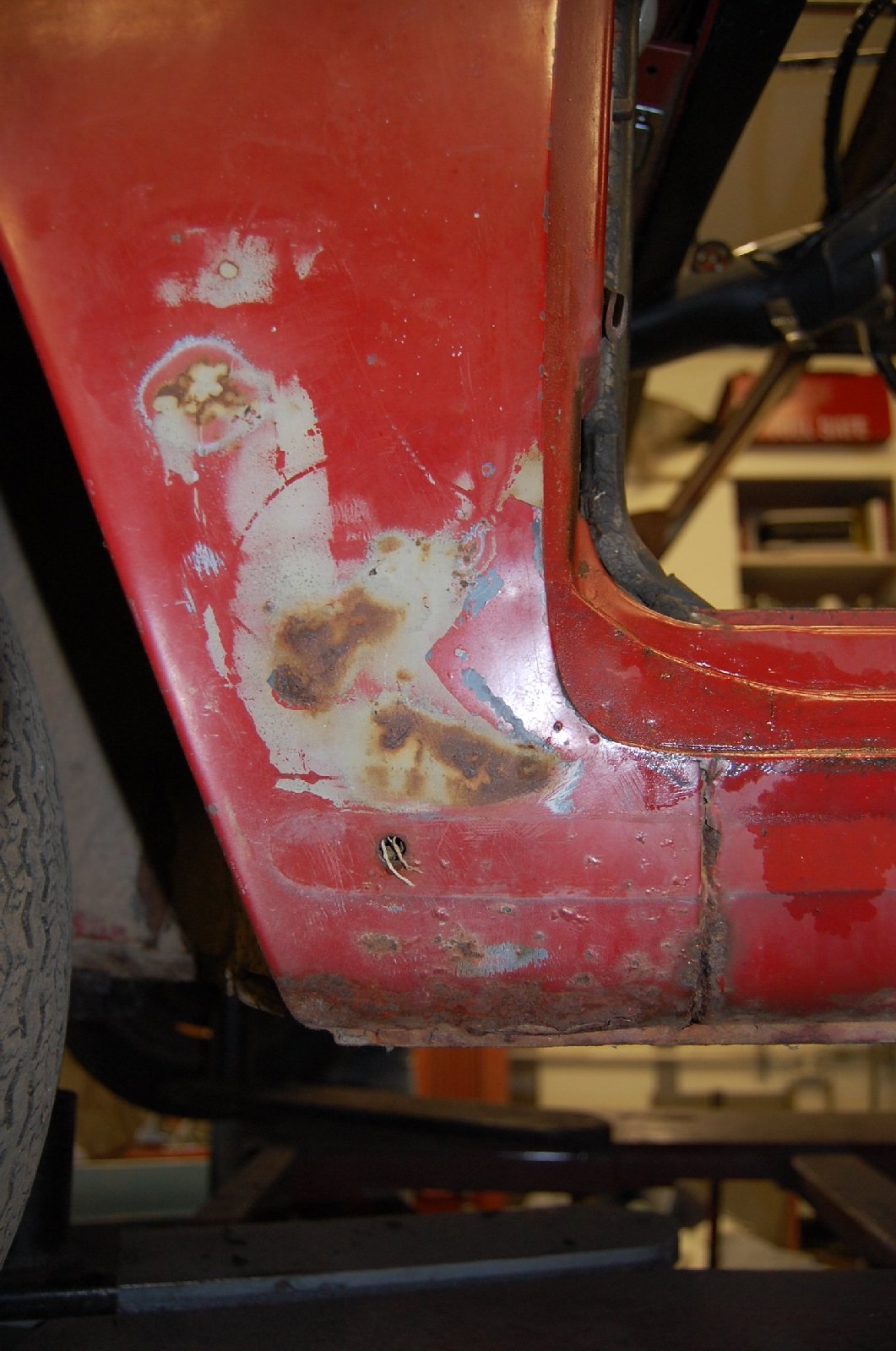

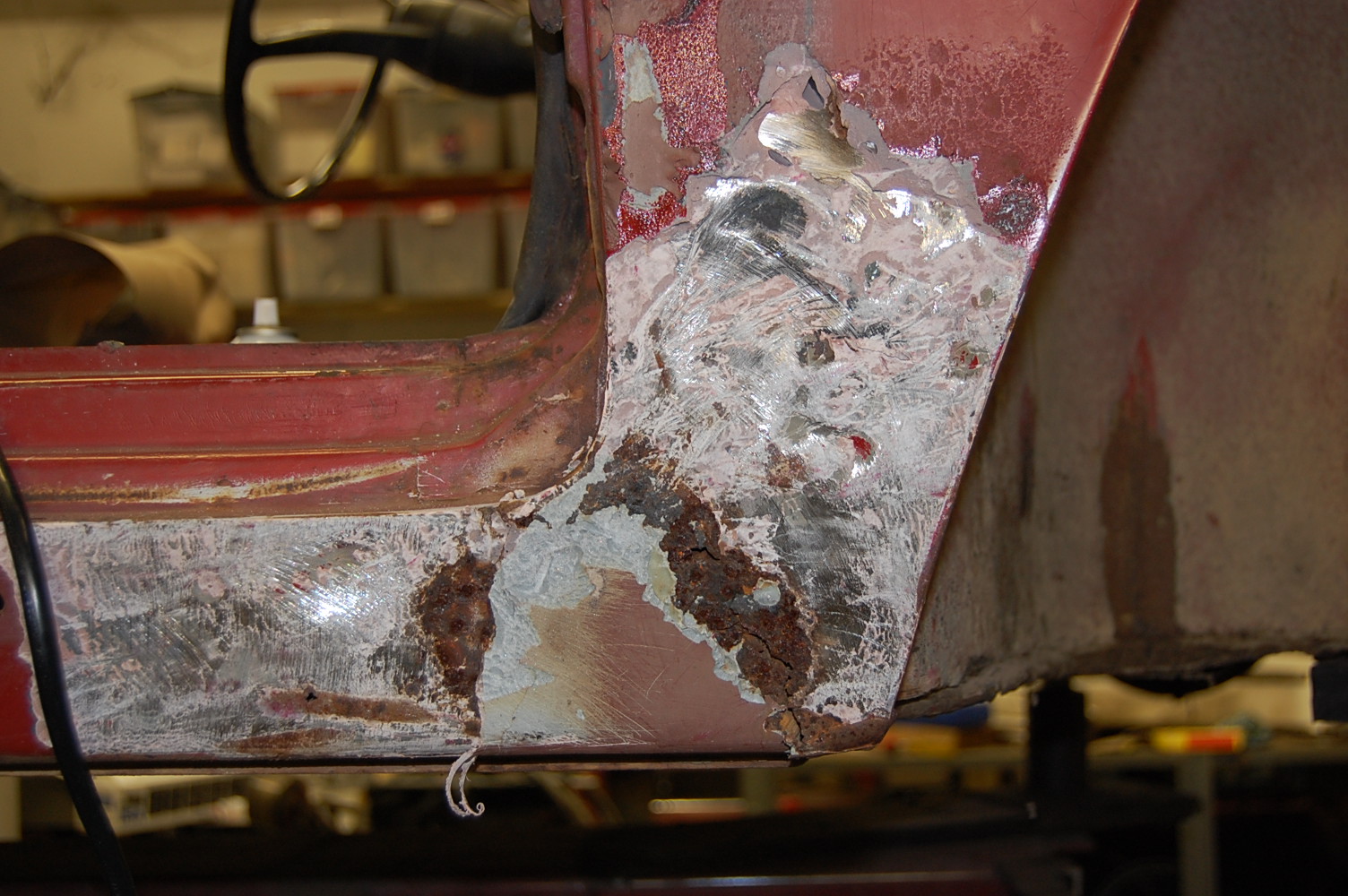

Doesn't look too bad; there's a little bit of rust, but I knew that when I bought the car.
Hmm. It's a little worse than I thought
Holy mother of god, that's a lot of bondo! It was over 1/2" thick in places.
What's even better is the dark grey stuff at the bottom isn't bondo. I was heating it and it wouldn't budge, and it smelled really bad, but familiar. It's JB-Weld!.
We're gonna need a bigger repair piece.
-Thom

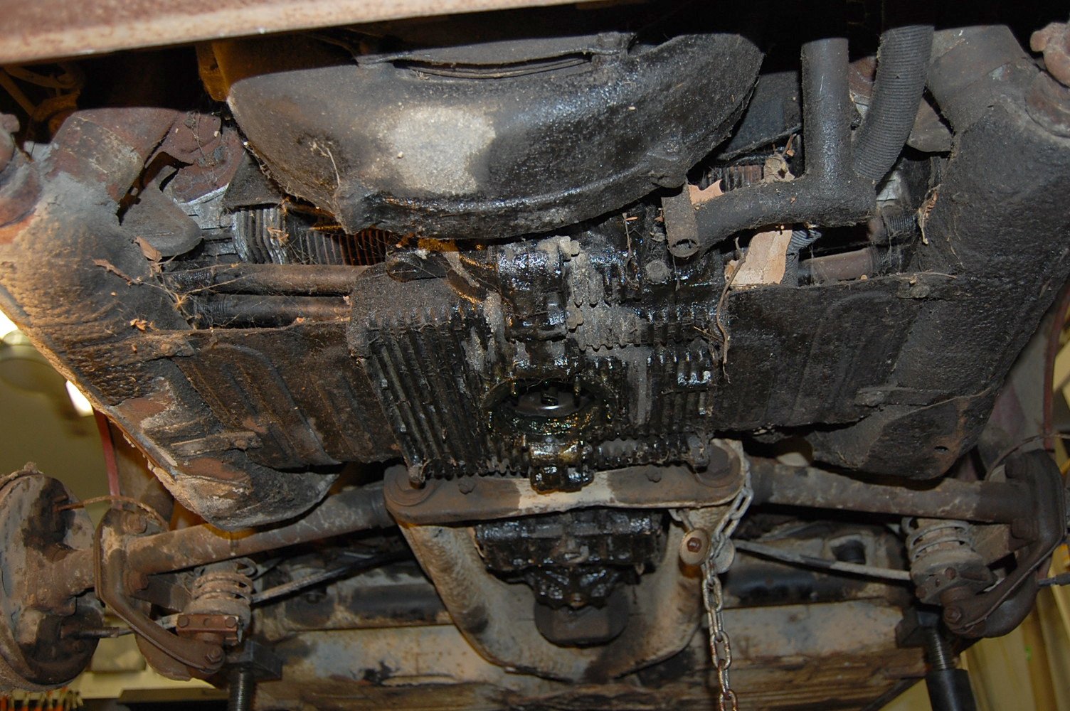

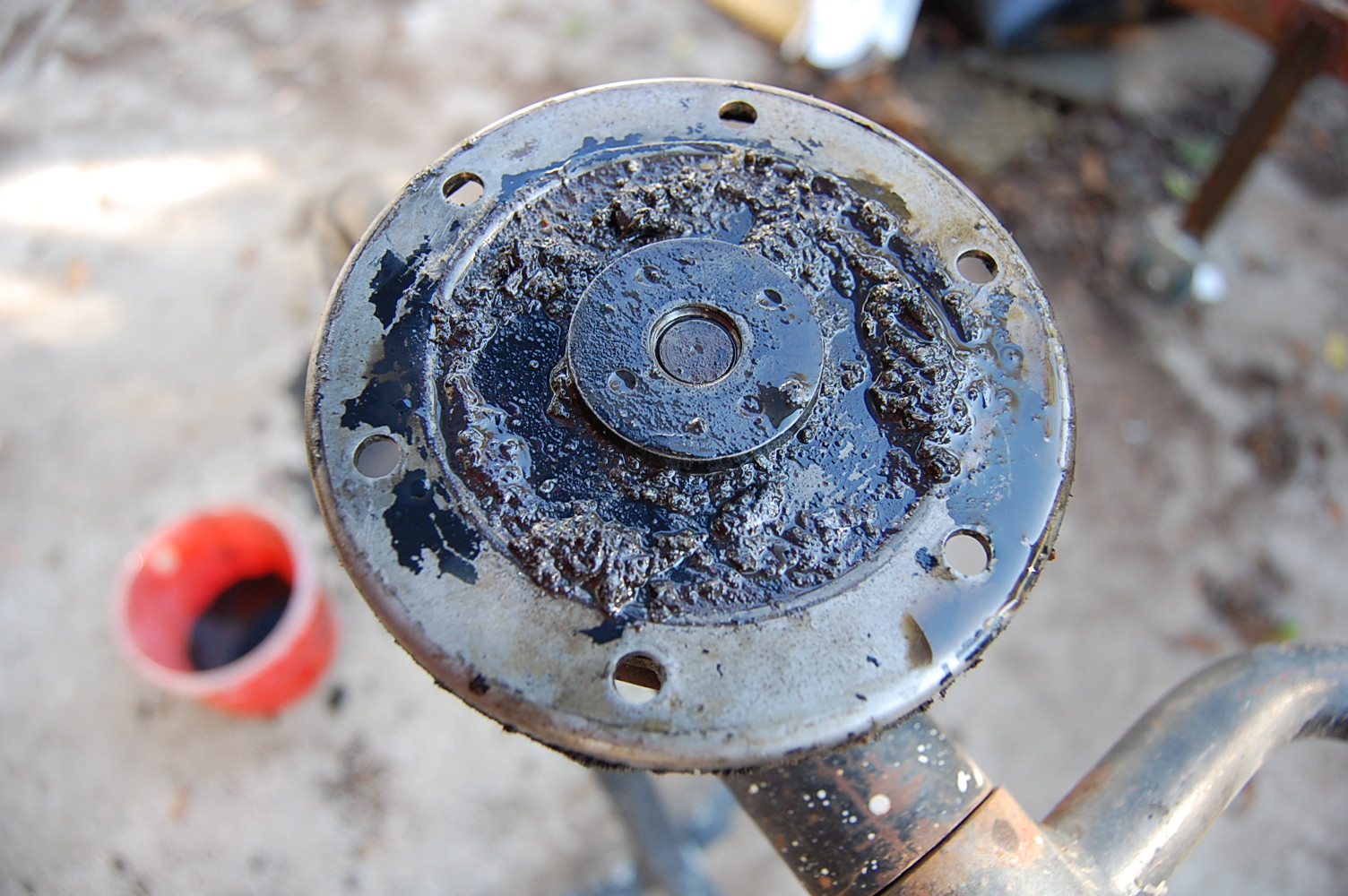

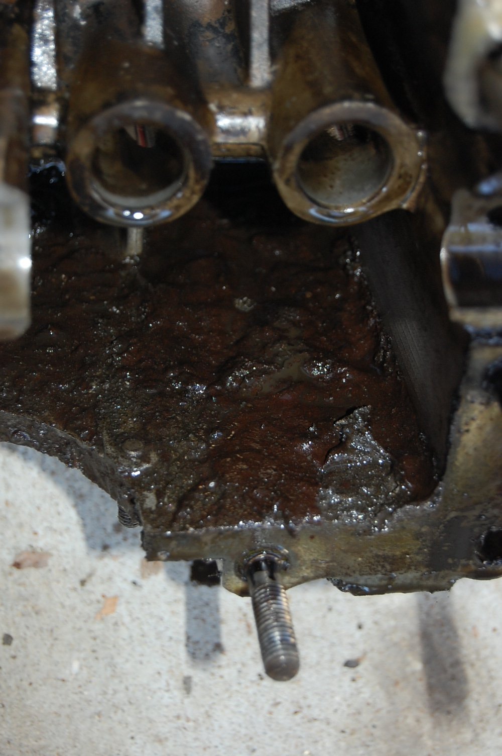

I pulled the oil sump plate. Ick. Lots of chunks, but it seems to be petrified dirt; the chunks crush easily in my fingers. I don't think I'm going to be able to just jump in and drive this one.

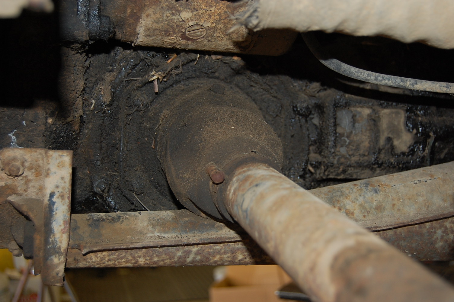

Here's something you don't see every day - original, solid axle boots. They've more than likely never been changed

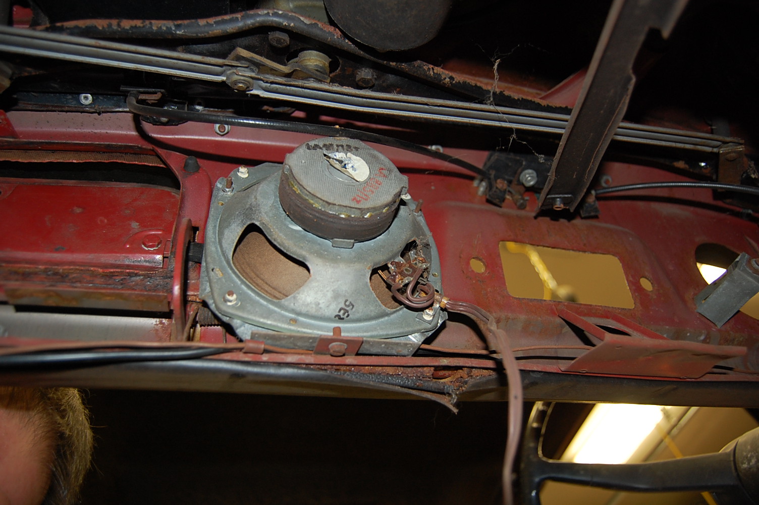

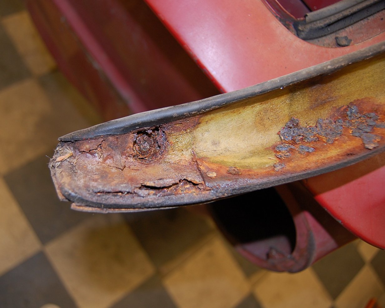

Further dismantling of my T34. Trying to get the dash pads off was trying at best. I pre-soaked the fasteners with penetrating oil, took a small brush and cleaned the threads as well as I could reach, knowing that too much torque would rip the stud right out. I'm trying to be super-surgical-careful, but all of the studs on the top pad were turning. I lifted gently upwards, and the entire thing popped off in two pieces. Judging by the oxidation of the foam, it's been in two pieces for quite a while, and it looks like the studs shuffled off this mortal coil decades ago. The dash also has a rich Corinthian leather overlay which has been fun to peel off.

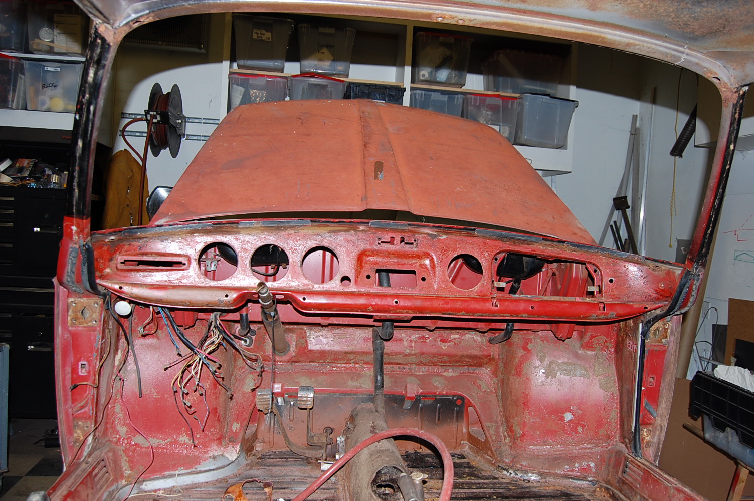

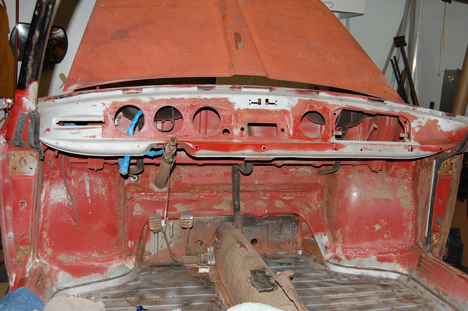

Disassembled the rest of the dash over the past couple of days. When the weather clears up, I'll blast some of the problem areas.

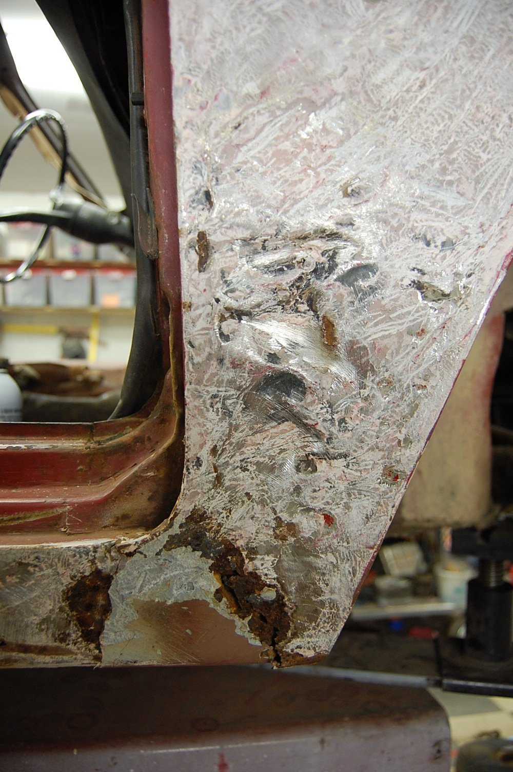

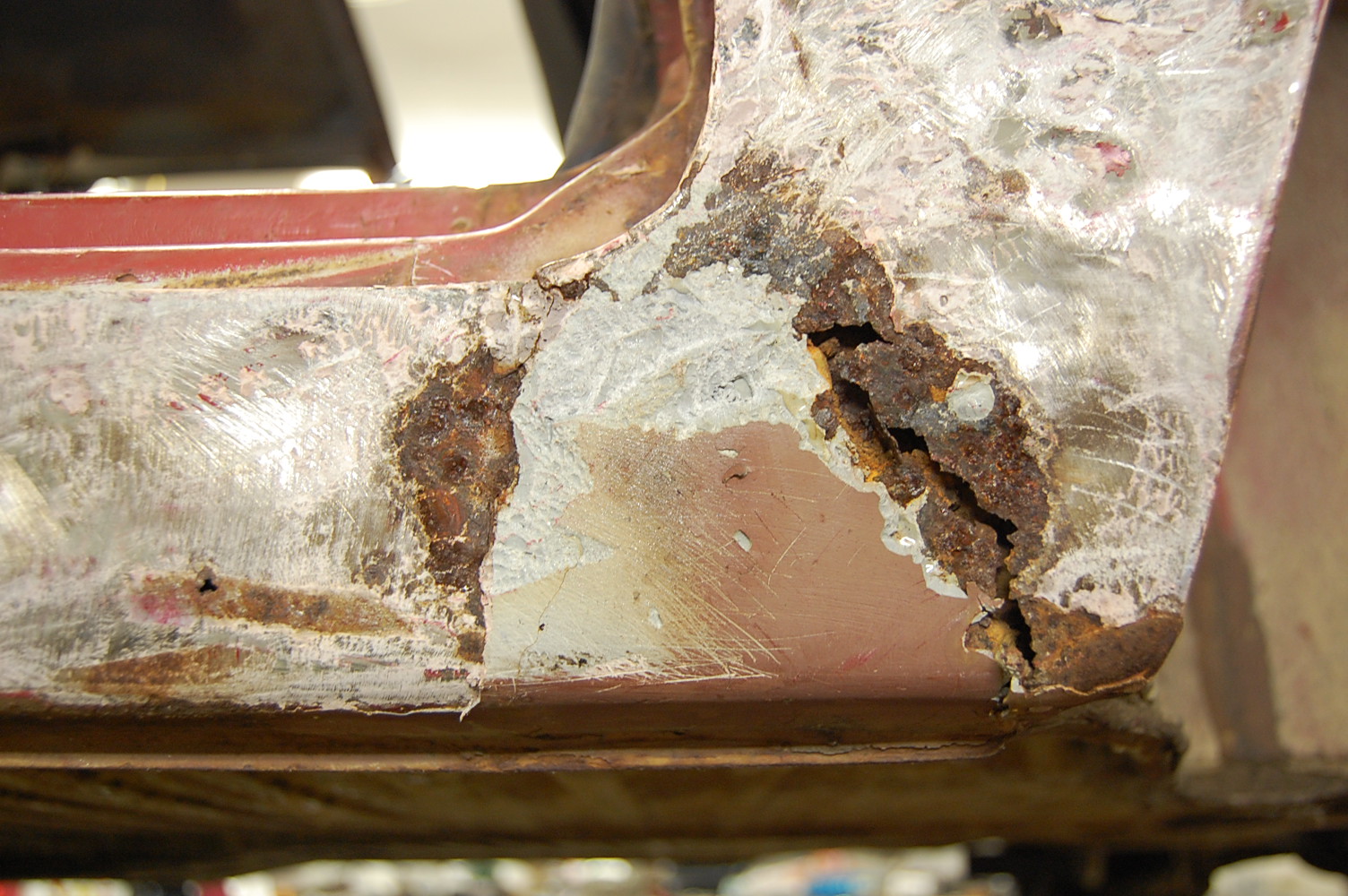

Did some more blasting today. Looks like I'm going to need to section in a good-sized chunk of the passenger-side floor pan.
-Thom

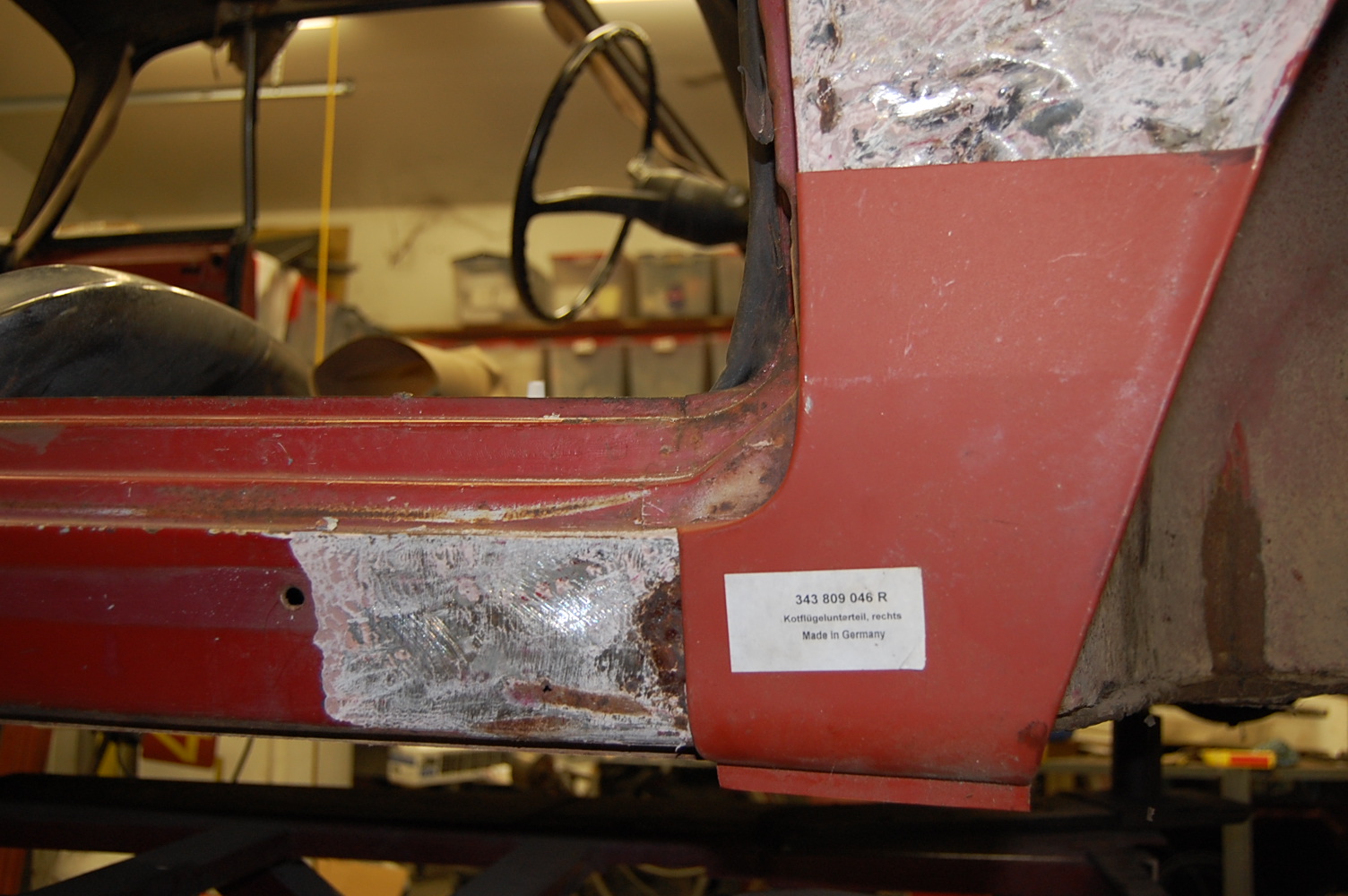

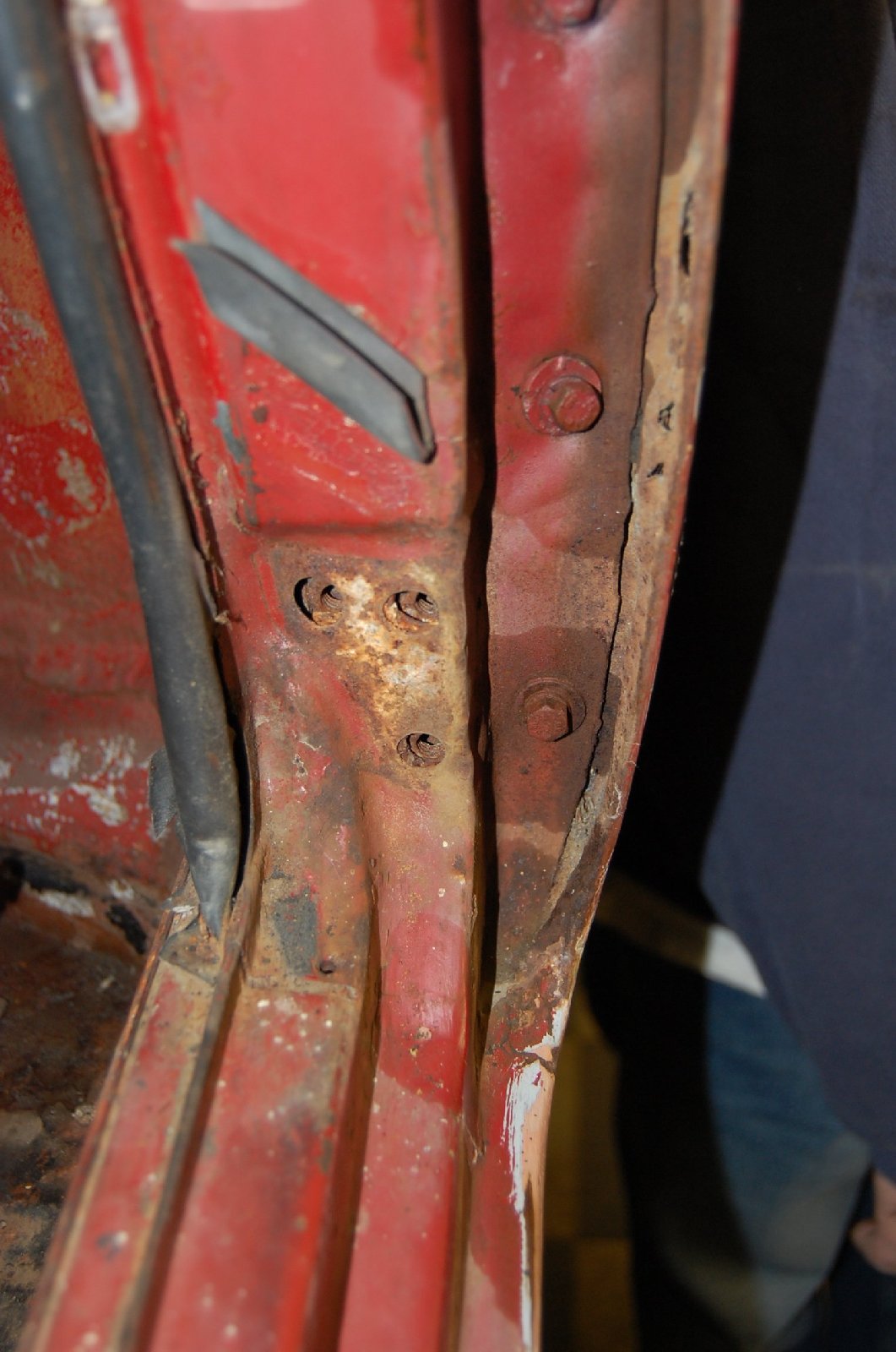

Pushed out my passenger-side B pillar a little. I need to straighten out the inner structure so the fender can go back where it is supposed to be. I could really use a new section, as this one is pretty hammered. I have one of the repro sections, but that won't begin to cover it.

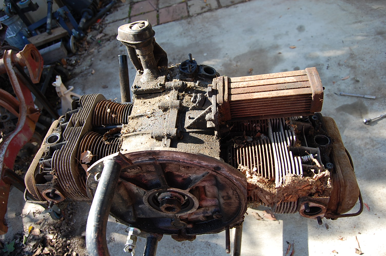

Got my engine torn most of the way down.

I've cleaned the heads up a little bit, and found some trauma from a previous life. My guess is they either sucked a valve or some other FOD.
