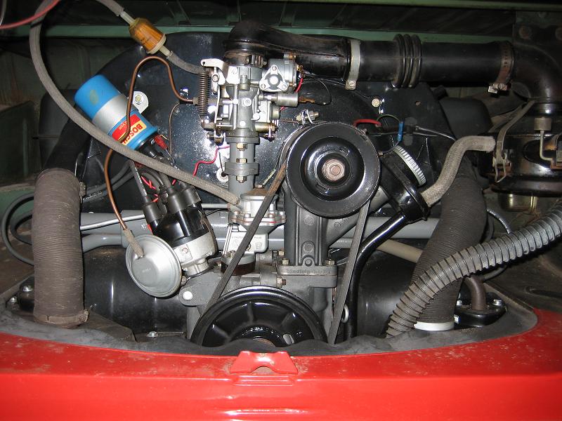

More pictures.
The engine shot is during the fuel system sorting phase of the operation, so go easy on my goofy little filter and its location and lack of clamps. Very Happy
In the background you can see that the bus was originally Velvet Green.
I did not take a lot of pictures while sorting out the carb. Sorry for that. More to come.

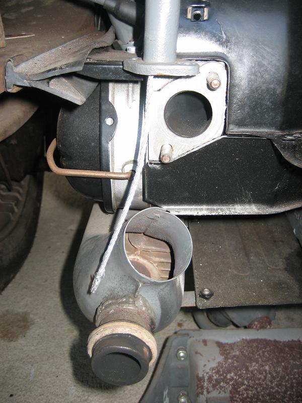

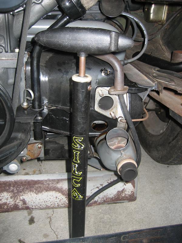

PostPosted: Mon Apr 02, 2012 12:59 pm    Post subject: Heat Riser clearing Reply with quote
I'm having a bad case of the frosty carb, so I looked into the heat risers, and sure enough, the right side riser was discolored from heat, and the left side is cool to the touch. Strange, in that the engine has been gone through recently. Maybe there is somebody living in there...
...anyway, I went to the auto parts store and picked up an automatic transmission selector cable for a full size truck, clipped off one of the proprietary ends, and used the other hex shaped end as a bit for the drill. Using a heavy leather glove on my left hand and a deft throttle finger on the drill I got the cable to peek out the other side.
Left
Right
I ran the cable out and stuck it in the left side and fished it out the right for good measure.
Then, I stuffed the rubber hose from the beheaded Silca bicycle pump up in the right side and gave the pump a few toots and blew the carbon bits out the riser, chimney style.
The whole process wasn't very difficult compared to some stories I've heard, but I didn't expect to have to do this at all what with the engine being reasonably fresh. Either way, solved now. Very Happy
