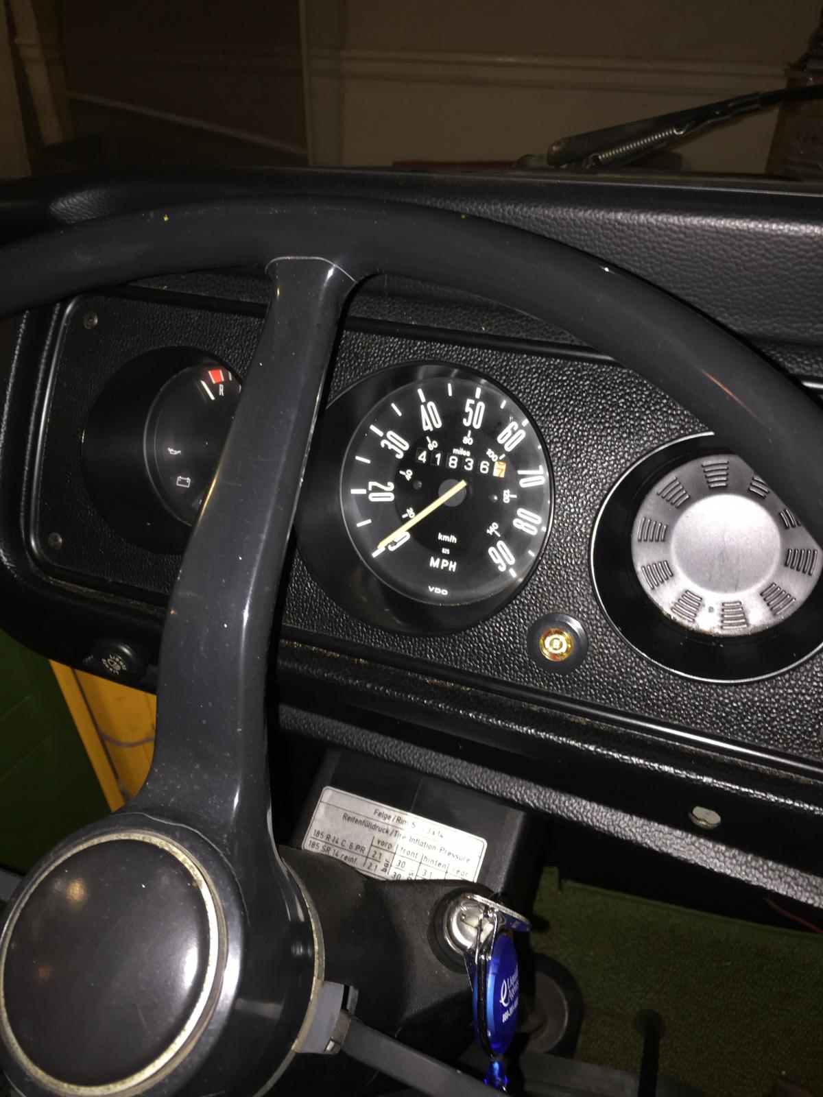

All the replies are incredible - much appreciate the advice on qualified folks and especially on what to NOT do.
I fly to Atlanta on Friday evening so will get pictures up soon. No idea what asking price would be - that comes after the initial assessment.

FWIW, please don't sell it as 50K miles unless you can verify the number. If the odometer says 50k its probably 150 or 250.
With that said, if it's truly 50k and rust free congrats on your great find!

The front seats are actually a fairly decent indicator of mileage. Not as good as well documented receipts and registration history, but still can help. Make sure to get good pictures of them and the entire interior.
x2!
Its smart to look at the pedals too. Are the rubbers on them still grooved, or are they tattered to shit, worn down, with the steel portion of the pedal arm showing through? If so, it ain't no 50K. More like 150 or 250K lol

Turns out I was wrong about the mileage.... 41,000 original miles. Seats look and feel nearly new, pedal rubber is grooved like it should be. This is a single owner van, and he happens to have paperwork and service records. Woah.
Couple pictures below - it really is in great condition. A few things here and there (small holes in tent, for example) but, man is it cool.
Cleaning it now - will post pictures later.
