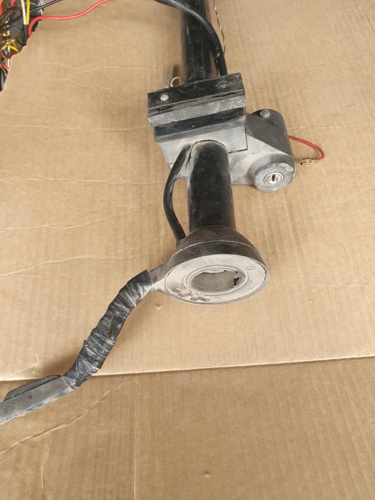

Under the dashboard the early model column bolts up simply in a rubber damped sandwich of plates and rubber pads.

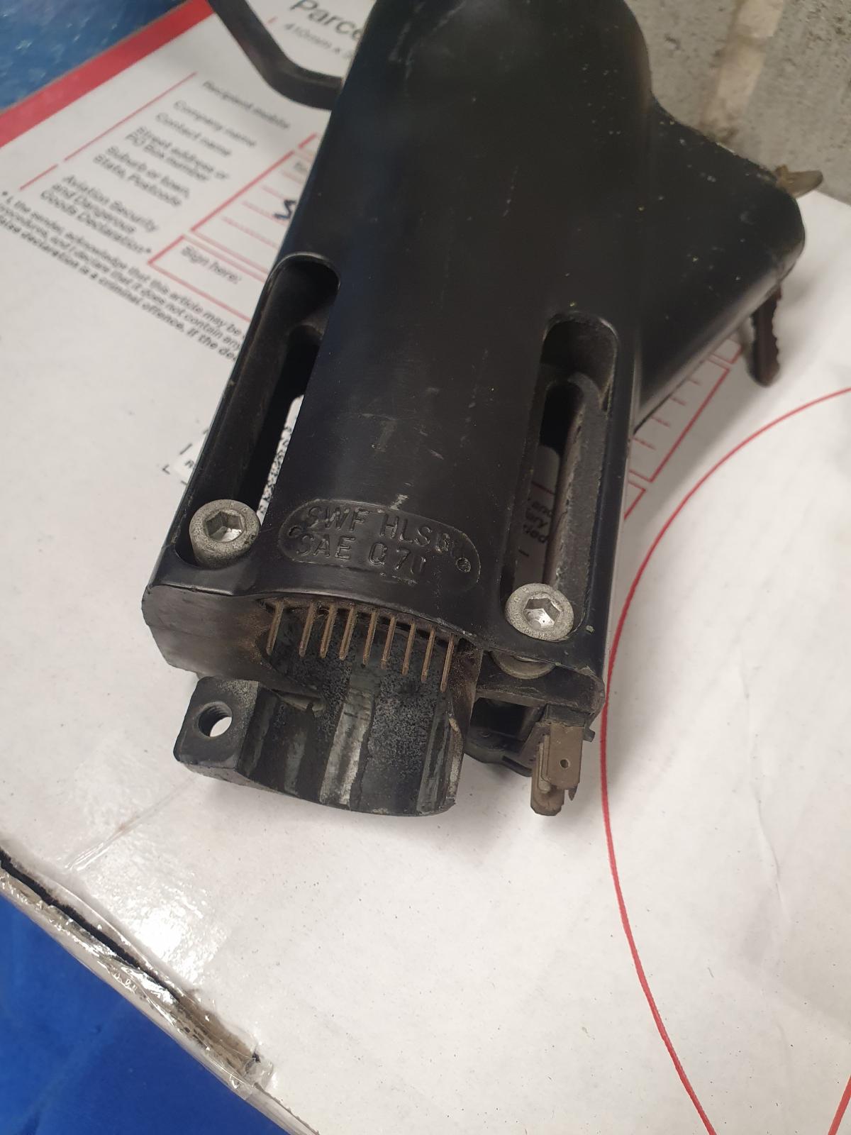

This one here with the electrical tape holding the lever together is my original column.

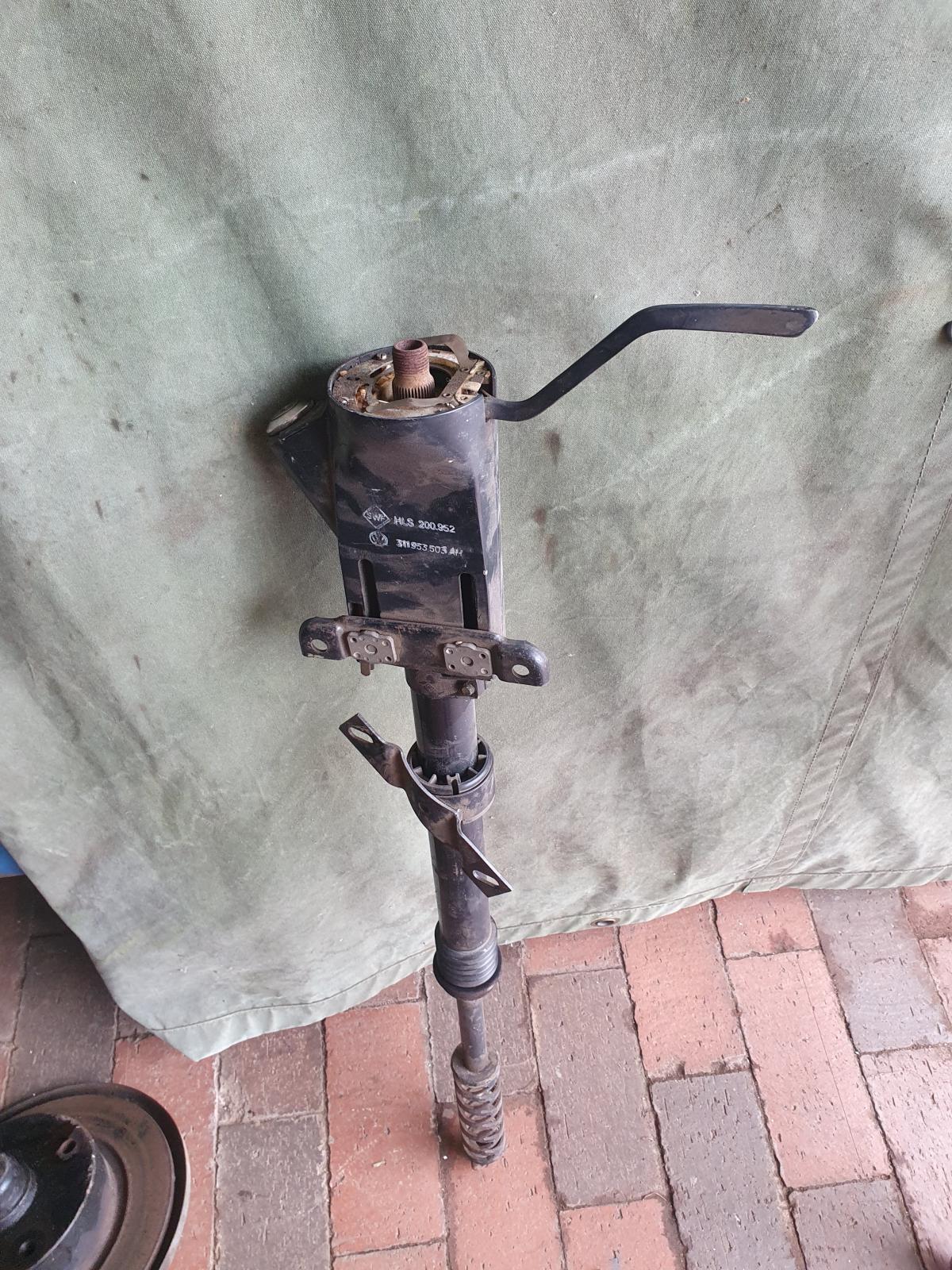

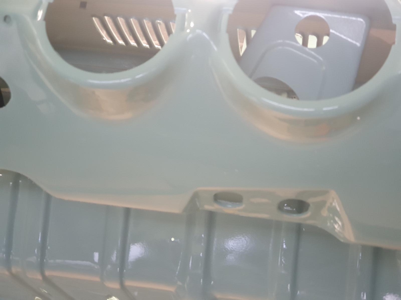

But a late model column seems to have wider mounts with a crash protection sliding mount which I assume might also break away from the dashboard in a sever crash.
Can anyone confirm what the metal attachment point looks like on a late model dashboard? Can you confirm if this style ignition key clamshell structure will mount under an early model dashboard?
(Ignore the broken clamp. Just using this pic for illustration)

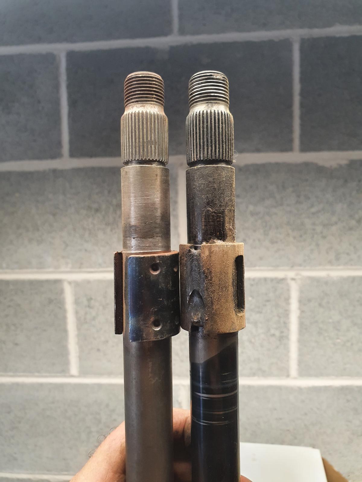

If that can't be used I considered inserting the collapsible steerer in the old housing. This gives you a medium level of protection with just the perforated metal crumple tube near the steering box but no break away mounts under the dashboard.
One problem I ran into immediately when inserting the new steerer is the difference in length between the circlip groove and the metal collar welded on the shaft. The new one is about 3mm shorter.
Has anyone here done this style of conversion? How did you get around the differences.?
Is there a better year model column assembly for this upgrade? I feel going from a 66 model to post 70 model column is too much of a leap.

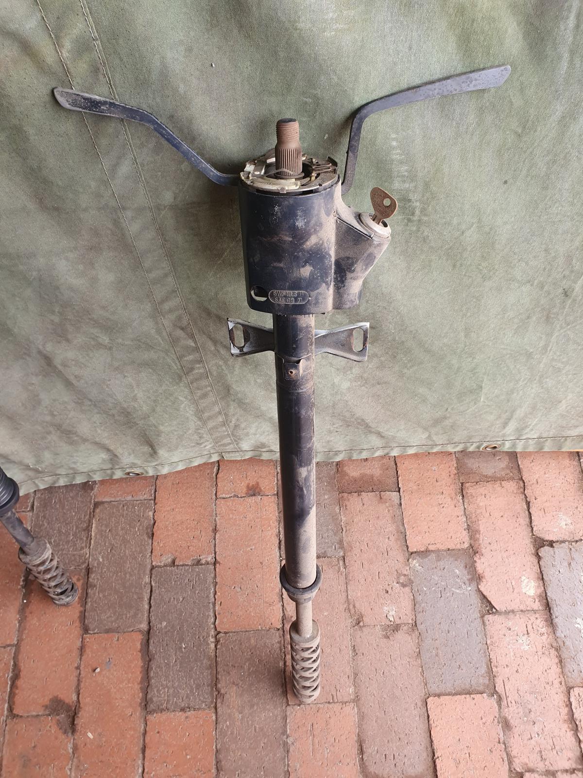

Old left - New right.

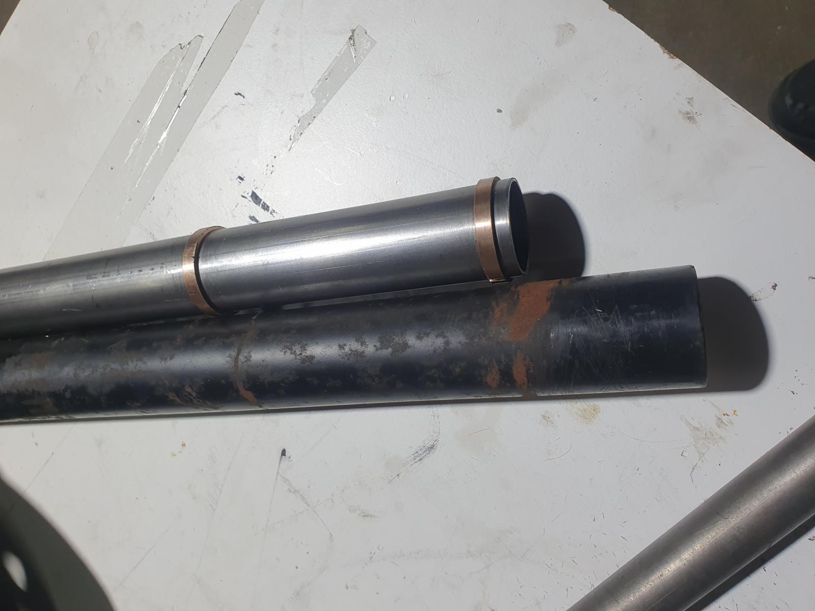

So here are the two collapsible style columns that I've seen but I'm not sure if there were any more. Pretty sure they both came out of long nose type 3's.
I heard that a collapsible column came out as early as 1968. I would like to see an example of that because these 2 below have quite wide mounting bolt holes and would not bolt up to an early dashboard.

Well, I've got a late (71) set up in my 65. It's a mix of years though. What I did was split the metal support bracket that holds the "shear nuts" so I could bolt it up to the dash, due to the wider spacing of the later style. Splitting the rubber at the dash side also allowed it to bolt up and help set the column head in place around the bolt holes. I used the collapsible column shaft (a 71 unit) at the steering box, and the longer 65 tube on the inside of the body (from the hole in the front wall) rearward to the column head to make up the empty space. The reason for doing it that way was to keep air flow from the front from passing directly into the car (plugged the hole). I did have to add some flat washers between the column head and the rubber spacers to drop the column down a little more for my preference in steering position. My plan was to machine some aluminum blocks to replace the washers and rubber blocks combo, but I never got around to it.
At the time I did all of this, I didn't know if it would work, as I hadn't heard of anyone doing it before. I also don't know if that would pass your mechanics certificate or not, but I've been using it since 1999-2000 when I built the car.
I believe your early Aussie built set up is based on the type 1 stuff other than the column lock. Nick (Ninja) ended up adding an Aussie lock to a bug column for his 65 Notch, basically creating what you have, as he wanted to get away from the fragile early type 3 lock and ignition switch that the German cars came with. I went with what I did for similar reasons (ease of parts replacement, except I screwed up and used a 1 year only set up (not planned)). I'd try to find a 68-70 German unit (column head) if I were to do it again.

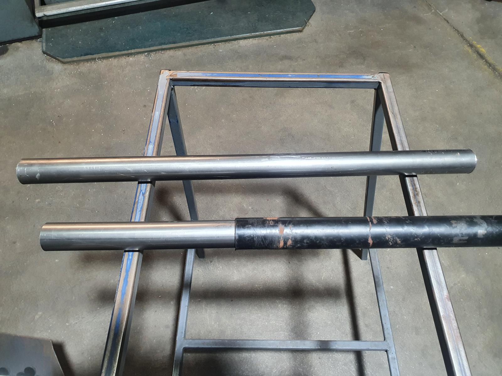

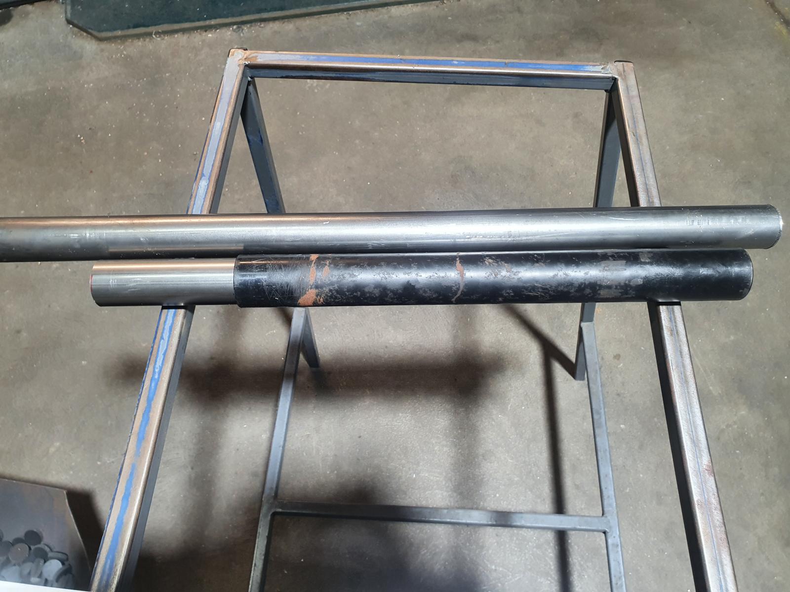

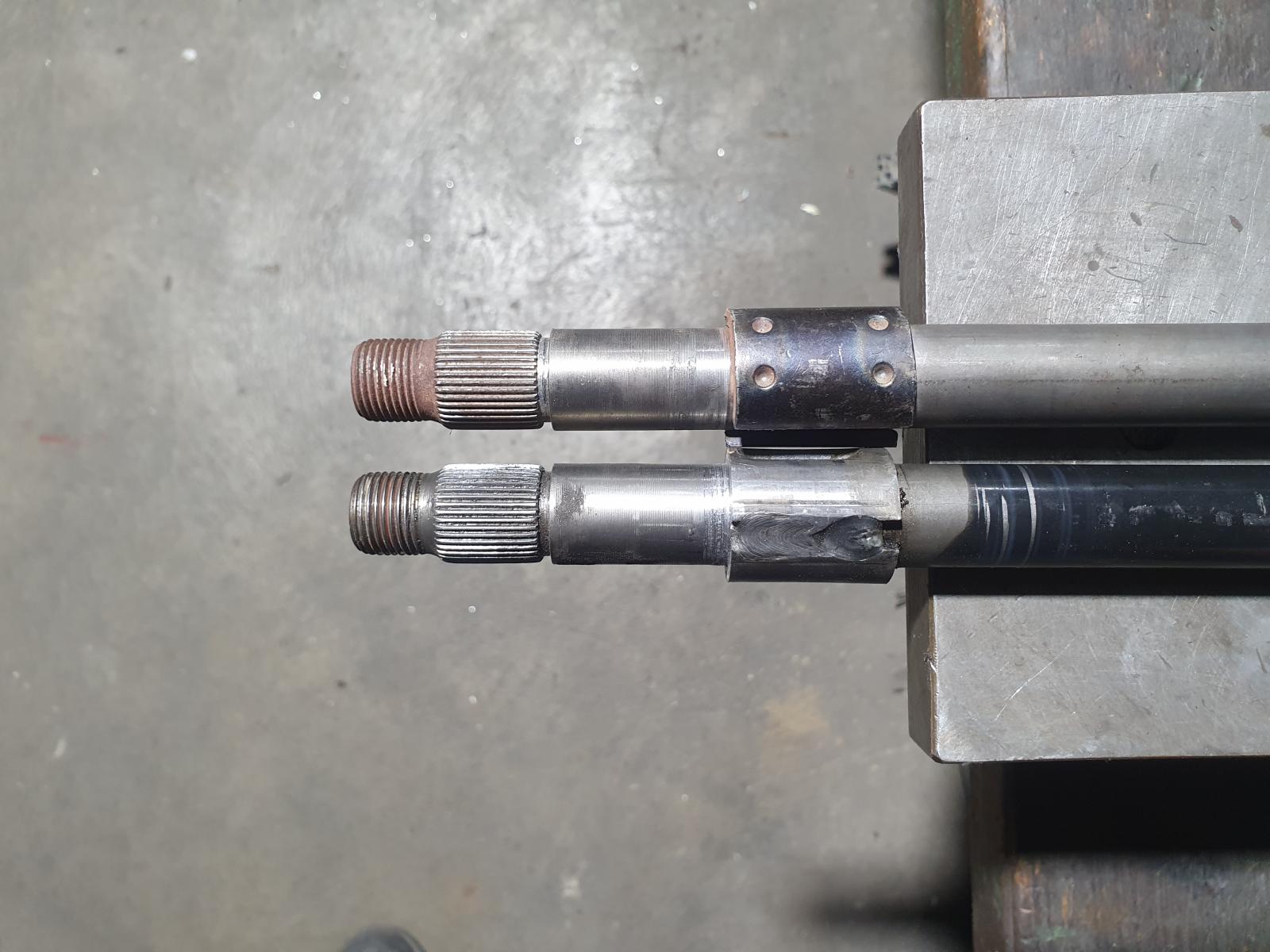

More on this mini project.

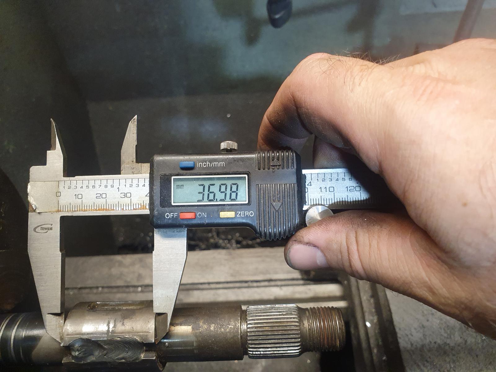

Measuring the minimum of what I needed to get the collapsible shaft working in the early housing there was exactly 4mm difference between the circlip ring and lock/bearing stop collar.
Turned it down on the lathe.
Started at 37mm. Finished at 33mm.
They are even now.

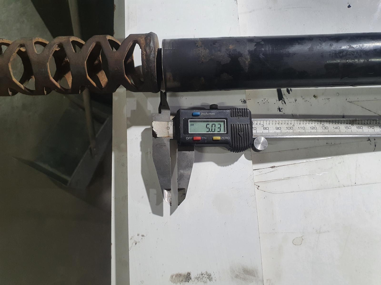

The perforated tube section was now bottoming on the outer tube that runs up under the dash so I nipped 8mm off the end of the tube. There was about 10mm sticking out of the firewall under the fuel tank so I figured 8mm would be ok.
This left me 5mm of gap between the outer tube and the perforated section of shaft.
Going to fit it on the car again and see if that's enough clearance. I need to see if there's any allowance for fore/aft movement in the rubber mounts under the dash.

Here's what I've done so far.
I bought some 35mm erw 1.6mm tubing. I turned two 6mm by approx .4mm deep grooves.
Next I made some 38mm OD bronze bushes and split them so they'd stretch over the tube and snap into the groove. The black outer tube is the original late model housing which is already shortened to that length. If this all fails I still have my un-cut original outer tube that will work as a non telescopic unit.
Pics or it didn't happen. I'll update once I test fit in the car.
