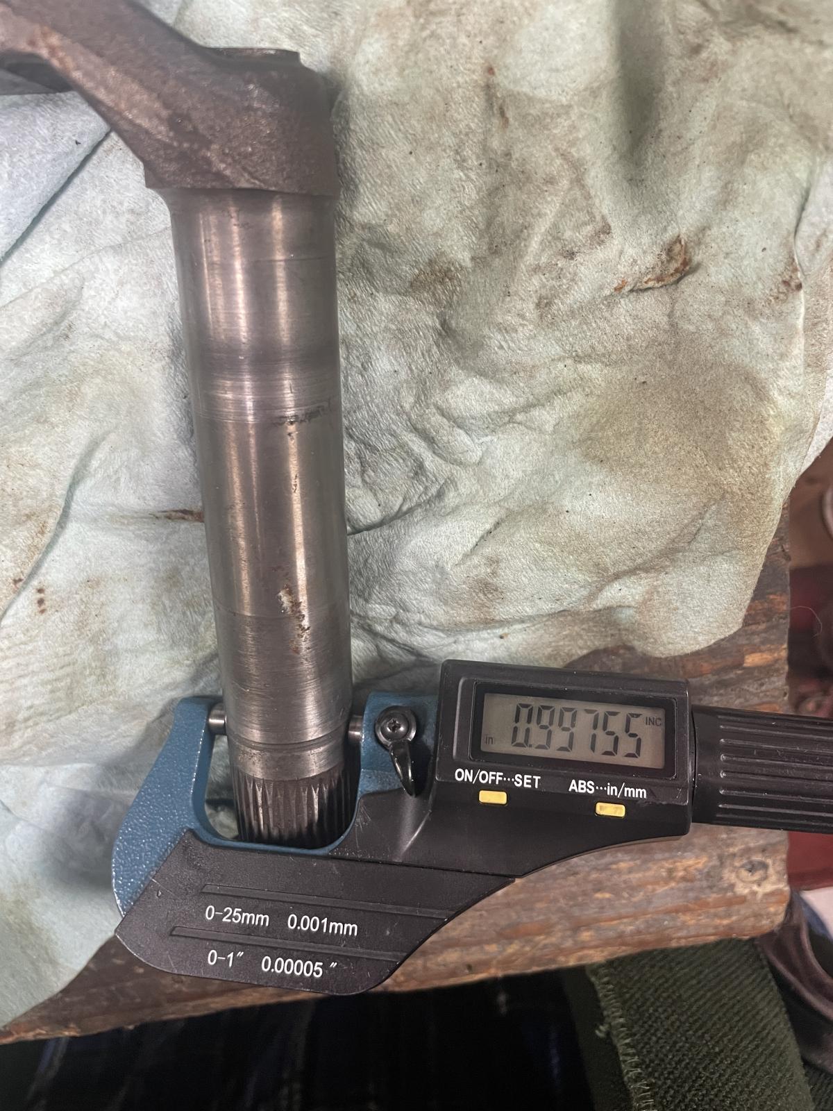

PostPosted: Fri Jan 03, 2025 4:01 pm    Post subject: Re: Rebuilding OE Steering Boxes in 2025 Reply with quote
chrisflstf wrote:
Anybody know what is the standard id of the bushings? To know what size adjustable reamer to buy.
I just measured a shaft I have sitting around - keep in mind, your shaft may have more or less wear than the next guy - that's why you ream to fit your shaft. (and if you clean up damage to your shaft, it'll be smaller still...)
...david - '66 SO-44 #231
