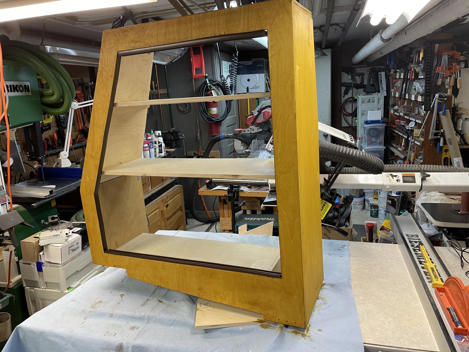

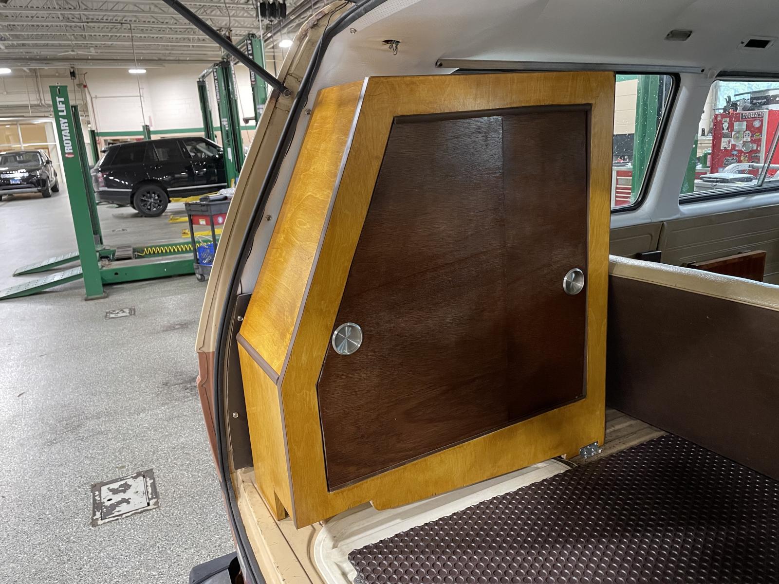

I built mine version of the Weekender Cabinet, attaches to the cargo floor with 2 small L-brackets and screws. Then, I used 1 upper mounting bolt, through the side of the cabinet, to the Unused Seat Belt Threaded Nut that's welded into the side of the Vanagon, on either side for 2nd row shoulder belts or other belt system.
I've seen a few Weekender Cabinets for sale here on Samba from time to time, along with the longer Westy Cabinet, but if you have your heart set on a Factory version, it's cheaper and easier to pick one up at the Seller's location vs having it shipped.
Pictures of the cabinet process I went through. I elected to use Sliding Doors on ours, so loads don't need to be move out of the way for normal/stock swinging/hinged cabinet doors if you've loaded the back end with stuff and you want to access something in the Cabinet quickly.
You might be able to see the floor bracket at the front in the installed picture, but the other one is a bit hidden under the rear of the cabinet, onto the floor, away from the engine access cover by a few inches. I can always take more pictures if you're curious, esp the large bolt in the middle of the cabinet side that ties to the body for real anchoring strength.
