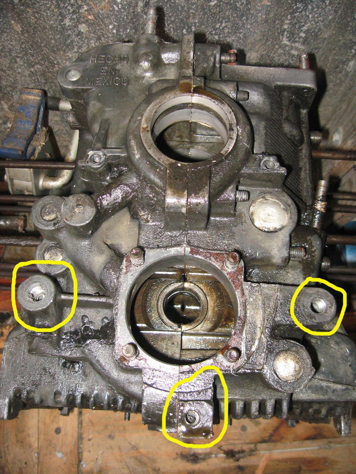

If you get a type 1 engine be sure it's got the 3 holes in the case for the Bay Window VW Bus Mustache Bar!

Thought I was more clear. A Bug case will not fit into a Bay Window Bus. But a Bay window bus case will fit into a bug. The reason is that the Bay window bus case has a special 3 point rear mount provision that the bug case is missing.
See the first photo:
Now someone is going to come along now and say you can just use an adaptor, to make a bug case fit the bay window bus and it would be this Beetle to Bus Engine Mount Adapter but you still need the Mustache Bar and I would not think the Engine adapters are very good. Probably make your oil pump leak and you could not put any kind of better oil pump in or full flow cover etc with it on there.
This is an interesting thread here: Installing a type 1 (upright cooling) engine in a 72+ bus
Bus Case: A universal case will fit a Bus too because it has these 3 mount holes.
A Bug Case: Note the missing Mount holes.
