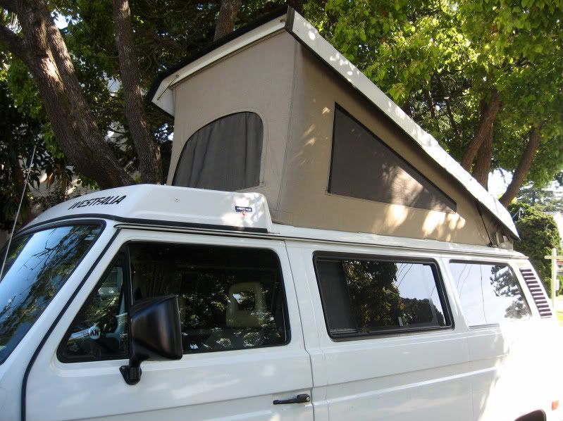

I am curious to know which manufacturer's canvas tents fit the best? I have a 3 window and a stock tent, and the 3 window (not sure where it is from) sags a bit down inside from the roof. The OEM seems to be a much better fit.
Does anyone have an opinion on which manufacturer has the tightest and most stock fit to their tents?

Tent topics, and there a ton of them:
http://www.thesamba.com/vw/forum/search.php?search...=titleonly
(I was going to lock this thread, but as someone pointed out in one of those above, we need to have one definitive synopsis topic covering all available replacement tents, complete with photos and pros/cons of each. This thread will be that topic.)
Notes:
1) USA vendor links go to their home pages; be sure to order a tent for your van's year, or pop-top type.
2) The following tents are compared to each other; i.e., the new tents' characteristics are NOT being compared to the original tent.
3) A common statement about the acrylic/synthetic tent is "stiffer fabric; harder to stow neatly". False! Acrylic is quite pliable and, as you can see from the interior shots below, despite being thicker fabric, stows just as well as the original tent.
German OEM cotton-polyester canvas:
Pros:
Good durability
Excellent breathability
Water resistant
Thin fabric (easy to stow)
Made by original Westfalia tent supplier in Germany; keeps your camper looking original, even with 3 windows
Tight fitting, just like original
Removable/replaceable front window screen
Windows: 1 or 3 (depends on supplier); side windows are zippered, front window is zippered & Velcro'd
Cons:
Not mildew resistant
Thin fabric (can lead to draftiness)
Easy to puncture or tear, especially as it ages
Two colors: Gray or tan
Price: $300-500
Topics/Reviews:
http://www.thesamba.com/vw/forum/viewtopic.php?t=310345
Vendors:
Bus Depot
Van Café
GoWesty
Günzl Classic Parts
______________________________________________________

You can tighten up your tent by undoing the attachment at the bottom (or top) and pulling it tighter and then reattach. If you look at some of the threads showing pictures of a DIY install you'll see what I mean.

Is it my imagination, an optical illusion, or do some of these tents allow the top to pop higher than others?
Not sure how it could pop higher since on a regular Westy the travel is limited by the articulating lift bar.
Yeah, i knew that, duh. Camera angle.

As a newb canvas installer......
edit: In the process of retro designing and test fitting a given aftermarket tent to a given Westy(ies), is it possible that some were measured against and test fit to Westies with worn pop top arms? Just a thought. In my case the wrinkles et al is most likely due to my hand.
I bought the "German" staple type tent from Vancafe. In spite of my newbness to the job (my first time, top still on van), it seems like a taught fit. Like not much room for error. Like due to my possible slight maladjustment, I see several (NOT many) tiny holes, i.e. near corners of stitches near side windows. I suspect fabric is likely stretched slightly beyond it's design, at certain points, due to imperfections of position of tent where it lays between the fetid plastic strips & wood frame, and, due to the position of the tent at the bottom strips mit der tiny Phillips screws. As I inferred, this likely due to my (former really) newbness. That said....
It is working fine and I don't see those tiny holes getting any larger. This tent should last longer than me or Jaco. However....
Take wear and tear of the pop top arms into account. They do wear. Even some mm's of the upper arm(s) "eating" into the cross bar, may account for differences in tent taughtness. That said...
I ain't no expert!
Neil.

Pic of tent, after late night finish. Note the position of the wrinkles.
