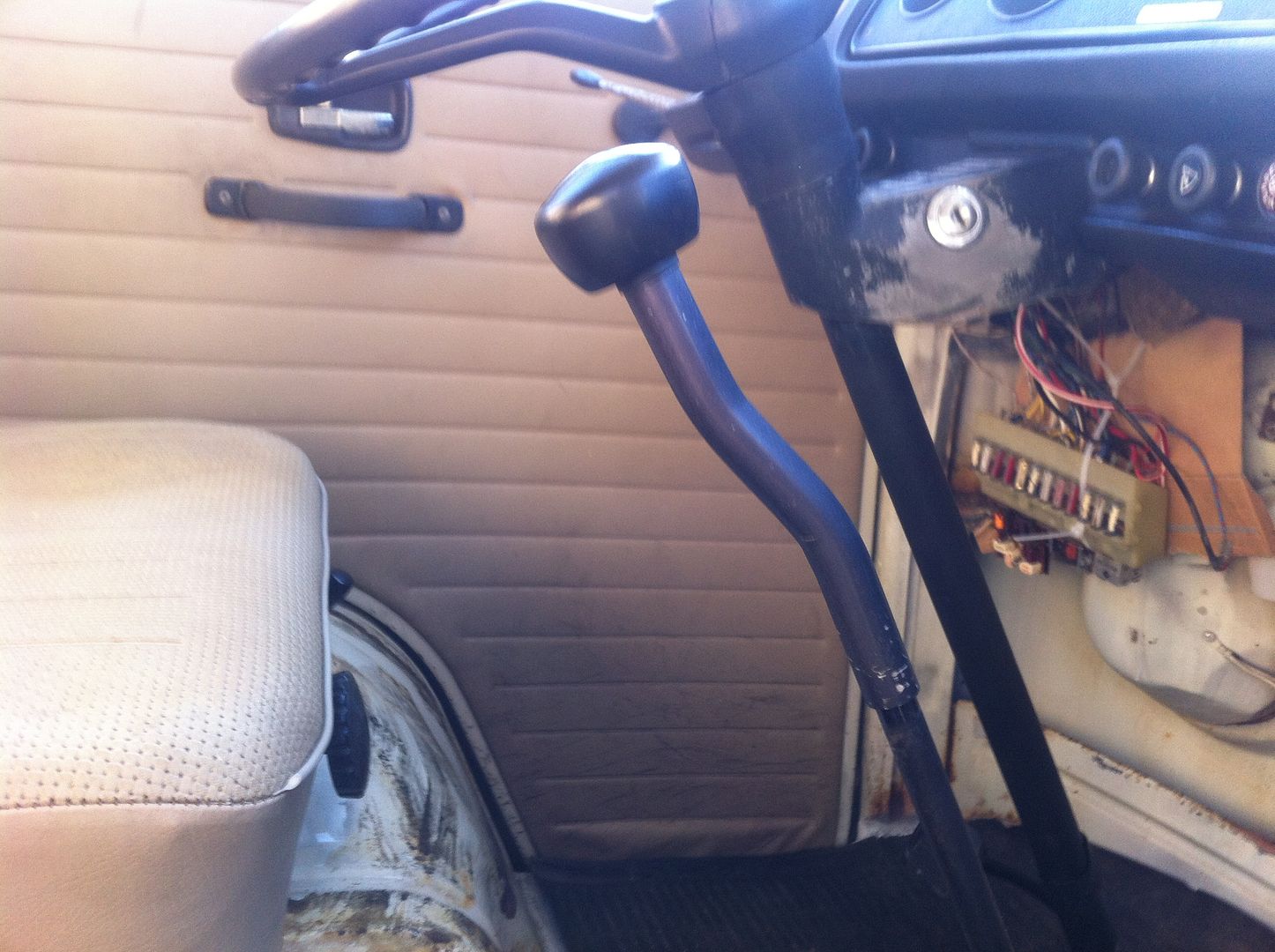

justcruzin is offline
PostPosted: Fri Dec 16, 2011 5:32 pm    Post subject: Reply with quote
Yep, that's the same location mine is at, currently! LOL
I found it was easier to get it out from behind the air duct thing by taking the metal cover off and then removing the plastic air ducting. Gives you a tad more room for wires to move around.
You can see mine in the background. I have it zip tied to the air duct with cardboard between the duct and the fusebox.
