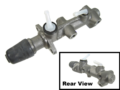

Most (all?) Type 3 masters come with a (near-) 90° nipple:
Did you use a Bug unit?
Sorry, I don't know where to get just a 90° nipple. |

Another difference in Bug units is the threading (or lack of same) of the two mounting holes. IIRC, the Bug MCs are threaded, so you drill out the threads to use it on a T3.
Here's another pic of the correct nipples:
