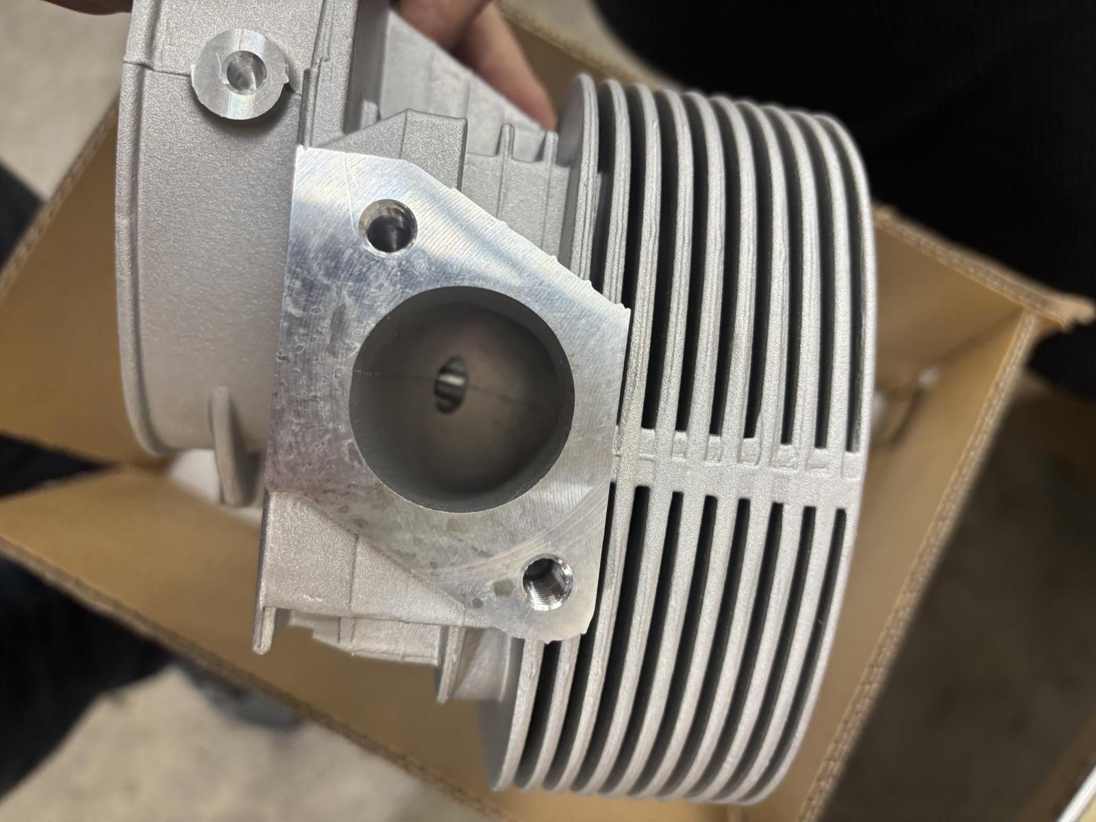

PostPosted: Wed Jan 08, 2025 9:04 pm    Post subject: Re: VW Cylinder Head Quick Reference Sheet Reply with quote
GREAT NEWS!!!
https://www.thesamba.com/vw/forum/viewtopic.php?t=799059
Brian_e wrote:
Super quick phone pics.
Brian
