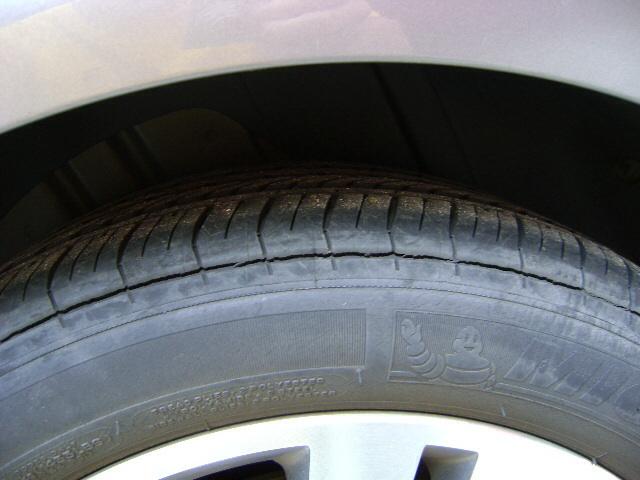

pdm777
Joined: August 06, 2012
Posts: 348
Location: Clovis, CA
pdm777 is offline
PostPosted: Thu Oct 24, 2013 7:11 pm    Post subject: Reply with quote
Houston, we have a problem.
Google : michelin hydroedge sidewall crack
All four tires had very significant sidewall cracking.
I did not feel safe driving on tires that had compromised sidewalls.
Any body else notice severe sidewall cracking on Michelin HydroEdges???

At least one of my gw hydroedges showed significant sidewall cracking at 20k, replaced with nokians at about 30k (est., I'm not great at tracking these things), and they are so much better! Felt like I'd gotten power steering. Astoundingly better. I wasn't buying the rolling donuts of death stories on the fat thread on this but will certainly only get higher load rated tires from now on. I will note that the cracking was most noticeable on the tire that gets the most sun where it is usually parked.

PostPosted: Fri Oct 25, 2013 1:48 pm    Post subject: Reply with quote
was running 36psi in all four,
no load - driver / otherwise empty
Standard 16 inch GoWesty wheels.
After blowout, pumped in 44psi
on remaining three tires to get home.
Severe deep cracking apparently
weakened the sidewall cords.

If you search about this on the web you get a lot of hits regarding these tires and sidewall breakdown, seems like more of a quality control issue than an actual load rating problem?
I just googled with what was suggested earlier "michelin hydroedge sidewall crack" and found this:
http://www.consumeraffairs.com/tires/michelin.html
It looks like there is a quality issue with the Michelin brand, and nothing to do with our own vehicle tire requirements... Here is a picture taken from the website above that shows the tread separating from the rest of the tire:
Wow! Thats scary... Fortunately i don't have the tread separating like that. Now I know what to look for, I'll keep extra attention to my tires.
To the original poster, is that what happened to your tire?
