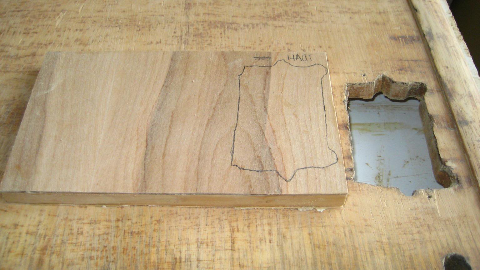

Posts: 1475
Location: FRANCE and now QUEBEC city
grailoc is offline
PostPosted: Sun Feb 09, 2014 9:02 pm    Post subject: Reply with quote
If you plan removing the wire pug:
this is what I did on mine:
before:
bilding the patch:
cut it to fit tight:
added some wood cement and filer:
and ones completed:
