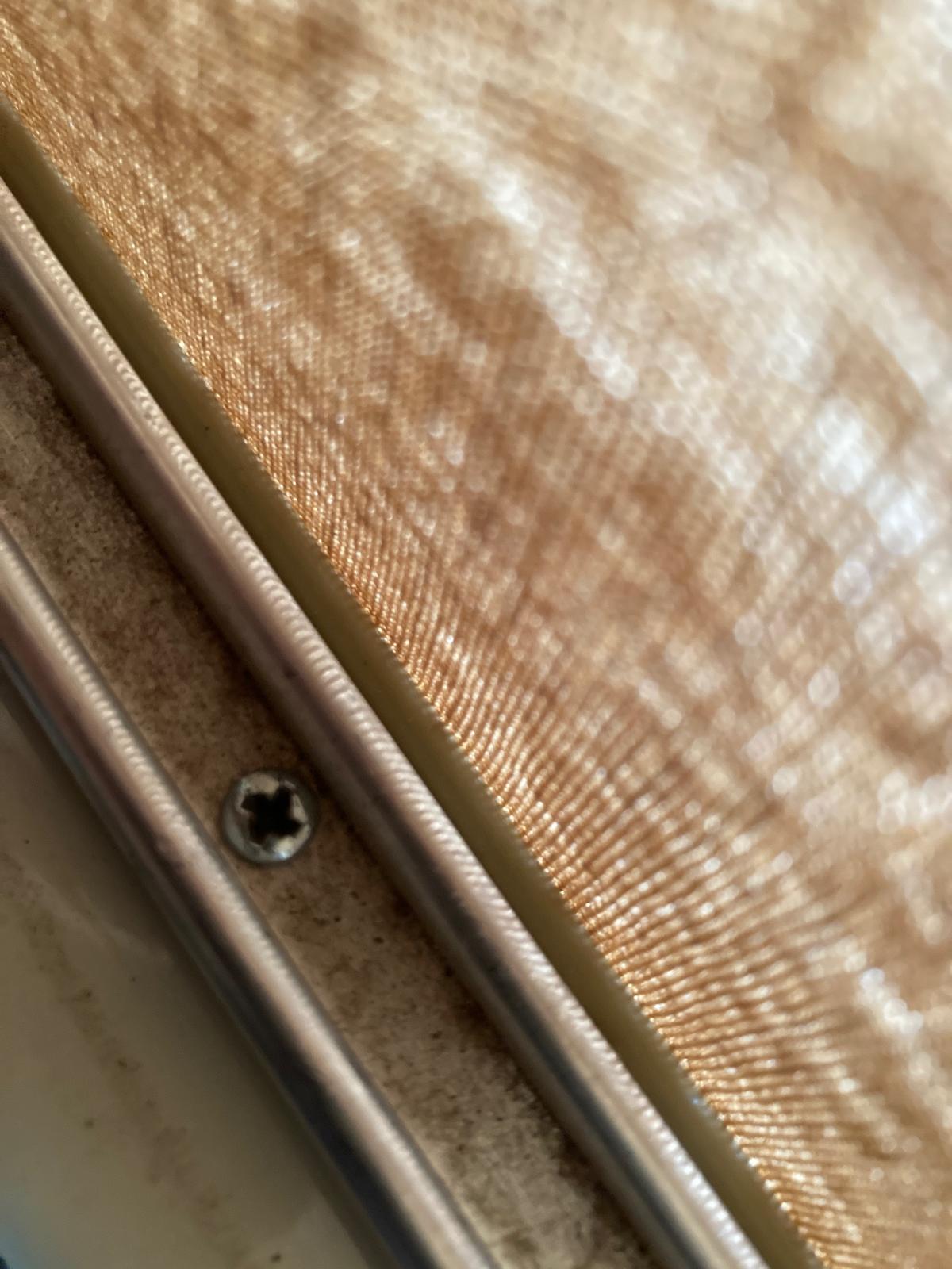

It's time to replace my canvas tent, and this weekend the sunlight hit the material in such a way I could see how porous the old material is. That may be from years and years of use and abuse where the material has broken down over time.
How porous is the canvas material on the Bus Depot or GoWesty replacement canvas tents? Can you see sunlight through them, or are they a dense material?

I can't comment on how porous those aftermarket canvas tents are or appear, but I can say that Sunbrella acrylic fabric is vastly superior and does not get moldy. The cost of the replacement pop-top is one matter, but after you factor in the work involved in installing the tent, whether you pay someone or do it yourself, it's well worth it to get the acrylic fabric. I have had several canvas pop-tops (all factory) on several Westies and none compare to acrylic in waterproofness, fast drying, and resistance to wear. It might be best to "cry once" on this one.

The tent I got from Bus Depot was heavy canvas (hemp?) clearly not as thin as the original. It has held up very well for the past 16 years. That said, I do not know if it is the same material currently used.

Put on a GW cotton tent last year. It was a little thinner than I had expected. Can't compare to synthetic, but these photos give you some idea. Overall, I really like the window design. Fit was tight on my '85.

Thanks for all the responses and experiences. Vanuber, your canvas tent pic tells me a lot, and I can compare it to my current canvas tent.
