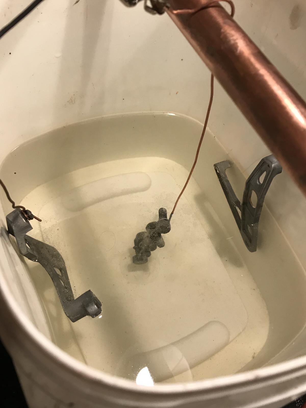

I've stored those same bolts now for several years, watching them. The cold oxide finish, along with the oil, preserved them pretty well until I recently dug them up to put them on the car. The moment I touched them, they left orange all over my fingers. They'd started to rust. So- I decided to zinc plate them. I started zinc plating stuff at home a while back and its fun. And cheap and easy!
The basic steps are:
1. Strip any finish off the piece (I use muriatic acid in a glass jar from the pool supply section of an Ace. You can re-use the acid a few times)
2. Clean the piece (I use isopropyl alcohol and wear gloves to prevent contamination)
3. Plate
4. Rinse and polish
If anybody is interested I am happy to go into a step by step, but I'll mostly just show pics of the steps:
Stripped bolts sitting in alcohol until plating:
Small plating station, with most of the supplies:
Clean bolts suspended from copper wire:
Bolts suspended in electrolyte bath between zinc anodes:
Bolts fizzing during plating process, starting to accumulate zinc:
Pulling bolts to assess coverage after disconnecting current:

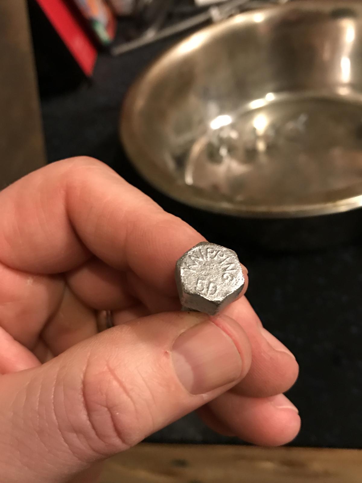

A finished bolt after polishing with toothpaste, brass brush, and steel wool:
Progress:
Raw bolt, then plated, then polished:
bluebus86
Banned
Joined: September 02, 2010
Posts: 11075
bluebus86 is offline
PostPosted: Sat Dec 23, 2017 1:57 pm    Post subject: Re: Fender bolt restoration Reply with quote
How thick is the film plated on the bolt? maybe get a micrometer read on the hanger wire of unplated verse plated diameters? More details on time, power, electrolight concentration?
Nice idea, Bug On!
panicman
Joined: December 18, 2011
Posts: 2673
Location: Canby, OR
panicman is offline
PostPosted: Sat Dec 23, 2017 4:00 pm    Post subject: Re: Fender bolt restoration Reply with quote
Thanks!
I didn't measure, and honestly I would need to buy a better micrometer to get any accuracy. I am happy to grab a random bolt and plate it after I get a better one.
Here is a bit more detail on how I set everything up.
The bucket I used is an old kitty litter bucket with a handle. I can reposition things to do a bigger object if I ever need to. I ran copper wire around the edge of the bucket to provide positive to my anodes, and pigtailed the positive wires so I could easily attach one lead. Here you can see the positive wire from my power source clipped to that pigtailed lead. You can see the negative wire attached to the copper wire that holds whatever I am plating.
Here I have fished out the 'anode'. You can buy zinc anodes that already have leads at many hardware stores. They are used in evaporative coolers. I opted for ultra-cheap. I saw a rack of solid zinc clothesline pulleys at a nearby dept store- $4.99. I hacksawed the bracket in half, and the halves are my anodes. If they ever get depleted I will cut the zinc pulley wheel in half and use those. I drilled a small hole in the anodes and ran a screw in to each. That is how I attach the copper wire to supply positive current, and suspend the anode in the bucket.
Here is my power supply. I think it was a charger for an outdoor led umbrella light. It is a 3.7v, .35amp power supply. I removed the plug and attached clip leads.
I use 12g copper wire, some of which is stripped bare for hanging the parts.
To hang the parts, I pounded the ends of a copper tube flat to sit across the top of the bucket.
I use a scale that reads in grams and ounces. I measure volume in ounces, cups and quarts.
For the electrolyte bath, I use:
4.75 quarts of clean water
.85 cups white vinegar
Corn syrup (don't use high-fructose), about 5 oz (1/3 of a regular Karo bottle)
300g of Epsom salt
100g zinc sulfate (I used Moss Out from HD)
Stir this with a stick, or you could use a wire whip. Parts of it will form into cakes- just keep breaking it up and stirring.
Drop the anodes into the solution. They will provide the sacrificial metal to plate the parts. Hang or wind your part(s) on the bare copper wire, and hang this wire on the copper tube, making sure your parts are completely submerged. Clip the negative lead to the wire holding the parts to be plated. Clip the positive lead to the pigtail that leads to the anodes. Plug the power in.
Within a minute, the part will start fizzing pretty aggressively. You just wait until there is a heavy bluish-gray coating on the parts. I normally disconnect the power and pull the parts every ten minutes or so. I look for even coverage; most times, there will be a shadowy dark spot here or there, and that part needs to be re-struck. Just readjust the part and plop it back in.
Once you are satisfied the part is plated, rinse or dunk it in water, then scrub it with a brass brush and some common toothpaste and clean water. For a bit of extra shine, you can polish with 0000 steel wool, or you could also tumble them in media.
Doing this many bolts (with breaks for dinner, hanging out with wifey, etc..) it did take about 3-4 hours, and polishing individual bolts gets OLD. But I think the result is worth it, and I have been meaning to do it.
Safety notes!! Do any/all of this at YOUR OWN RISK...
This is easy and cheap, but it can be dangerous.
You are working with electricity. Always make sure everything is disconnected before you go fishing for your part.
If you use the acid to strip your parts be extremely cautious. Muriatic acid will disfigure you, it'll eat concrete, and destroy just about anything it touches. Don't work with it indoors. Don't whiff or breathe the fumes AT ALL. Wear heavy chemical resistant gloves, sturdy clothing. Don't do anything that will cause it to splash. Don't leave parts in it with out watching- it'll eat them completely.
Its more fun to plate larger stuff, but you might need to adjust your power source. So far I think the largest object I have done is an old Bosch coil bracket, and the power source I listed was sufficient.
I think each cluster of bolts took 15-20 minutes total to plate.
