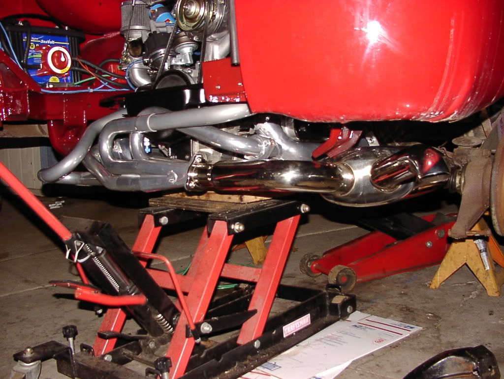

Take a look at the direction your exhaust outlet is pointed. It should point aft roughly parallel with the ground. I had one from A1 Muffler that pointed down and created the sound you’re having. Solution was to cut and weld into the aft direction

This caused excessive reverberation

It produces 87db. What db does you’re exhaust produce at 60 mph, Aeromech?
It's a customers bus from years ago. The point is that once installed, this $1000 exhaust created a lot of the same noise that the OP here is reporting. Just trying to help solve his problem.

Of course that one has significance. The angle of the outlet was pointd downward causing the same distinct reverb that the OP was getting in his vintage speed. Pay attention
The angle of the outlet on the OP’s exhaust does not match what you have shown. Actually none of it is similar. Pay attention.

Thanks for the picture OP. Hippie, kiss my ass. I was trying to help from my personal experience. You should try it sometime
