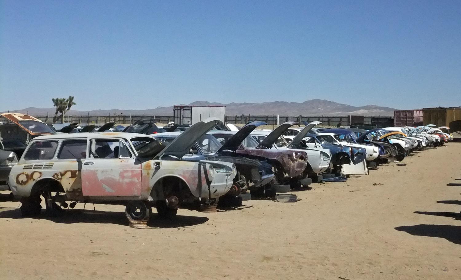

Do you know the large pick-a-part yard in Adelanto on US 395 (Ecology Auto Parts), just north of the industrial airport? I stopped in there while driving back from Las Vegas this past March, just to look at their VWs. They had about 20 Beetles there, though nearly all were from the big-bumper era. They'd be worth a try to find a complete doghouse and other engine tin, especially the rear breast plate which you MUST have. Here's a shot of mine which I posted for the Type 3 forum from that visit; you can still see plenty of Beetles in this row. There was another row facing this one with more Beetles-
Yep, I've been there a couple of times.
The VW selection is all too new (like you said) and there's not much there I want .
I'm gonna take a trip to Pomona for one of the swap meets and see what's there. I need a full interior. I have no seats and the steering column and wheel need replaced too.
