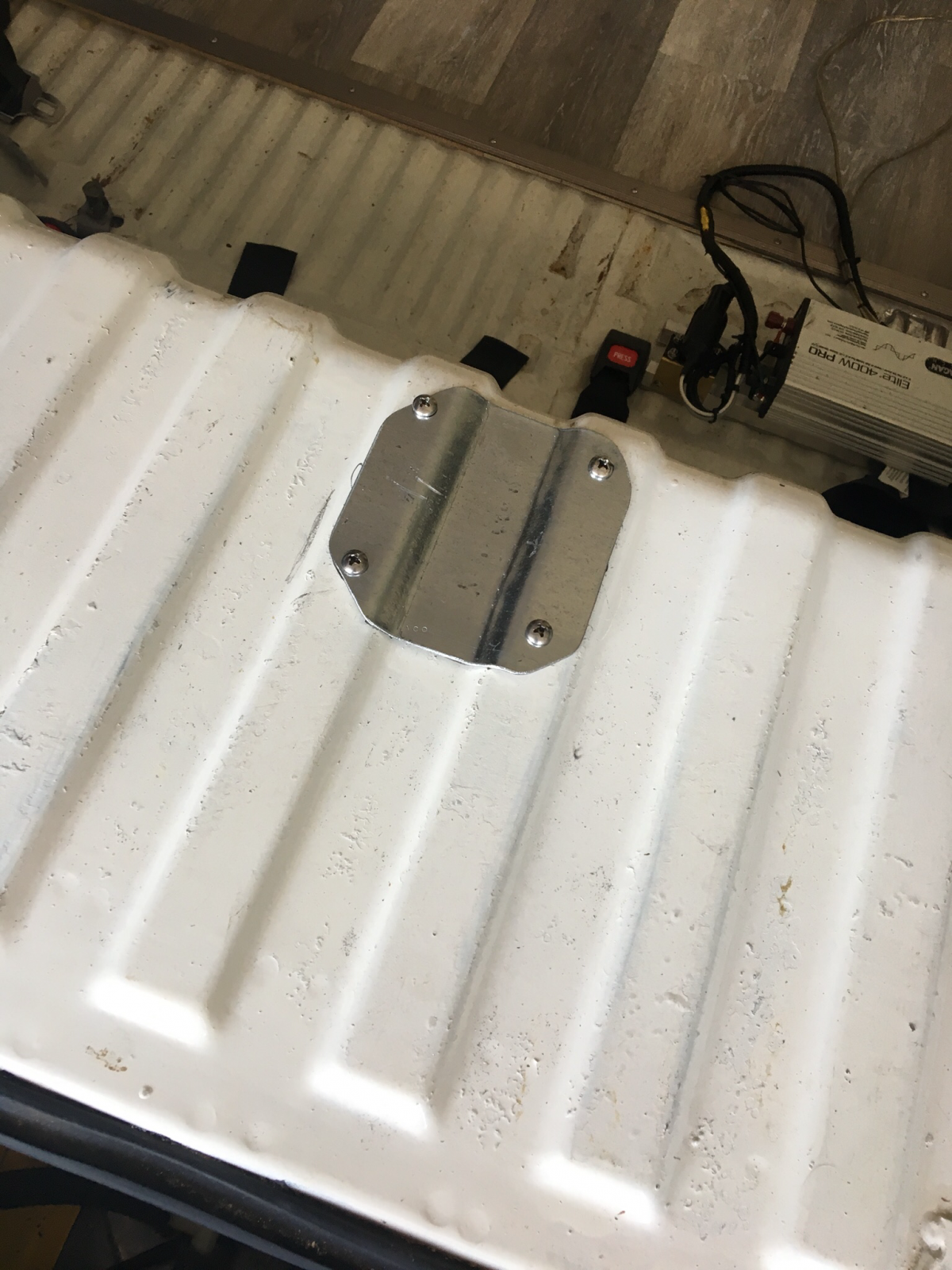

If you really care about it being reasonably accurate look up some of the posts on how to cut a sender access hole. That way you can remove the sender and bend/adjust the arms and stops to make it more accurate. (It is possible without the hole, but the whole tank needs to come out.)
It took a few rounds with mine but I got it reasonably close. It's not difficult.

The access door seems straightforward. What is the collective thinking on if cutting the door lowers the value of the car? This is no show car by any means, but I've always tried to never cut holes in cars I've owned.

Since the access hole is hidden by the cushion (if you have a camper), then it has slightly increased value in my opinion. Without it, access to the sending unit is a half day process for me.
Just do a neat job of cutting the hole and covering it when you're finished.
When I cut mine using an angle grinder, I opened up the round access hole next to the ECU and use a high velocity fan to blow air around the gas tank.

I used a 4" hole saw to cut it, and a 4" stovepipe plug with some silicone to close it off.

We cut the hole in summer, and glad we did. We had to tweak the arm of the sender multiple times to get it "just right". We cut a 4.5" hole.
