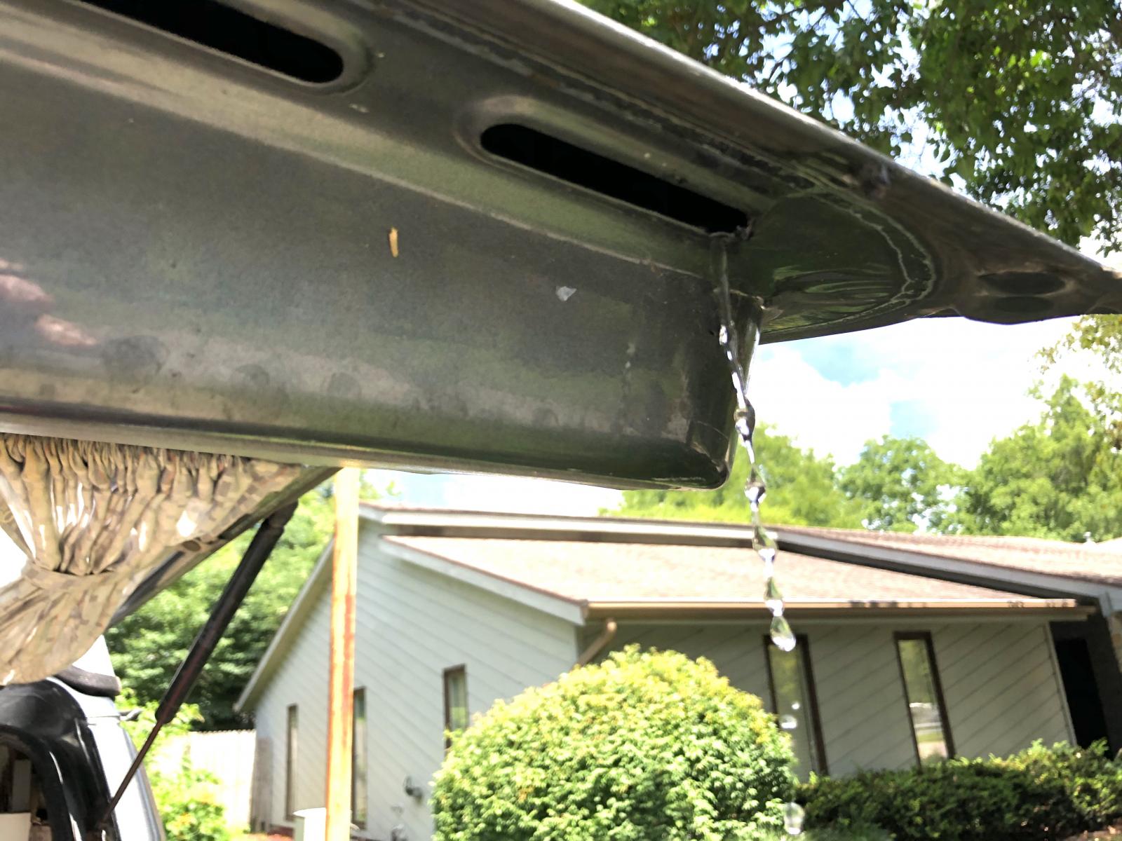

This has me puzzled and I hope someone can help.
After it rains, and I open the back hatch, I get water draining from both sides of the hatch. I have taken off the vinyl back panel on the hatch and even used a piece of chalk to mark the inside of the hatch from one side to the other. I thought if it was leaking around the window it would show drips down the chalk. Nothing. No sign of where the leaks are coming from. It has to be on the outside edges, and on the top but I can't locate it.
I am missing a rubber grommet which protects the tube and electrical wires that go to the windshield wiper motor but that is only on one side. The leak happens on both sides.
Any thoughts? I appreciate any comments.

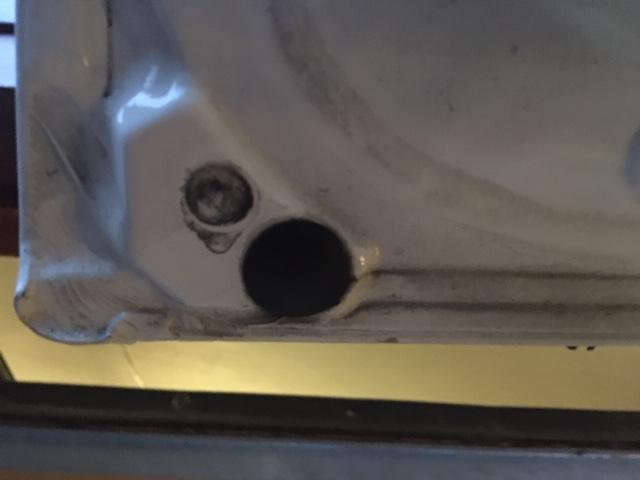

I've taken the rear panel off mine - and began to investigate with a hose spraying from outside.
I found my emblem (Volkswagen GL) was leaking. I will probably just smear some sealant on there, unless someone has a much better idea? So that is where water gets in, but why isn't it getting out.
The weep holes! In your picture - should I pull those round plastic plugs and clear this out? I don't understand why they would plug a weep hole - I didn't want to take them out - thinking that maybe there is some reason they put them in? I'm guessing at this age - the plugs will probably break when I try to take them out. So then should I be looking for new ones, or just leave them out...

dobryan Premium Member
Joined: March 24, 2006
Posts: 17380
Location: Brookeville, MD
dobryan is offline
PostPosted: Thu Aug 13, 2020 5:38 am    Post subject: Re: Can't locate the leak from back hatch after it rains Reply with quote
I would leave them out.
