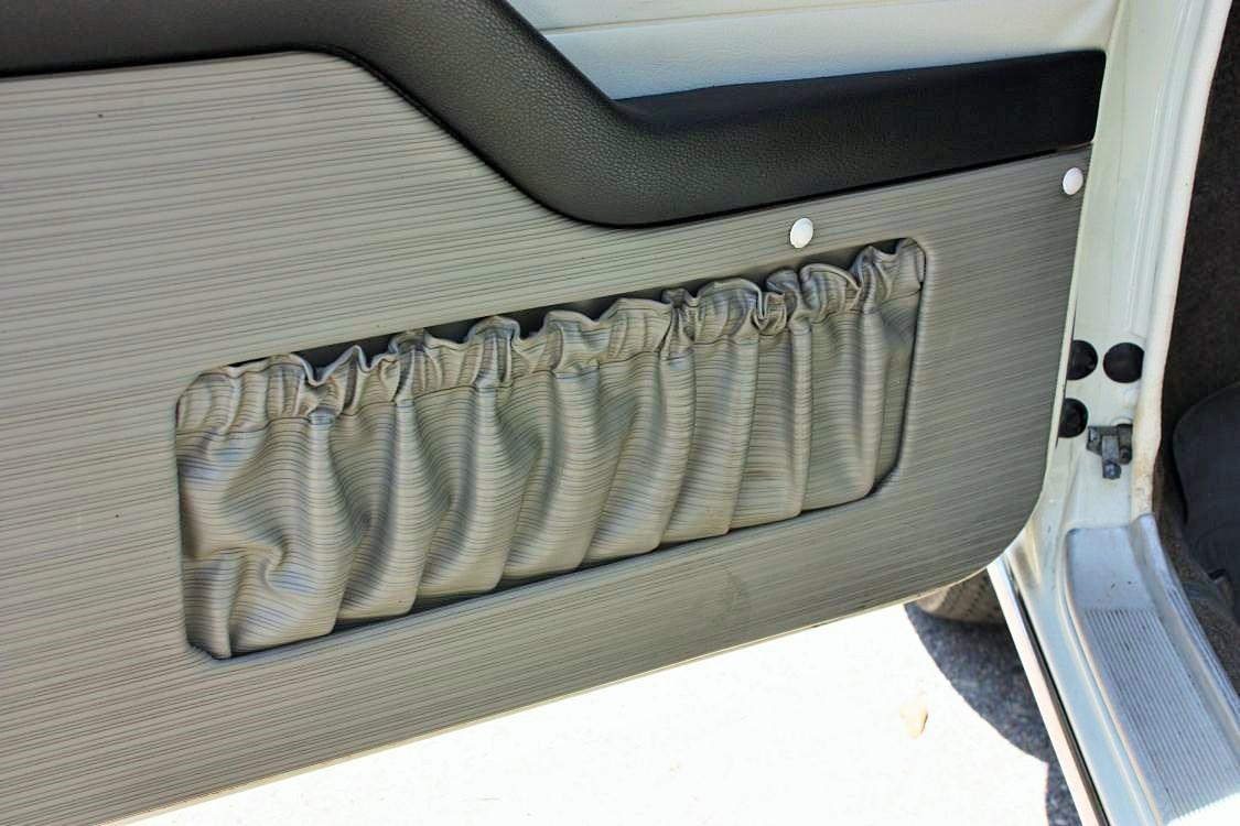

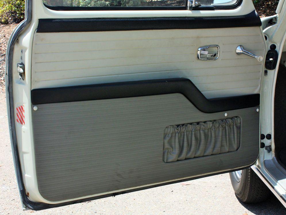

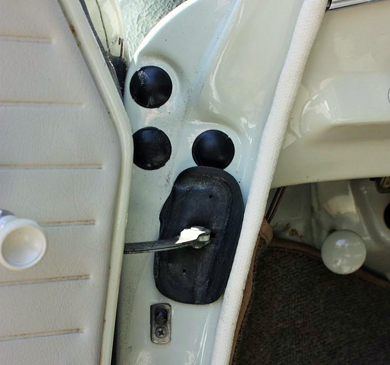

So in anticipation of requests for detailed interior photos, here are ten pics of the often unseen areas of these cars. You'll notice the rubber floor mat has higher lips at the front edges and there are lines for the foot areas, not pebble-grain throughout. Check out the ebrake boot, with its O-ring to keep the front edge closed.
