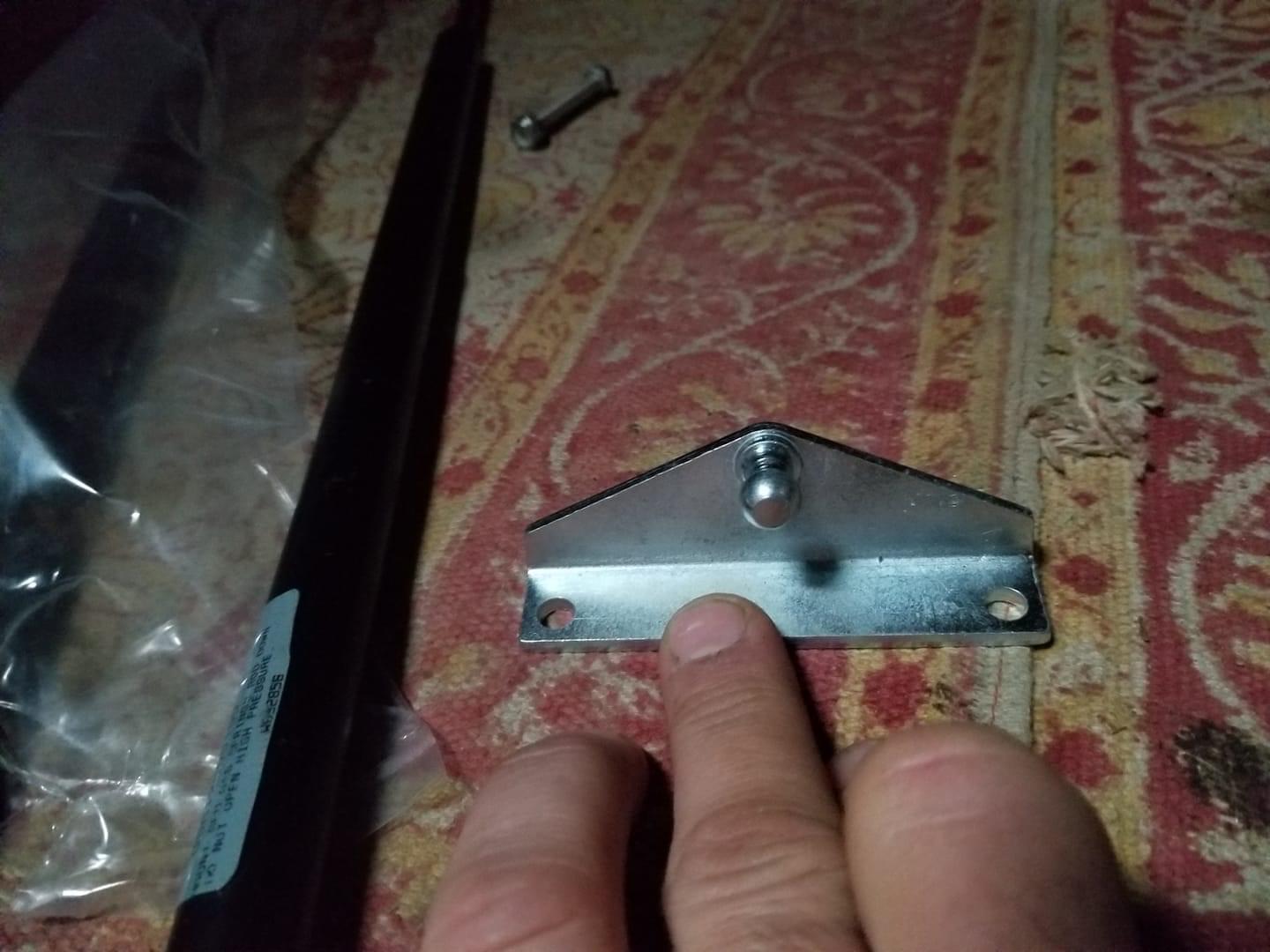

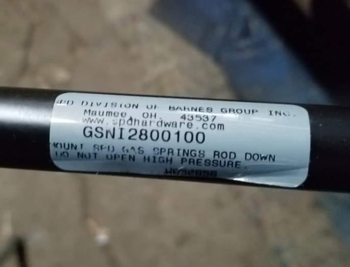

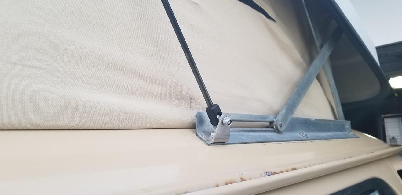

A few years back I added the Gowesty kit on my 79 Westy as we were hauling our kayaks. Worked great when the kayaks load was on our rack. When the were not loaded the pop top would open itself just by releasing the latch. The downfall without the load on it was closing the poptop. Lots of force to bring it down. They were the following struts which were 100 lb ones and 28 inches.
I decided to go with something lighter but still able to help assist the kayaks being on top. Lots of options on 28” ones with varying weights from online vendors. I went with 70 lb last year finally. https://www.liftsupportsdepot.com/lift-supports-depot-se280p70-gas-charged-lift-support/ Work great going up with/without a load on top and not hard to pull down without a load like the originals GW ones.
All I will add for you to think about is decide on what your purpose of adding them is. If it’s just an assist to help to lift only reason with no load then go lighter then 70 lb. If you have a load going on your poptop then yes go higher then 70. But be prepared to remove them when you don’t have a load. You’ll be pulling down harder just to close the top. Before you buy a kit (which may be easier for you and others) look at just buying the hardware for attaching to the your Bus from a lift support vendor. A friend got pictures of mine and was able to find the same brackets for the top and bottom online. Then he bought the struts separate too. Saved him about $50 Here are pictures from my GW ones. The link above I gave sells the same brackets.

@Boesen very helpful numbers as I can cross that to Nigels numbers. In N not lbs I followed your link and got this
Extended Length A [in]: 28.00 = 71cm (710mm)
Stroke C [in]: 11.50
Compressed Length B [in]: 16.00
Force (Lbs): 70
Force Newtons: 311
I'll never have a load but want the assist so 300 seems the right number each side for the length of 710mm, shorter its doing more work so Nigels numbers of 460N and 550mm tie up.

« In this video Mike installs poptop heavy duty assist strut kit to help raise poptop on westfalia with additional weight on it. »

« Lift assist struts on our 1971 Westfalia Part # GW-B-POPTOP-LIFT from www.GoWesty.com fits years 1968-1979 bay bus! »
GoWesty Pop-Top Lift Assist for Bus | Works With: 1968-1979 | Part #: GW-B-POPTOP-LIFT | PRICE: US$62.95
