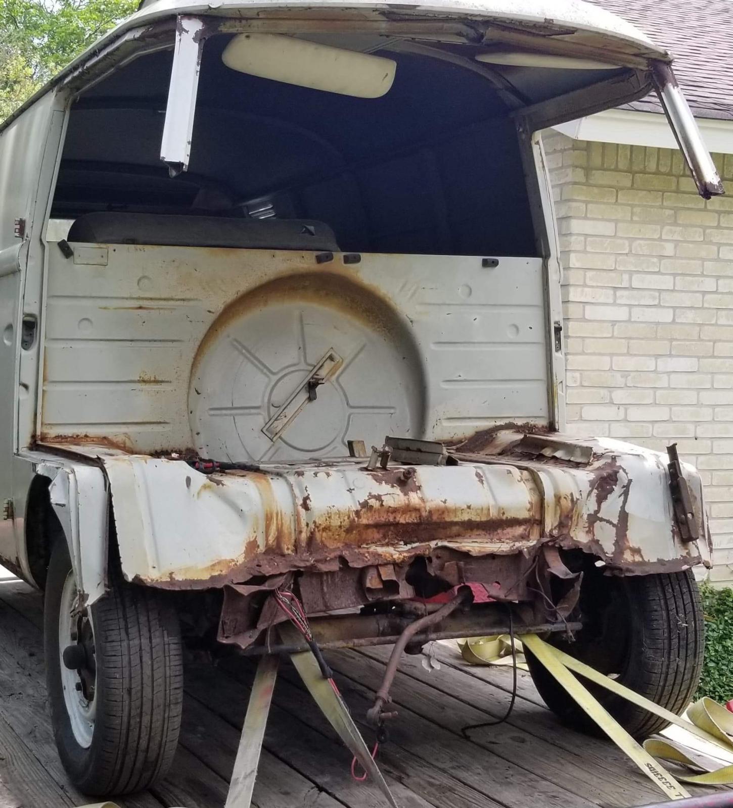

Hello all . . . . I have been a member for some time (Since my first VW Bus purchase back in . . . 2015 i think) and havent posted much. I found most of what i needed in the "Archives" here on the forum so kept pretty much to my self with all the information here it was just a matter of piecing it together.
Well now i have done it . .. . i got a project that i have no idea where to start, or where i want to go (I have some ideas but need to make sure all the pieces will fit together).
1966 Panel Bus .. . Rust is considerable, but its mostly all straight and there. Except the Front End!!! Appears to have been in a front end collision at some point in its recent past.
The Dilemna:
What metal do i need to get started? (Or do i even start with the Metal)
The Goal (or Goal#1): is to have a complete bus, meaning put this front end back on .. . if i decide to sell in the future due to whatever life issues come up (Or to fund another project) i think a whole bus will sell better than part of a bus.
I also feel this is the biggest and most time consuming portion of this whole project, so i kinda want to start chipping away at it first.
I want to start a list of stuff i need to start buying for this thing . . .Please Help!

You need everything in a donor section from just behind "B" pillars forward if someone is doing a quick chop up. With or without the bulkhead panel is fine.

Those just do not go back far enough frame is bent all up at least to the front beam.
To the OP, will need to inspect the frame very carefully around and behind the front beam to see if frame was buckled....
X2. B-Pillar forward. Preferable with the B-pillar attached still, but that could be negotiable depending on the amount of frame damage.

So i had a quick look (It was Dark out so i didnt take any pictures yet) and i cant see any other frame damage than what is obvious (But my eyes are not Laser straight either).
Should i take this to a "Collision" body shop and have them do the front end?
I wonder if i can find enough NEW parts . . . instead of finding a Donor front end. It took me long enough to find a bus i could afford and thats why i ended up with one in this condition .. . No telling how long it would take to find a Donor .. . Unless someone knows where one is in central texas.
Thanks for the Help .. More pictures to come soon.

I hate to say it but If you're paying someone to repair that you would probably be better off finding one in better condition.

Ditto! Also all new parts are going to cost another pretty penny.
Just keep looking thru the new posted classified ads twice a day, and post a "WTB" ad of what you need.
Buy a Miller or Lincoln wire feed welder and start learning how to melt metal together.

Taking it to a frame shop would be better, and have them measure it all to see if the frame needs to be pulled out straight, or of course you can use the workshop manual diagrams to measure it yourself.

So at this point i have no idea on what it will cost if i take it to a body shop to do some of the "Larger" work for me.
Im not afraid to get my hands dirty on a portion of this project. But i have learned through life that sometimes its best to pay a professional to do a Job . . .and im curious if this is one of those Jobs where i need to consult and hire a Professional.
Panels and other things are not too scary for me . . . Ill learn to weld and so forth on those cut and paste projects. But the WHOLE FRONT END . . . kinda scary.
Also . . . Value on this bus . . .i feel like i could put alot of money into this bus and it will probably be worth alot of that money still.
Looking at Split-Panel Buses and i see prices still north of what im projecting this thing to cost in repairs . . . Hopefully

And how are you projecting those costs ? Buying & having someone put that front clip on could cost you $10K......
You might be able to find a Bus that has been rear ended, cut the front off & graft it onto your Bus, but to pay someone to do it would be co$tly, can you weld ? Or do you have a line on the front end ??
