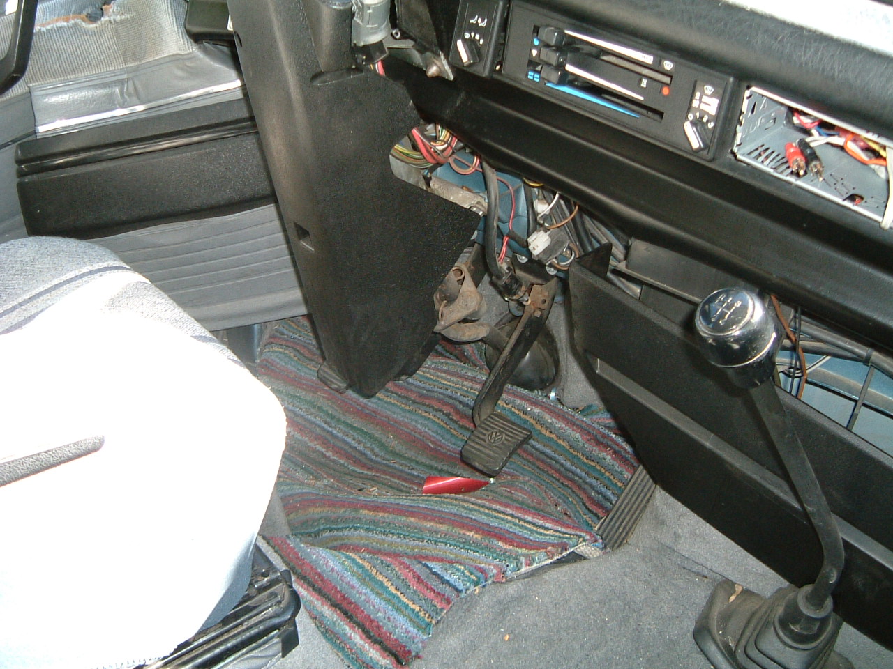

they pivot forward like this by design
one of our own here survived this with minor injury.
the nice thing of a vanagon is the floor height and that the occupant isn't sitting down underneath the dashboard. where you'd get trapped in a conventional vehicle.
