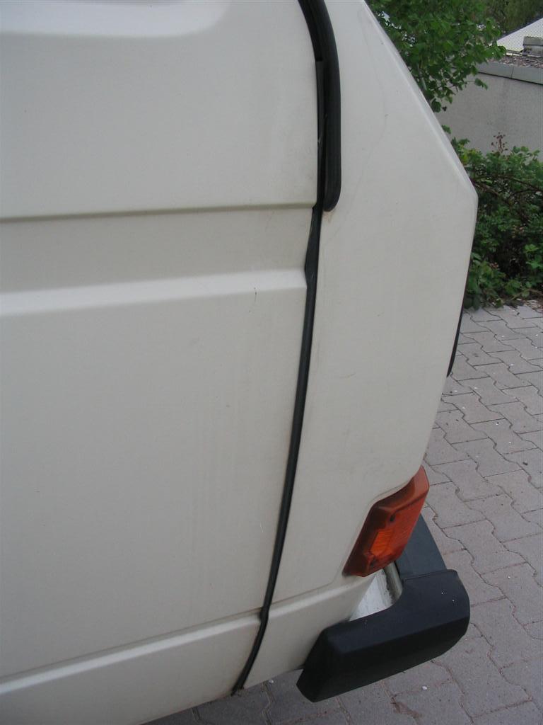

Maybe you guys know this, but it was a new discovery for me today.
I had always assumed the air that came out of the front door vents came from the channel through the doors.
That's not the case at all!
Air for those vents comes from slots in the front of each door, a ram air ventilation. The front doors are pressurized as you drive. I imagine this helps dry them out after rain storms, air is forced out the drain vents in the door bottom..... Or into the Van if you open the vent.
This photo shows light from a flashlight placed in the rear of the door illuminating the air intake slots at the front of the door.

GoWesty's more thorough explanation:
So far we have only discussed how air ENTERS the vehicle. Of course, no air can come IN unless air goes OUT. This is called “flow-through ventilation,” which all vehicles have to some degree. Prior to 1988, if all windows were closed, the only way air could get out was through little exit vents located on the rear lower corner of the front door interior panels. These are the plastic vent assemblies with the little blue slide lever.
These vents allowed air to exit the interior. Sliding the lever toward the front of the vehicle opens the vent, rearward closes it. On the leading edge of the doors, in the door jam, there are three oval holes that open into this hollow space of the door itself. As a Vanagon plows through the air, air flows around the vehicle creating low-pressure zones near the front door jam areas. VW engineers realized this and used this low pressure to suck air out of the interior of the vehicle. Air flows from the inside of the vehicle through the little vent at the rear end of the front doors, through the hollow door itself, into the door jam area, and out of the body gap between the front door and front quarter panel. Genius, you say. But what about the rear passengers, you say? And why, in 1988, did VW put a rubber seal at this body gap, thus blocking all airflow through it?
The flow through ventilation scheme completely changed and improved in 1988. This change coincided with the introduction of the switch from chrome (or black) steel bumpers to the fiberglass "big bumpers" and the accompanying front spoiler. In 1988 the rear-most side windows have an added vent along the rear edge. It was necessary to shorten the glass in order to make room for this vent as the opening in the body stayed the same. These vents are air EXIT vents.
Interestingly, the little grills on the front door panels remained, but if you remove them you will see the passageway behind them is sealed, and there is no blue slide lever. The seal at the door gap area was put there probably for reduced noise. I installed these seals on my 1987 Vanagon, and added the rear vents too. It actually lowered the wind noise a little, and the rear vents improved air flow inside the vehicle, especially for the rear passengers. And now I have the best of both worlds: improved flow-through ventilation and cool air from the dash vents! You can say you knew me when I was nobody…
http://www.gowesty.com/tech-article-details.php?id=83

Adding to you information about VW moving the vent to the rear and closing the vent in the front door....... I stumbled upon this photo of the seals installed when they did this.
Top outer door edge, inner front door edge seal and air channel seals......
