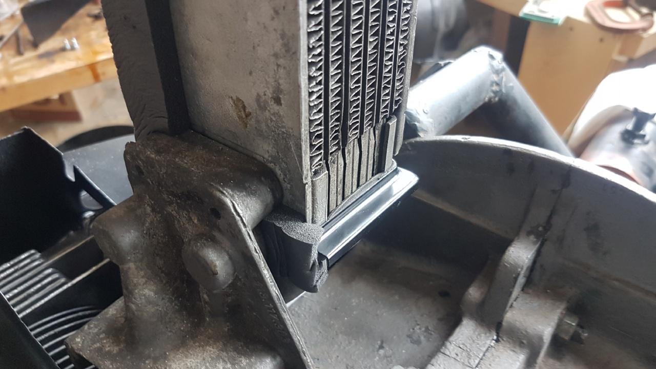

Engine going together. Added an oil filter pump. Needed to grind down the upper fin so tin would clear pulley. I didn't remove quite enough but decided to put a small indent in the tin instead of removing more material.
After I set up to install doghouse cooler I realized it was a doghouse case converted to older cooler. Not sure why I didn't realize that before. Smile Had insert in the outer holes and an adapter stud. Didn't use the green converting seals in photo.

You dont use the copper spacers with the doghouse cooler adapter either

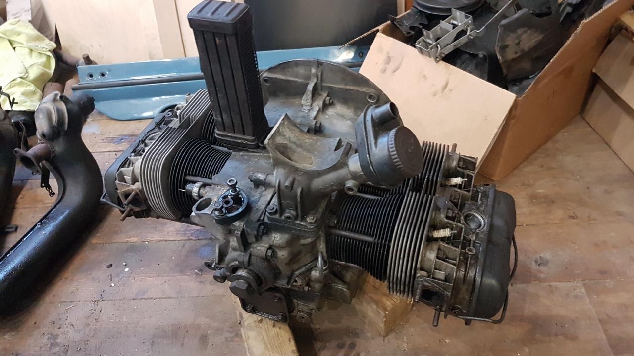

Needed a few parts off the old engine. At least nothing was rusty. Smile. One advantage of misting oil for a few thousand miles. I will rebuild it as a spare over winter.
Stole the battery for the wife's Rav last winter so needed a new one. Old battery didn't fit well anyway. Group 26 is vertualy the same size as original 6v. With the ugly sticker peered off it looks like it belongs. Will likely removed the handle also.

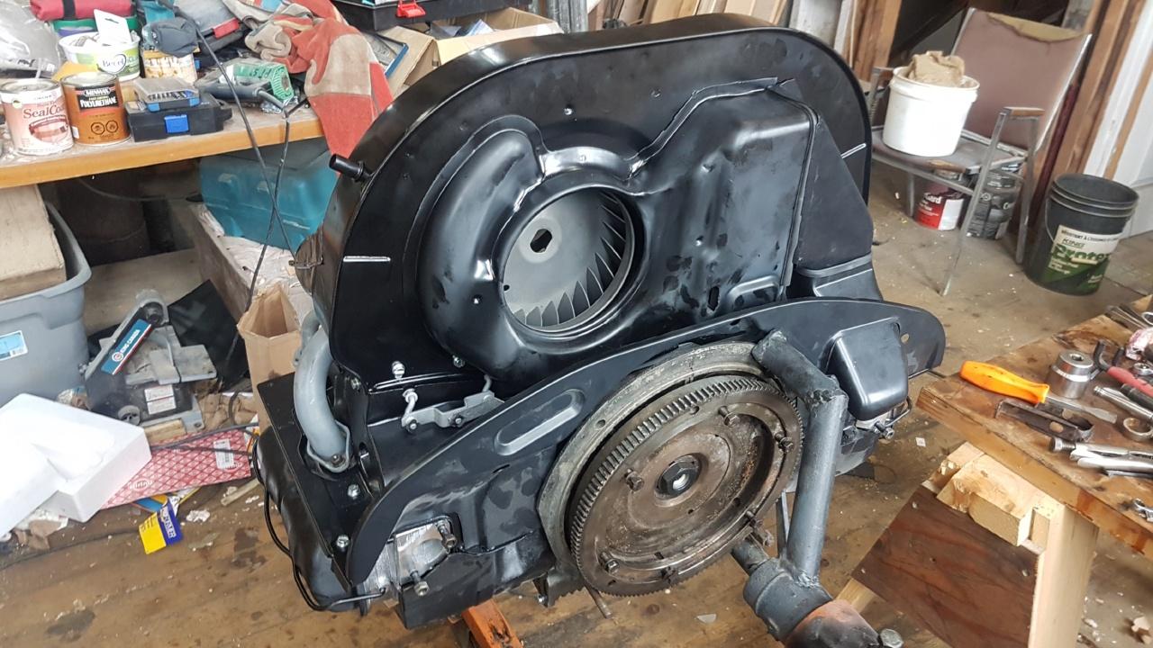

Afternoon was spent fighting with the alternator.
Somehow I ended up with a generator stand. Pulled the alternator stand from the old engine and had a hell of a time removing the incorrect oil filler.
I should have attached the alternator to the tin before installing but I wanted to see how it would be changed it without removing the tin. A pain but can be done. Took me 5 installs to get rid of the fan rub.
Also found the tins I painted didn't have a bolt hole for the preheat cover. I may drill a hole and use a self tapper.
Almost ready to run it. Still waiting for flywheel shims.

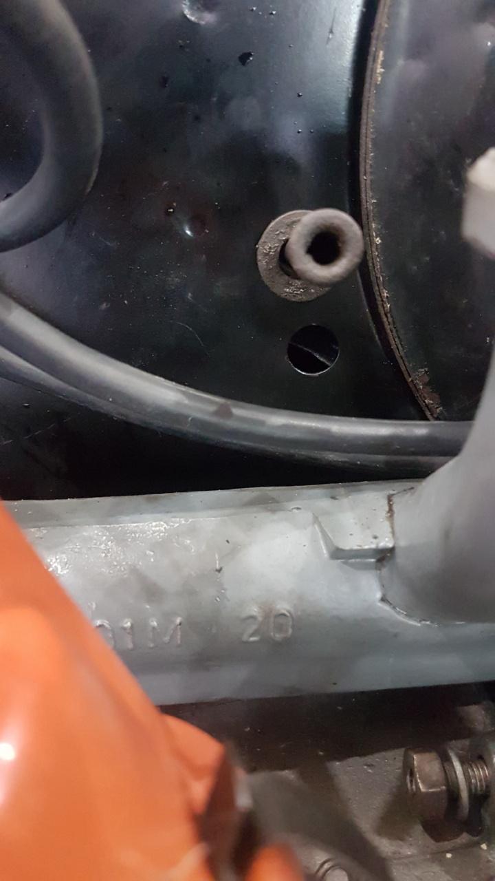

Bit more tonight.

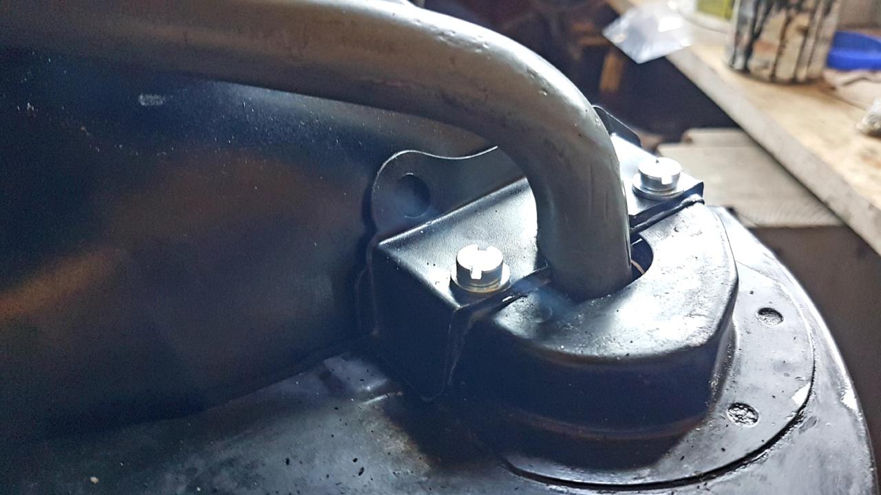

Throttle tube doesn't line up with hole in front tin. Front tin is new but I can see the shroud was damaged by cable so not sure what happened. I will file the front tin out a little. The engine stand is pushing the tin in and not helping.
Is the hole below throttle tube for plug wire clip?

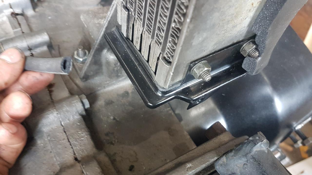

Heater pipe seal got an oil bath for a few months and rubber swelled. Cut 3/4" out and glued back together. Next order I will get a new one.
Base vent is going to interfere with the heater pipe. Will still work but not quite correct.
Also an extra hole in front tin. I will find a rubber plug for that.

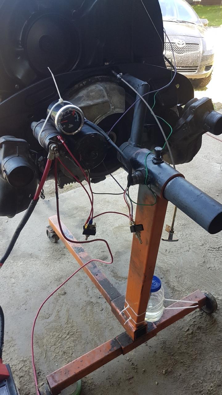

Made a run setup. Eventually I will make a bracket to mount controls and tack. It is very convenient to setup the engine on a stand.
Printed a pattern for adding a notch at 30°. Makes it easy to time the 009 at full advance. Maybe next year I will get a proper distributor. Actually the 009 works well for the type of driving we do.
Two oil leaks. Oil plug was loose and oil switch needed another turn. Valves needed another adjustment. Must not have had everything seated when adjusting them originally. Had about 050 gap on 2 and 4.
Ran it about an hour overall. Didn't get hot enough to fully open flaps. Even at 2000 rpm the air exhausting from doghouse was just warm.
