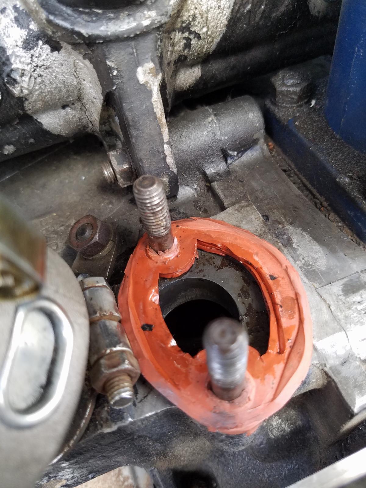

As of recently I've noticed that gas is leaking into my oil. I adjusted the valves about a week ago and when I took off one valve cover a decent amount of gas poured out. I then changed the oil and then noticed a couple days later there was more gas in the new oil. I measured my fuel pressure and it was at 6psi. I made some gaskets out of rubber gasket material and lowered the psi down to just over 3. The car runs good and doesn't flood itself at an idle anymore, however I changed the oil a second time a couple days ago and I smell gas on the dipstick again.
The fuel pump is a new aftermarket (german quality) pump, the gaskets are new, the pushrod is new (and correct for an engine with a generator), the fuel pump flange has no cracks in it, and I spaced out the inlet valve in the carb (as well as tested it).

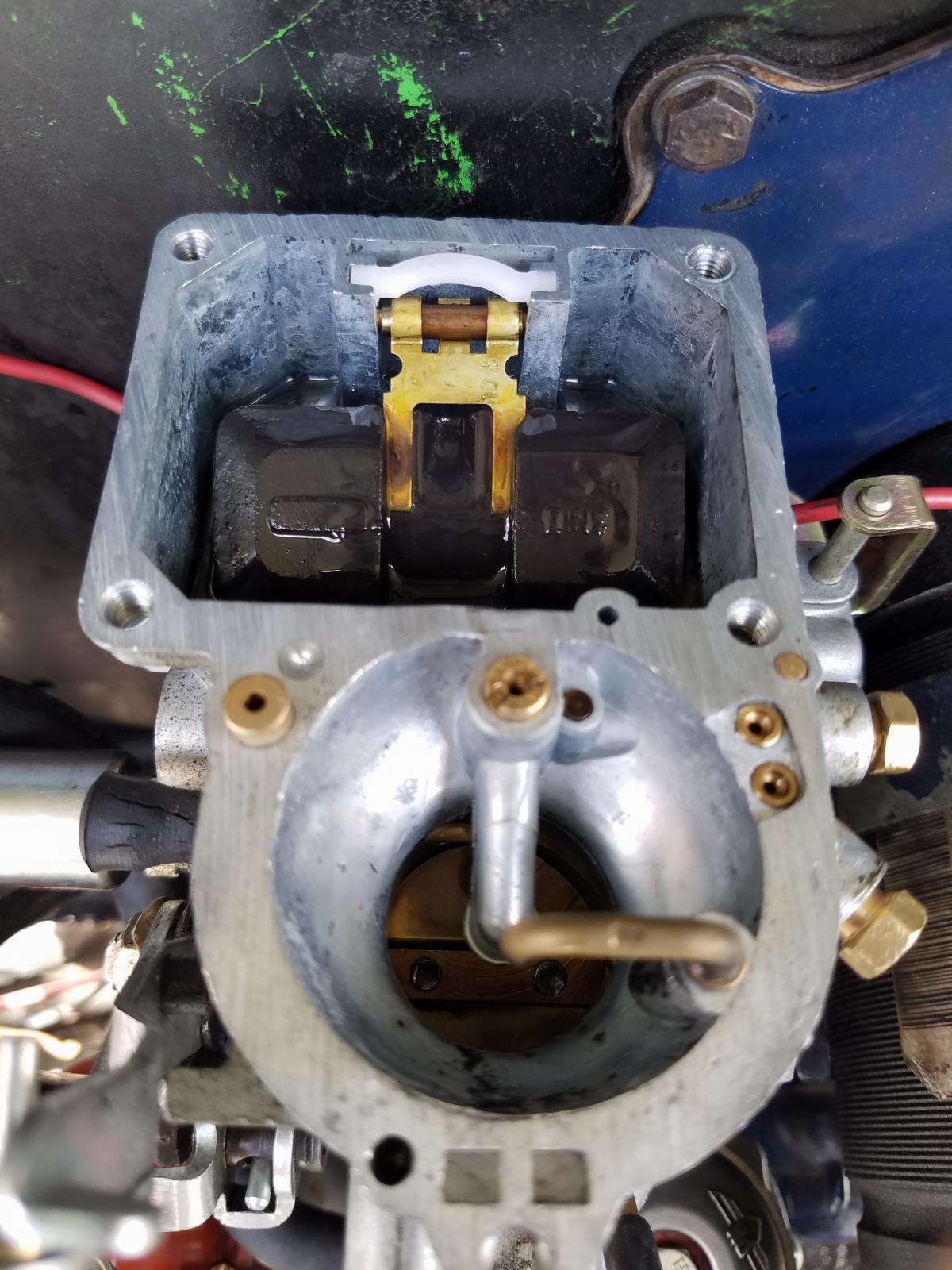

If it matters my carb is a H30/31 pict
The pictures below are just there to hopefully provide more info and maybe point out a problem

Search and you will find threads about fuel pumps showing the different actuation rod lengths. If too long a rod is used it can rupture the new pump's diaphragm or otherwise affect operation. Sounds like you have a mismatch causing the pump to dump gas into the oil.

So basically what you are saying is that although my fuel pump supposedly fits my car and the push rod is the correct length for the car, they may not be the correct length for each other? Which could of caused the diaphragm to get damaged.
I did take the fuel pump apart, but I didn't notice the diaphragm to be ruptured.

3. On your carburetor, the fuel bowl looks low. Did you remove fuel from it for the picture?

Yes, fuel pump rod length can create issues. There are two lengths. One is 100mm long and the other is 108mm long. The one for a generator style pump is 108mm long. There is a lot of good looking grease in that fuel pump. I would expect the fuels solvent action to wash it away if the pump were leaking.
Fill the carb bowl with gas and observe it on a bench in a vice. Does it drip at all? That fuel will go down into the cylinders and because it is a solvent, will migrate into the cylinders and ultimately into the oil.

1. leaky pump diaphram... torn or rotted diaphram, could be old age, could be improper installation that causes the this (impropper rod length for instance can tear a good diaphram)
2. fuel from carb from leaky float valve, make sure valve seals Too high a fuel pressure may also cause the valve not to seal. get an accurate low pressure gage and check, or determine if the fuel level is proper or not in the carb bowl, adjust pressure to spec, then shim valve and or bend float arm as need to obtain correct level. make sure float is not flooded before adjsting, see below... also a dirty valve or one damaged can also leak even if float and pressure are fine.
3. sunken float (even a drip or two or fuel leaked into the float can cause it to not float high enough to shut off the valve, to test the float, place it in a pot of Hot water and observe if bubbles come out, sink the float to bottom of pot with a tool. the waters heat will cause any fuel in the float to expand as a vapor and bubbles will be seen leaking out if fuel is present. the test may not work unless the water is hot.

Note. you appear to have way too much silicone on the pump base, it appears very thick. I simply use the paper gasket for this, with just a touch of "form a gasket", Silicone rubber RTV is generally not very fuel proof, and thus something like Form a Gasket (Permatex brand) would be a better choice here.

3. Nope. Thats what the fuel level was when I took the top off the carb. Could be some already leaked into the oil?

Fuel level is too low in that carburetor. That does not close the needle valve in the top because the float is so far down. I'd pull the carb and fill the bowl and then watch. Something is leaking internally. Also, slight uphill on the driveway and a leaking carb....well, you know the rest.
Do take some time with the carb and I believe you'll find it dripping

1. The pump is new and the rubber on the diaphragm looks fine. When the pressure was at 6psi the rod could have been too high and damaged the diaphragm.
2. I've blown through the valve and its clear and when the valve is closed no air goes through. It's shimmed to 1.5mm. The pressure is now down to 3psi using a low pressure gauge.
3. I will try that test. The carb is new as of January so I expect the float to be fine, but I will still test it.
4. The carb was installed by a trusted mechanic and tuned at the same time. I have just made a few adjustments to lower the idle.
Those are gaskets I cut to raise the fuel pump in order to lower the fuel pressure.
So you think that the fuel level could be high enough to stop the valve but then is leaking allowing the the valve to open?
I'll pull it tonight and see if it leaks. As well as test the float.

if the valve was leaking, the level would be too high. however it appears the level is low for running, but maybe you disurbed the level so it went down, open top off of carb for while and a bunch will evaporate.
you got 3 psi now, spec is 2.8 so youre within about 7% of target. whats the max on your gage? it should be fairly low, ideally about 6 psi so your target reading ( 2.8 ) is mid range.
good luck
ps I have had brand new float leak right out of the box. the bubbles can be fine so bright lighting helps, be paitent, use piping hot water!

Rebuild kits come with crappy float valves. Clean you old one and use the new spacer gasket.
I guess rereading what I said about the float valve doesn't quite make sense. Where would the fuel be leaking from to go into the oil. The level was like that after sitting overnight. The fuel may have leaked into the oil causing it to look like the fuel level is low.
My guage goes up to 10. It was the lowest I could find, but it's better than 100psi ones you can rent from part stores

Done and done. I first put the new one in but then was advised to go back to the old one. The spacer gasket is 2 combined to equal the 1.5mm that the h30/31 calls for.

If the float is heavy (leaking) or if the fuel pump overcomes the float valve, the bowl will overfill, and force fuel up the vent tube, and down the carb throat. If it gets past rings while sitting, it can make its way to the crankcase and dilute your oil.
I tested the float a couple days ago by having it float in some gas. It floated but was sitting very low in the gas. I will test it again tonight.
Anyone got a spec on the float weight? A small digital scale should be accurate enough. One post says 10.5 grams.
Do these solid floats absorb ethanol from the gas?
Also, submerge it in gas overnight. Then dry the exterior and shake it, listening for any sloshing. EDIT: I see it may have a solid float, so no shaking test. They are solid but can soak up fuel and thus drop too low. Weight should tell you if it has absorbed fuel.
Searching, I see a reference to float valve gasketing totaling 1.5mm.
I also see a reference to the stock carb (not yours) having a fuel level 12-14mm below the top of the bottom casting. This is not necessarily correct for YOUR carb, though:
https://www.thesamba.com/vw/gallery/pix/1235560.jpg
Another link says:
the carb float level on mine is 19.5mm. from top lip
this can be tested in car or out of car.
this is what really counts. if the float sinks all bets are off.
the float weight counts too, and is 8.5 grams.
this counts too. and is different on different models
but if you get the float height right. it's all ok.
Lots of (often conflicting) info out there... more quotes:
I the case of those black plastic floats they have a coating that can break down and allow the solid ( it's not a hollow float like original Solex carbs came with where you could see if there was fuel in it from a breech) but porous material of that style float to take on fuel and then it weighs too much, float sinks a bit and you have fuel spilling out of the bowl.
Not having the "horseshoe" in place or in backwards of how it is supposed to hold the float/pin down can also cause a flooding issue.
....float weight should be on top of float mine said 10.5g it was 16.6g wouldn't shut valve and would over run carb.
This page may help you:
http://noslocars.blogspot.com/2011/09/rebuilding-solex-h-3031-carb-for-baja.html
Any chance your electromagnetic fuel cut-off jet is broken and stuck open?

PaytonD21
Joined: August 11, 2015
Posts: 83
Location: Washington, USA
PaytonD21 is offline
PostPosted: Tue Jul 26, 2016 9:39 pm    Post subject: Re: Gas in oil Reply with quote
Mine says 10.5g on top of it. I'll see if I can find a scale to weigh it.
Is that the jet on the driver's side of the car with a wire to it?
