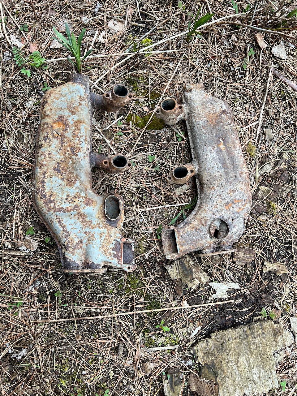

PostPosted: Sun May 12, 2024 9:30 pm    Post subject: Re: Heat Exchangers - Rebuilt but unhappy Reply with quote
I've also been working on replacing the heat exchangers for my 73 bus - luckily, I've found a person an hour from me that has a boat load of original VW parts (including at least 20 type IV engine cases, with tons of accompanying engine parts) - but I digress. In the stash, I found a very solid set of heat exchangers as seen here:
I've been working on them for a while and just sand blasted them yesterday in prep for painting as seen here:
BUT - I saw the post by Orwell84 with the heat components painted gray - (including the heat riser pipes, heater valves, etc:
Is this how these parts would have come from the factory in terms of paint color? I've never seen heat riser pipes and heater valves painted gray.
Thanks.

PostPosted: Mon May 13, 2024 3:32 am    Post subject: Re: Heat Exchangers - Rebuilt but unhappy Reply with quote
A more matte dull grey than that. Looking good.

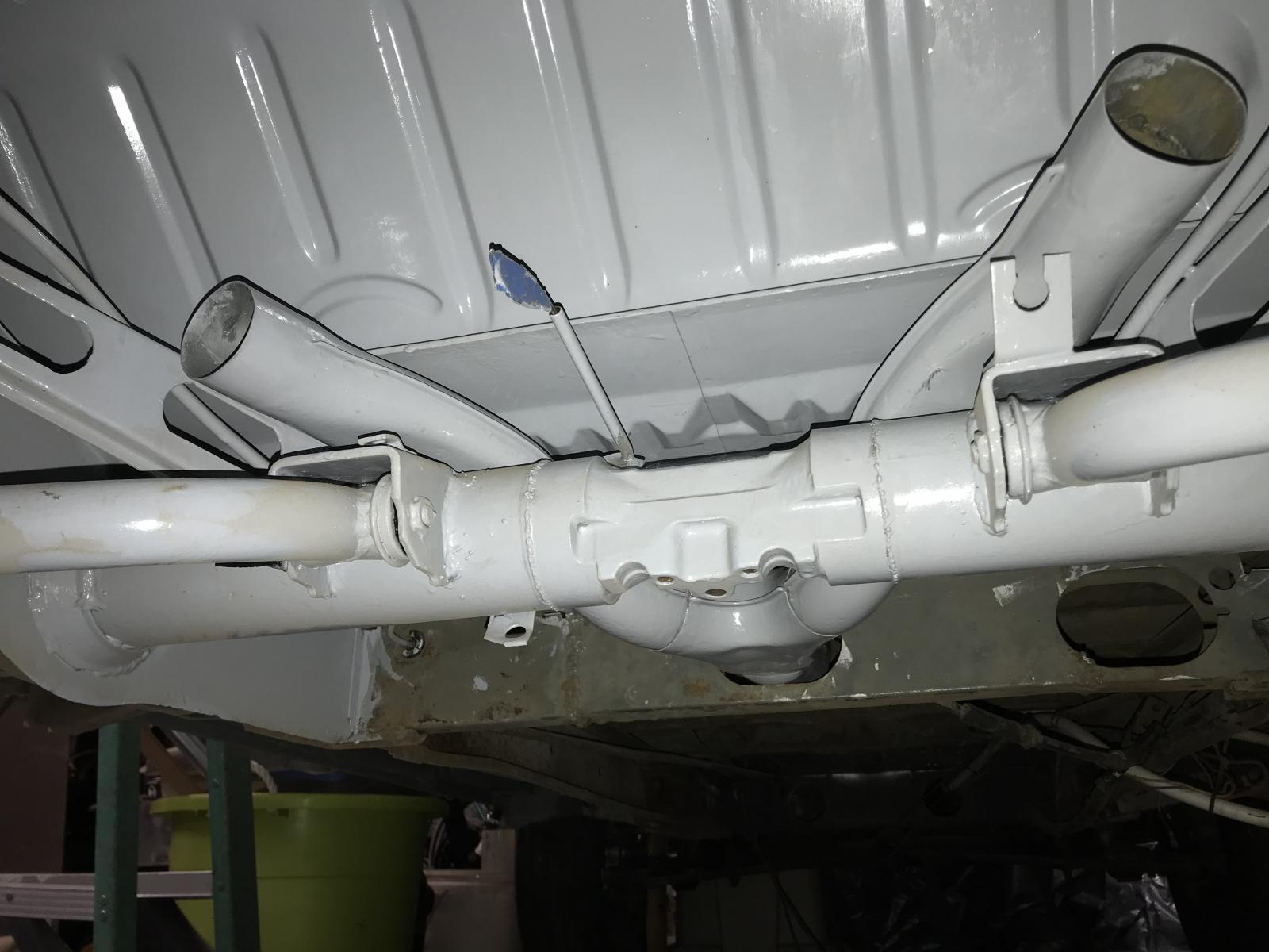

PostPosted: Mon May 13, 2024 9:35 am    Post subject: Re: Heat Exchangers - Rebuilt but unhappy Reply with quote
Heat risers and flapper valves are usually a satin black. The shiny light gray is my preferred color for everything around the engine. Makes everything easier to see.

PostPosted: Tue May 14, 2024 8:08 pm    Post subject: Re: Heat Exchangers - Rebuilt but unhappy Reply with quote
Whaanga wrote:
...I've been working on them for a while and just sand blasted them yesterday in prep for painting as seen here:
Props to you for doing a thorough job - I don't know if that's the final state before paint, or if you were going to do more prep -? There is still quite a lot of rust left; if you're going for a thorough job, you really want to get every bit of rust blasted out of the craters. It comes back, even under epoxy, if you don't completely eliminate it.
Another good option would be a phosphoric acid wipe down - depending upon your primer choice, that is.

PostPosted: Wed May 15, 2024 5:48 am    Post subject: Re: Heat Exchangers - Rebuilt but unhappy Reply with quote
Thank you - yes, there is still more work to do. I have a container of phosphoric acid ready to go.

PostPosted: Thu May 16, 2024 3:30 am    Post subject: Re: Heat Exchangers - Rebuilt but unhappy Reply with quote
Gloves and goggles with that stuff. Goggles, not glasses.
