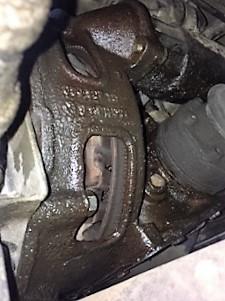

You can see the ducts and how the ATF would blow around out back of the bell housing in this photo:
If it is the TC seal..inspect/measure that bronze TC bushing and running surface for the TC seal carefully. Use two seals, side by side with a liberal dose of Vaseline around and between the seals when going back together.
