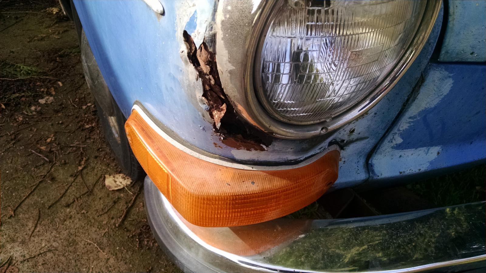

Heya everyone! This is Blue, my "running" 1972 Square. He's got quite a few problems, rust, and is generally a pain. He leaks into the passenger's floor when it rains, his fender is rusty, and boatloads of problems I'll list below. But he's mine and I love him.
I'm still really quite new to automotive mechanics and wanted to start with a bug, which I did but he's a pretty big project to do alone in the rain. So I went a little smaller for something that drives, stops, and wasn't awful on the pocket.
I bought him around November and December, and it's been raining and snowing since. Thanks, Oregon.
Issues!
- Rain leaks to the front passenger floor, and into driver's side door map pocket.
- Badly rusted rear passenger floor.

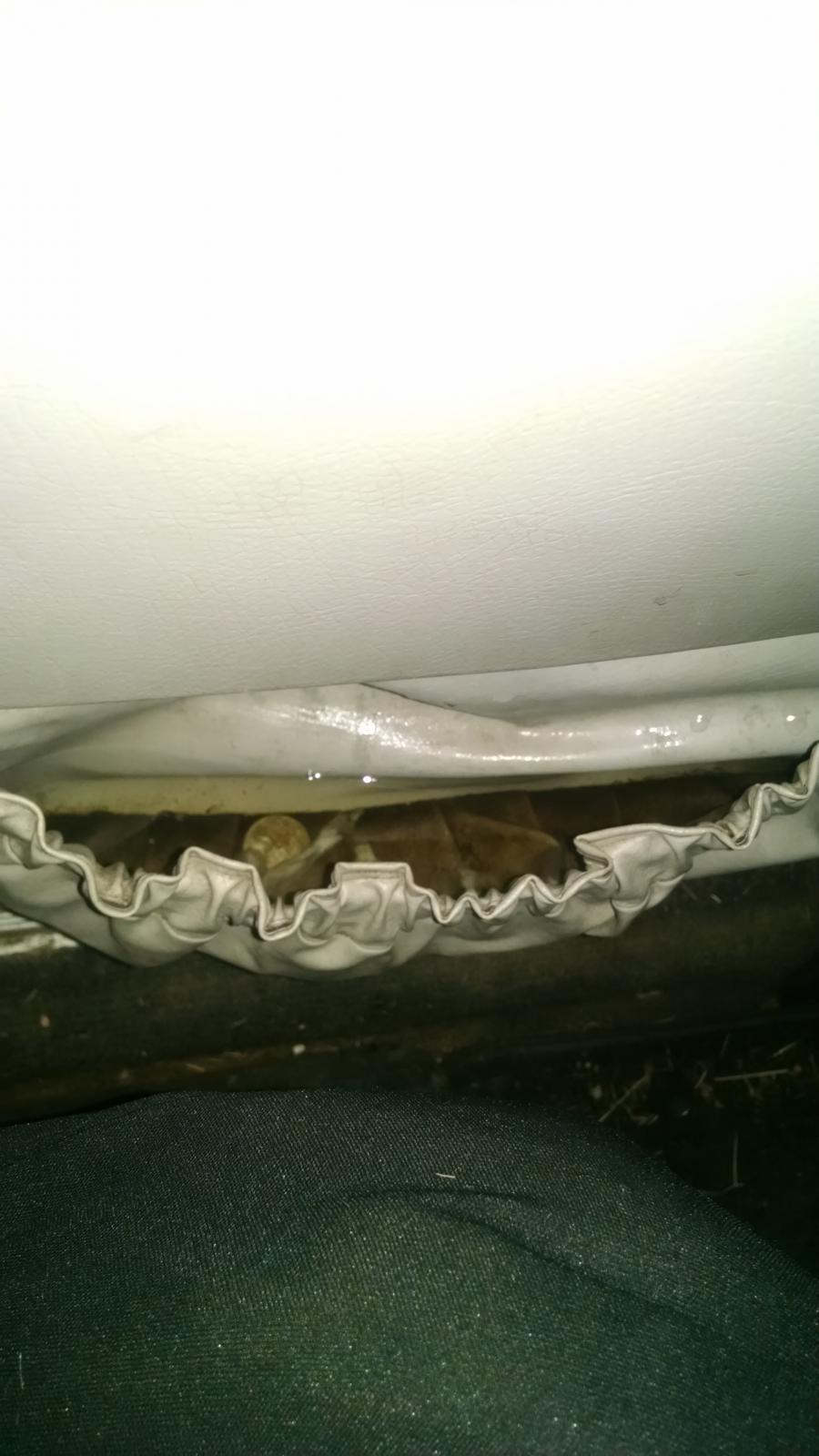

- Seats are torn to shreds.
- Leaks oil a bit worse than "marking his territory."
- Brakes ran out of fluid, now needs bled.

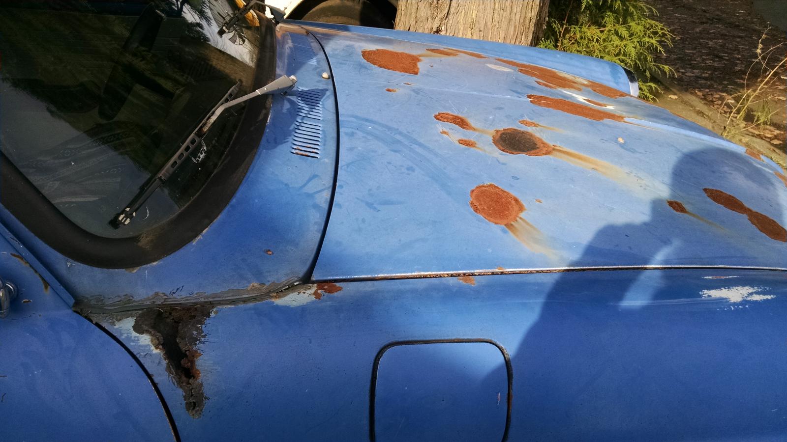

- Rusty hood.

- Rusted fender.

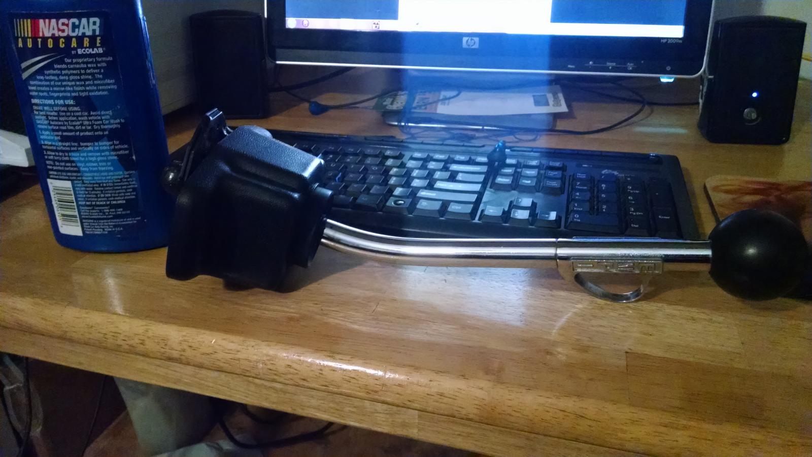

He's come with an Empi trigger shifter, dual Weber carb, some other Empi thing which I have no idea what it is, antenna, at least ONE decent seat, what seems like brand new back seat, Empi window cranks, racing roller pedal, eyebrows, and a cooler.

*EMPI shifter -> DONE

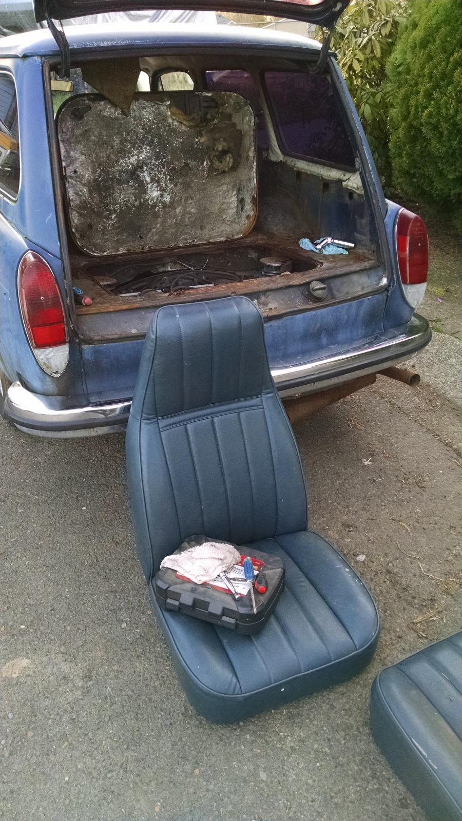

*Front passenger seat
*Rear seat

Mike, swapping out a 72 column for a 70 column is a lot harder than you think. First is all of the wiring changes that need to happen (72 uses a combo wiper and turn signal switch), including the fact that 72's don't use a wire for the horn down the steering shaft to the steering box.
I'm pretty good with doing changes (pretty decent with electrical too), and it's one I don't think I'd attempt. But then you live semi nearby, maybe you can give him some first hand help on the swap. Flat out it's a bunch of work. Ask yóur buddy George (Tram), and I can tell you what he'd say (leave it alone if it's working, and only fix what's not). And this is especially true if you're a novice to type 3s, or wiring, as they have some particular parts that aren't used in all VWs. OP, this is just a heads up.
Yeah, I had went out and worked and looked around and it looked like far too much for me. I'll just stick with finding the 71 wheel and throwing it on there after I get the wiper switch cut down. I'll be visiting Mike one day soon when I've got the money for parts I don't have, like the wheel.
