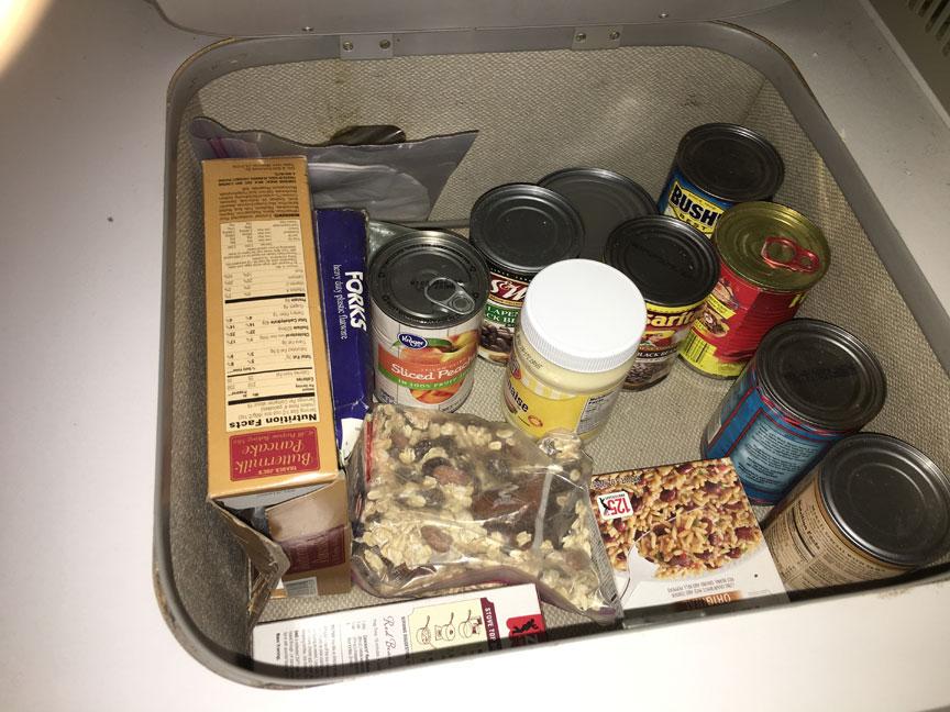

Mice in Vanagons is a HUGE problem. It can really wreck your van. Not like fire, but its a big problem. And it's fixable.
Once you get your unwelcome guests to depart.... then plug the known holes to mouse-proof your van. I park mine next to a mousey garden shack, for weeks, months immobile and the mice don't get in.
Heres a pic of my pantry, This prime mouse-chow has been there since the last trip in Nov 2016 and there is no evidence of mice in my van, no poop, no chewed ziploc bags. I often leave my slider door open (for days). While I agree a mouse CAN get in an open slider door, they don't jump into MY van.
Its certainly feasible to conclude the slider door is vulnerable on your van (in addition to all the other known entry points which are pluggable BTW) , but mine has stood the test of time, for years.
You can see that I'm pre-loading this post, steeling against inevitable derailment by the folks who will claim mouse-proofing a Vanagon can't be done. There are HUNDREDS of posts on theSamba telling you to just give up, and accept the mice. TheSamba is kinda like Fox News in that regard (where entertainment becomes real then shapes society).
If you've ever owned another vehicle that did NOT have mouse problems, thass what we're talkin' about. Do THAT. It can be done.
Good luck with the cleanup Dlosey.

It can't be done. In your original picture there were two bags of mouse chew, They carried the other one off.
